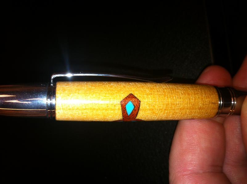

Been using the Stick Fast CA finish since it it came out with great results. However, the last 3 pens i made the past couple weeks have had issues. The finish goes on and polishs great. over the next couple days it looks like broken glass. Still smooth and shiny just the broken glass look. Im using the Stick Fast accelerator. Any Ideas?

This particular pen was a inlay kit. I turned and sanded as normal. Wiped clean with a dry towel and CA finished. The other two pens were amboyna and curly maple. Clear sunny days and warm in the shop. To me, its either something I'm doing or maybe bad ca. Could it be a heat issue when buffing??
Not the best photo, but it shows the cracks.

I had 3 pens like that also. They had been turned for a few weeks and as I was going through the inventory to pull out a sold pen I noticed one like what you have. I checked further and found 2 more. I dissassembled the pens and re-sanded and re-finished them. I had no further problems and I am also not sure why I got the cracked finish. The CA I used was not old, Stick Fast Brand, and I have not had another ones crack since. I wait 24 hours after CA application to sand and buff the finish.

It looks to me like the wood expanded for some reason and the CA, being brittle, cracked in response.
