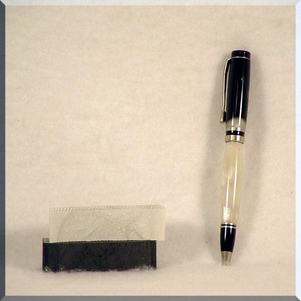

Well, I've been busy the last 2- 3 weeks playing around making and cutting up molds into blanks. This is about one complete gallon of resin here that made all these blanks. Each one is roughly 34" x 3/4" x 2 7/8" long. I decided then best way to cut these was not length wise but width-wise, this yields about 7 blanks per mold.
I haven't counted all the blanks I got from that gallon but its a lot! plenty to last quite a while (maybe 50- 70 blanks?). My wife has gotten into this as well making her own funky designs trying to layer different colors in one mold. I'm including a pic of the pen I made using her layered blanks, purple-gold fusion. Over all, making these are a lot of fun, turning pens (roughing down) however kinda feels like sandblasting yourself:).
I've about finished a Classic American using white pearl laminated with black/white pearl together. I hope it turns out pretty sharp.
One thing I'd like to mentioned about drilling these blanks out. I use my lathe, putting the blank in a 4 jaw chuck and drill slowly thru the blank. I've found I really like the precision of the lathe for boring, drilling etc, but these blanks seem to have a tendency to blow-out the end if I don't go "real slow" at the end and keep the flutes cleared often.
I've had this happen twice but I'm more careful now that I know better.

That pen looks super. I love the coloring. I've never drilled on the lathe, but I have had blowouts on the drill press. I usually cut the blanks a weeee bit over sized, so that when the drill bit exits, any chipping will be sanded away in the squaring process.
Hope this helps.

Now that's some good info you fella's have shared!! It appears I've been going about that step backwards. Hasn't occured to me to cut them a little long, blow them out (if they want to) then sand off the blow out...great!!! I'll be doing that from now on [:D].
This pen is only, I think, my 5th one. I love the sanding and buffing part of making resin pens. I sand down to 600 grit with wet/dry papper then, start wet sanding making a slurry with each pad of MM down to 12000, then buff with the Beall system. Love the final luster of these pens.
I've got another gallon of resin left to go but I think when all these blanks and other gallon is gone I'm gonna try some of those Lucite blanks from pipemakers.org, that is simply stunning material!
I need to focus on making peppermills but I tell you, making pens are really addictive. Got to get my next one done tomorrow.

So instead, I'm showing off my latest Classic American with a black/white pearl lamination. Should have used a darker background to show off the pearl more, but I'll get better at this stuff[:D].

I REALLY like that! Having the transition occur in the top blank REALLY gives it a cool look. Fit and finish look pretty good, too! Now we'll just have to work on the color of the pic; it looks a little brown over all to me.

Sam, thank you sir. Yes, I like it too, but no, it's a lamination. Probably won't get another to come out like it for nothing but I sure like to try. I got some more ideas in the works...I love laminating!
