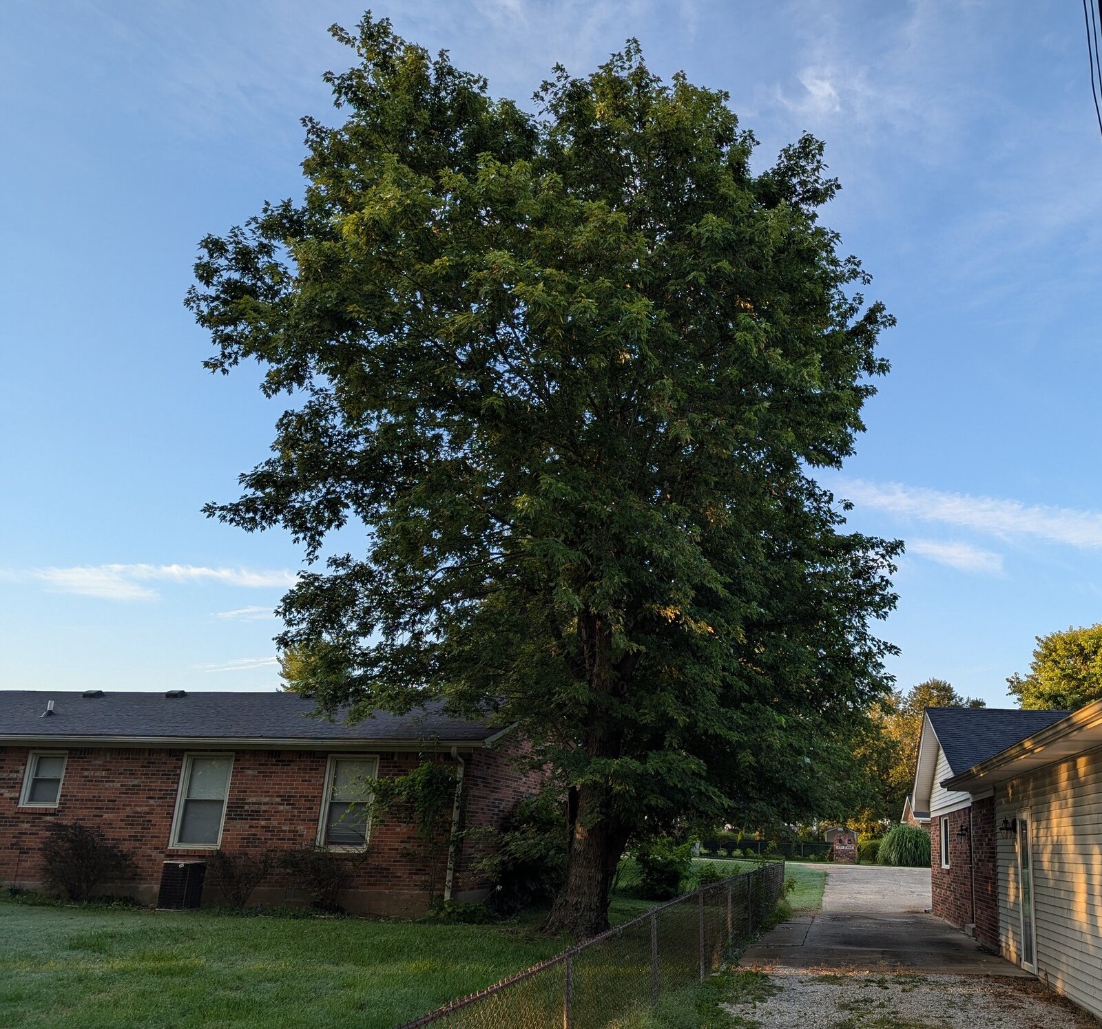

New Bowl Timber Coming
Mortalis
Aug 19, 2013
1,222
Bardstown, Ky
My neighbor is having a 30' ish Silver Maple taken down today. He has graciously agreed to allow me to have some logs. I've never turned Silver Maple. Hopefully like all other Maples it will have some grain patterns in the logs. I instructed the Tree Removal team that I would like several logs from 10" to 24" diameter and length a bit longer than the diameter.

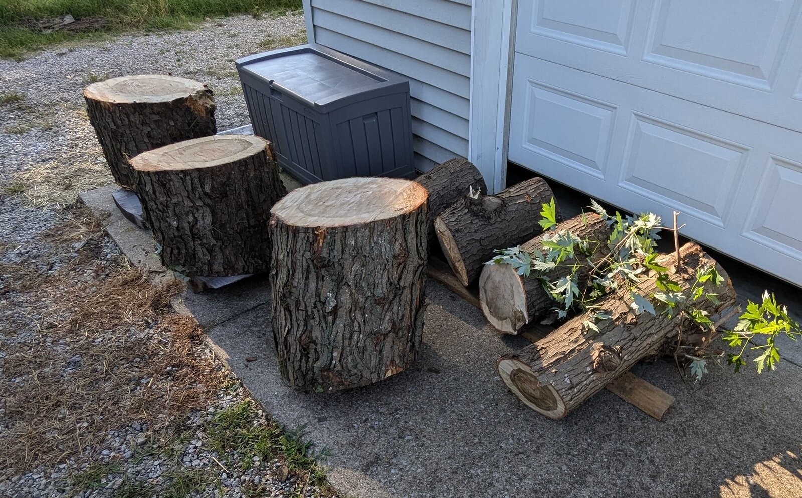

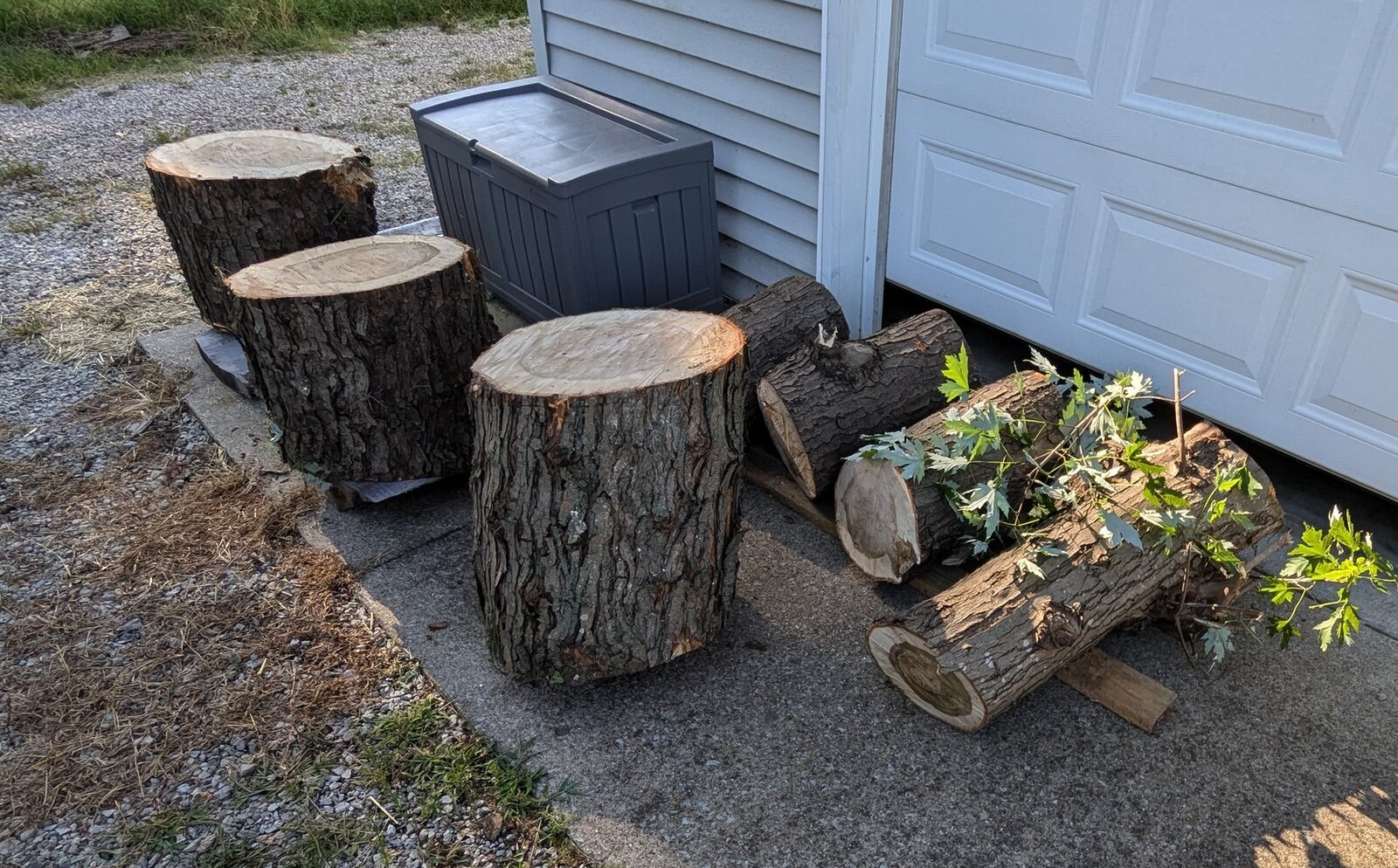

Here is what I received from the downing of the Silver Maple.
My space is limited and I have quite a few pieces of timber from past removals so I kept the request fairly small.
1st picture is of the lot I received.

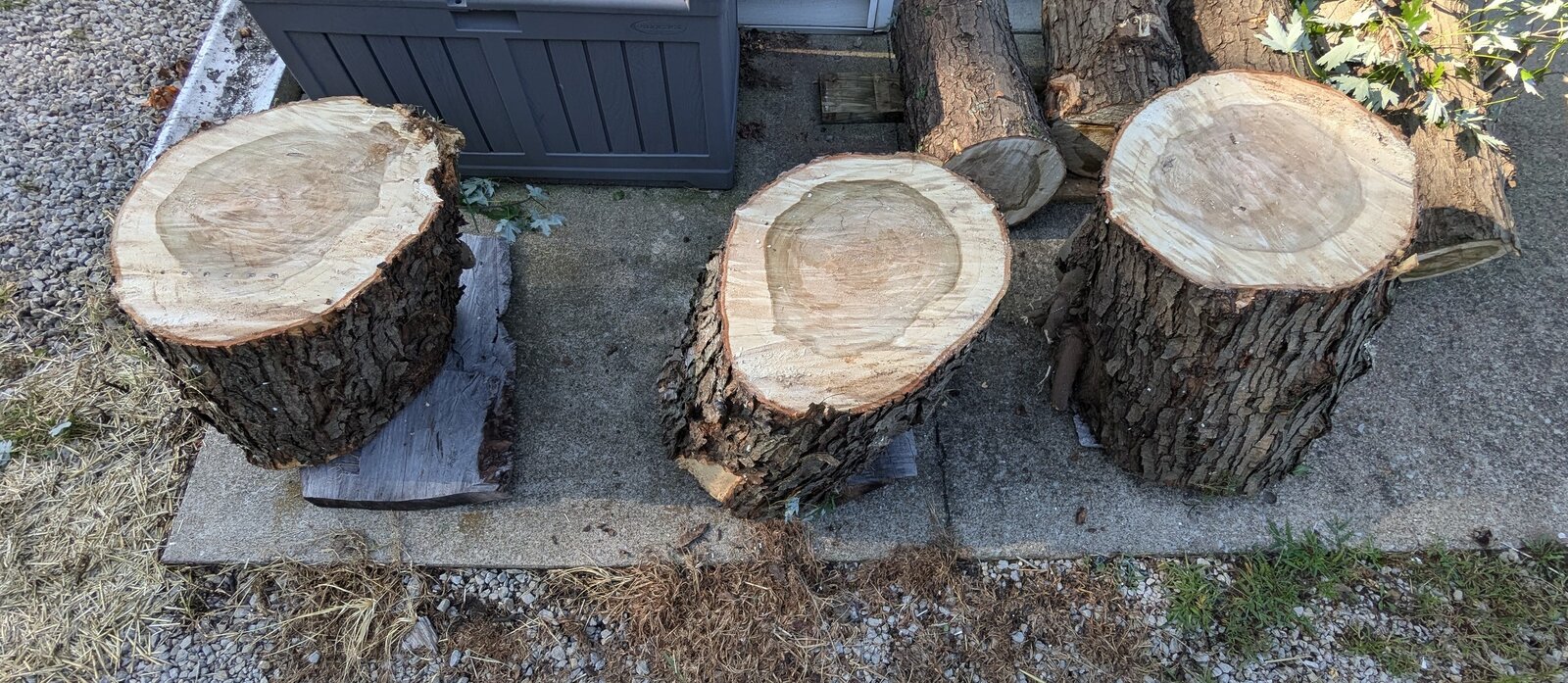

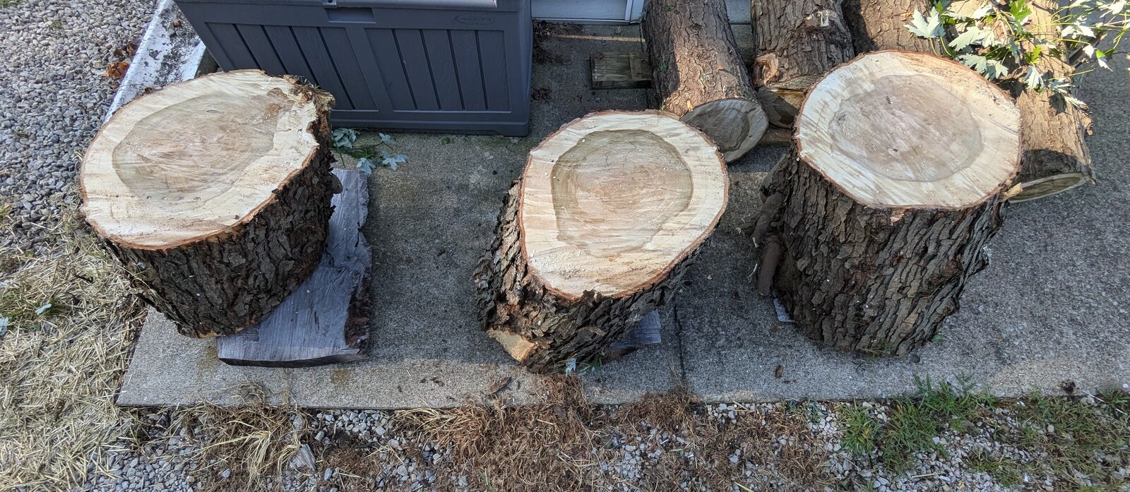

2nd picture are the three I requested that are 20' to 24" in diameter

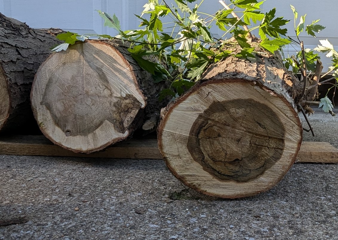

3rd picture is what I can only imagine will the prizes of the lot.
