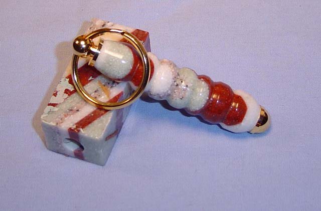

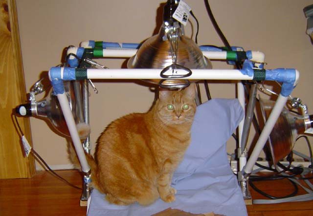

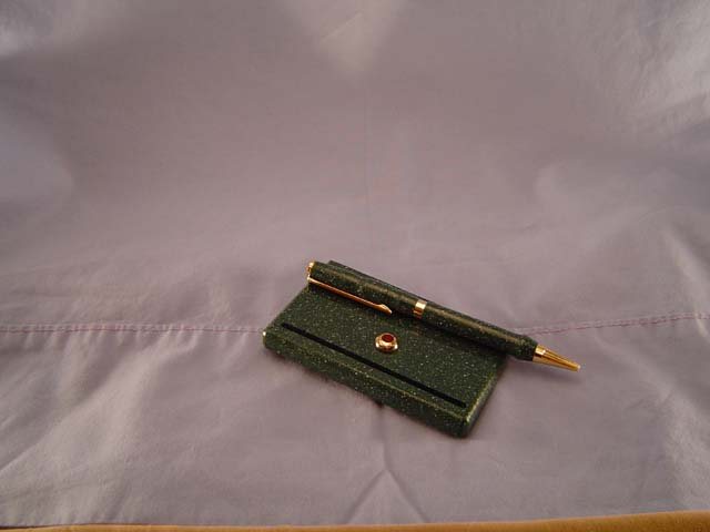

second when i am able to use it, unless i use flash i get a yellow tone to pictures. I tried with and without covering with white cloth, adjusted the lights all over the place. The bulbs im using are "natural light" Its not a big problem but if theres an easy fix that would be great.
The key ring is with flash
Third pic is an example
thanks.....pete

Natural light bulbs that you buy at the local Borg are not photo daylight bulbs.. they still are on the warm side of natural. This is why you are getting warm photos... you can try to adjust the light balance on your digital camera until you find the right setting...
Another fix would be to go to a good camera store and get some good photo lights that are properly color corrected... tell them what you are doing and bring a pic of your setup so they can really help..

BTW what camera do you have? On my new Canon Rebel XT 360D if shot in raw mode and you have something white in the picture you can click on that and it will automaticly ajust to the color balance. If you have a dSLR you might have something like that in the software that comes with the camera.

You should still be able to adjust the white balance in the camera, even with a relatively small camera.
You said the bulbs were "natural light" but you didn't say what kind they are. GE advertises the Reveal bulbs as providing "natural light" but, in fact, the color temperature is almost the same as photo floods, 3200K. You need bulbs that are 5500K if you really can't adjust the white balance.

Here's my two cents. Based on my ebay readings, make sure your backdrop and base are white. For light, if you can get natural light from a north facing window, use that.
Then there's always the bright/contrast on your photo editing software.
