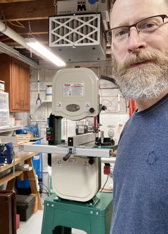

Just received a new Grizzly 0555LX bandsaw on Friday and have it set up and dialed in. I replaced the feet it came with for locking castor wheels so I can move it around my shop. This was the third shipping of it after the first two arrived damaged. I was about to put in a 'cheers and jeers' on it, but the third try they boxed it in a full wood crate and it showed up in mint condition.
I'm looking forward to taking a dive into the IAP Resources on segmenting with my new toy. Advice, safety tips, and suggested first projects are welcome!!

Greetings from Nebraska - and congratulations on your new acquisition. I have had the the Shop Fox version of that model for a few years already and I really like it. That sucker is really heavy!!!
The dust collection on mine is somewhat marginal, except for removing the very fine particles, but I think that is typical for most band saws. There is just too much going on with the bearings and guides to fit really good extraction shrouds on them. I recently replaced the bearings and did a meticulous alignment on them. That and a new blade and it is just like brand new. I have a really good set of new blue urethane tires for it but I haven't put them on yet, the orange factory tires are still performing well. (I also have a second set of bearings for it for the next time I think it needs a good tune up).
So far I have been using Starrett 1/2-inch, 4TPI, Skip Tooth blades and I really like them. I initially had a 3/8-inch blade, but with the type of sawing I do I like the rigidity of the 1/2-inch better. I also have a new Timber Wolf brand 1/2-inch, 4TPI, Positive Claw blade, but I haven't used it yet to do a comparison. Considering the satisfaction I have had so far I will probably stick with Starrett.
The other thing I highly recommend is a set of the blue zero clearance inserts from Rockler, #21958, indicated for Jet. They are 2-1/2 inches OAD x 1-3/4 inches to the lip on the under side. I find them to be far superior to the aluminum ones that came with my saw, especially because I do some segmenting and the zero clearance keeps thin slices from falling through the slot as they did with the factory inserts.

Alex Snodgrass has some very good training sessions that are available on YouTube for setup and tuning.
I bought a used 14" delta that is similar and tuned it up. I upgraded to a link style drive belt which was inexpensive but was a nice little upgrade. Next I'm looking at a quick release for the tensioner, then riser block or upgraded guides.
Spend some time on dust collection.
Get the right blade for the job.
Have fun.

Make yourself a fixed 90* sled that fits in the guide tracks. Make it with a nice substantial backing board to cut partly into then you know exactly where a square cross cut is going to exit.
