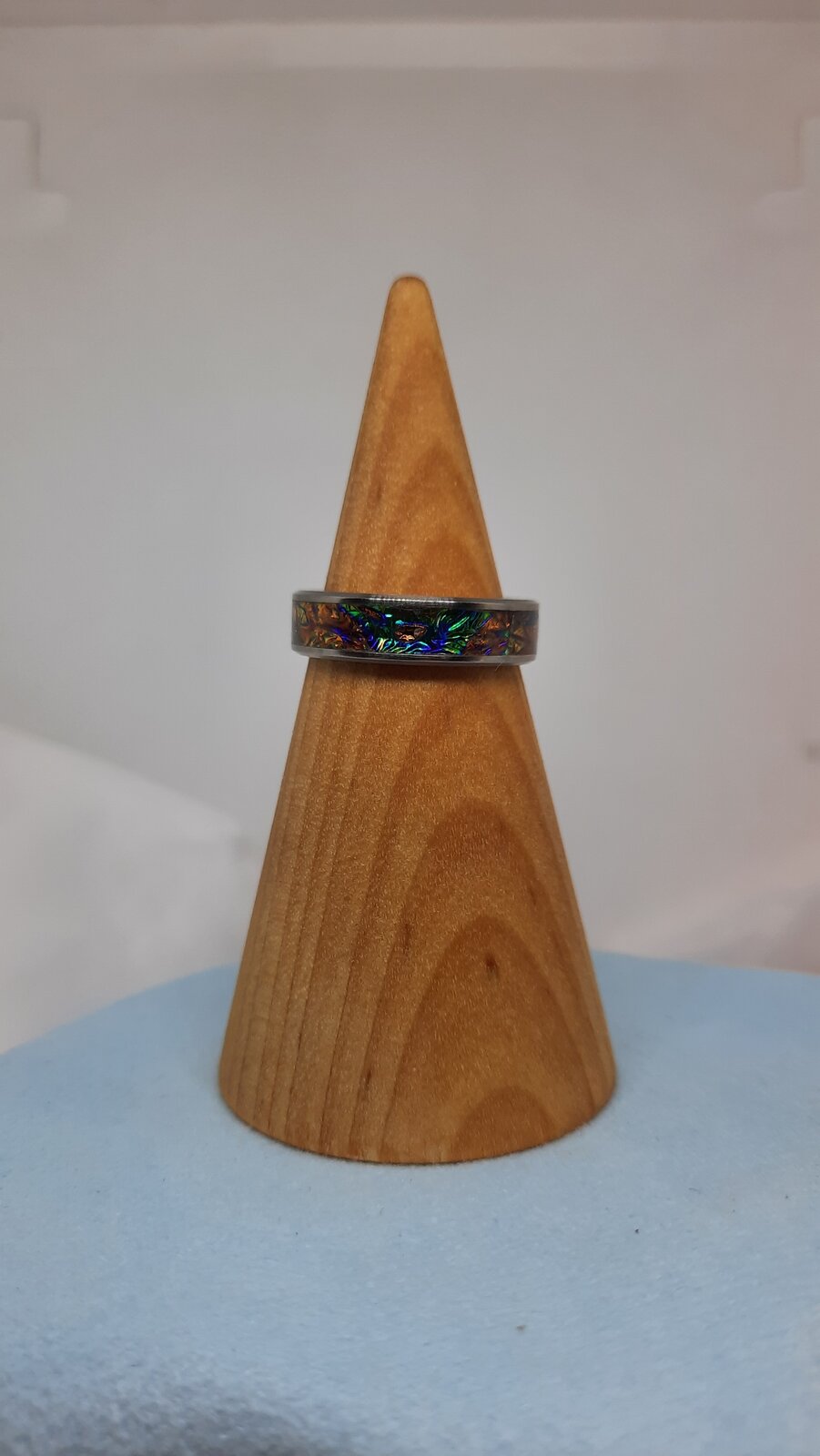

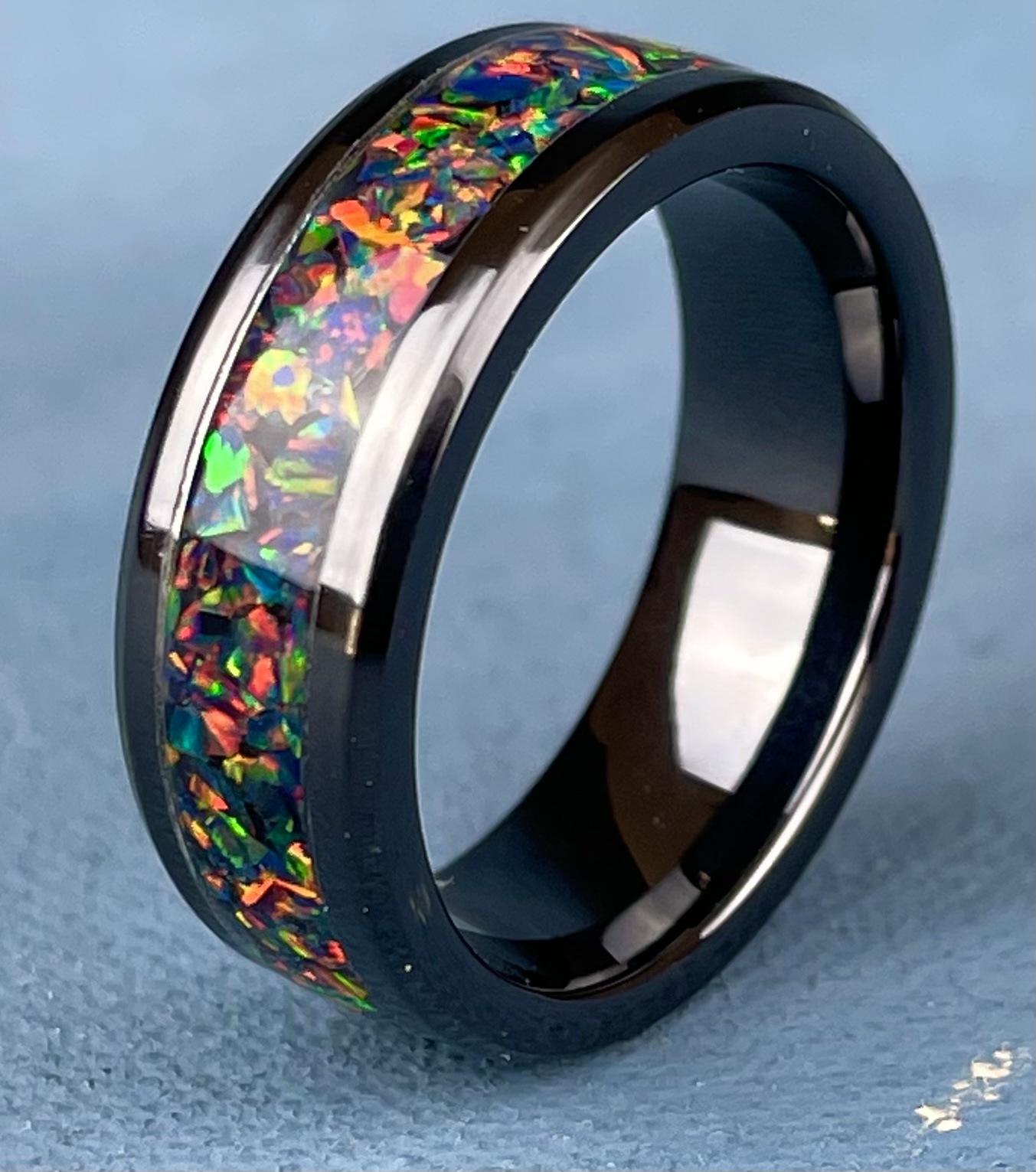

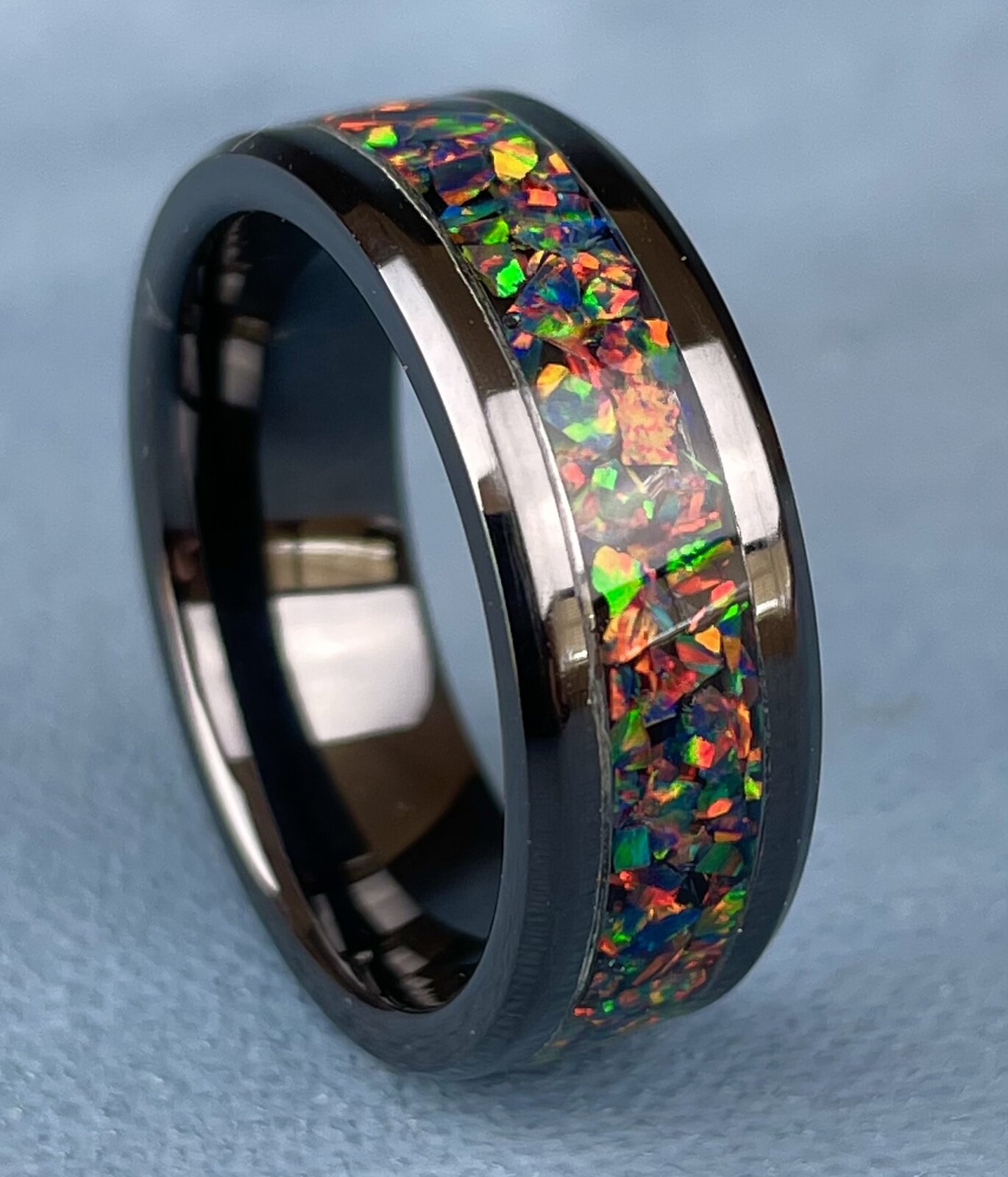

The ring is black ceramic and the crystals are new to me. I'll make a set - 7,8,9,10,11 and 12.
My rings have sold well with over 15 sold so far. I charge $65 each for opalescent rings in either titanium, tungsten or ceramic.

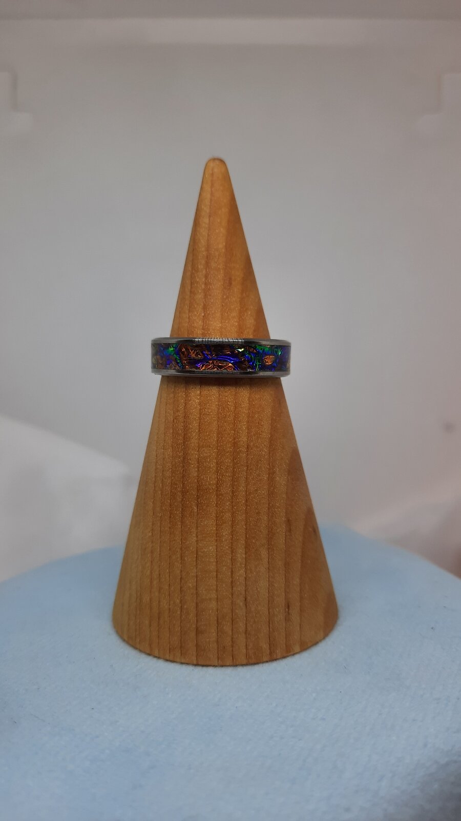

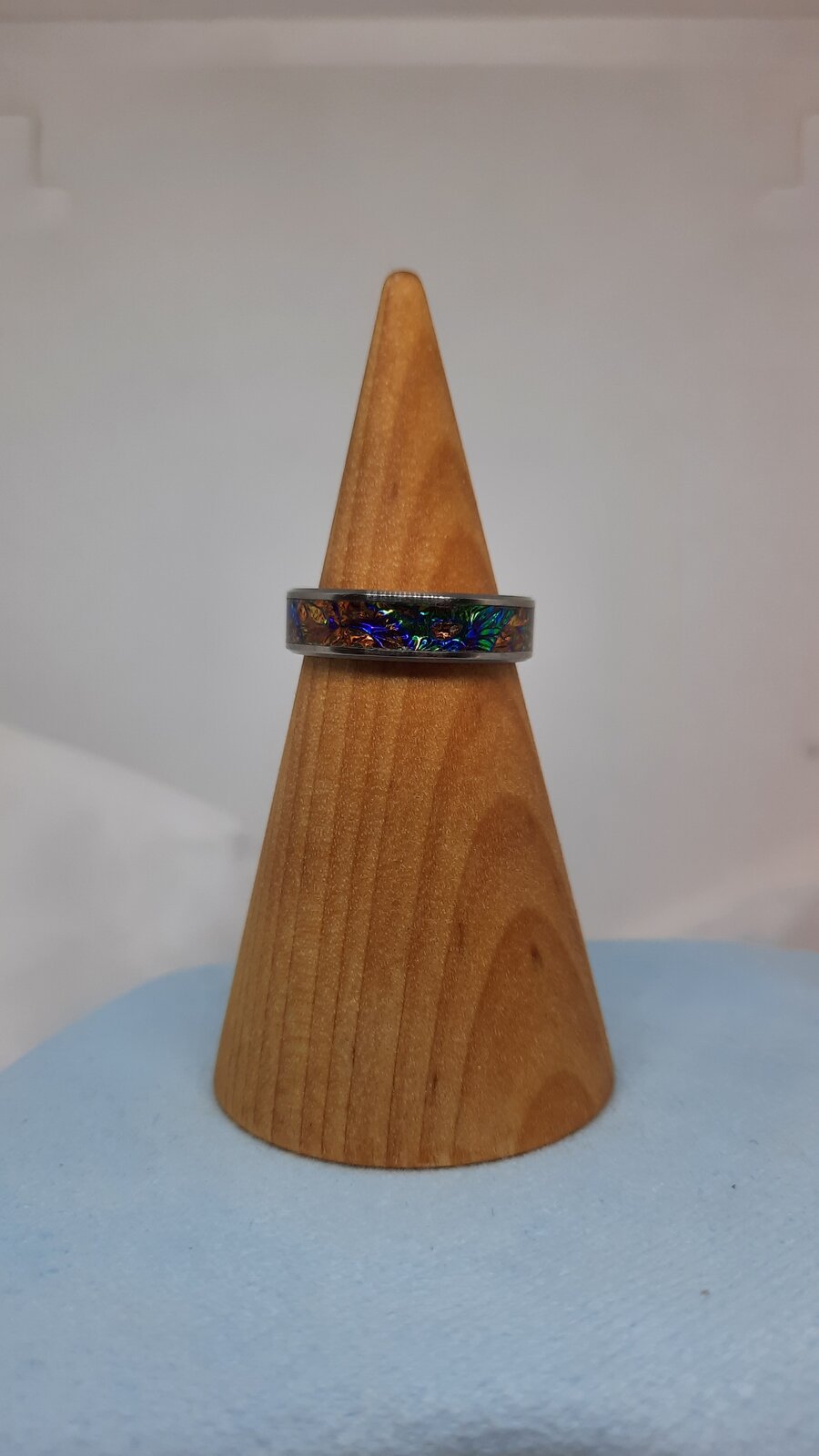

After viewing the photos I sanded and polished the ring again. Color me happier. Five siblings size 7-12 are now completed and will be on display later today.

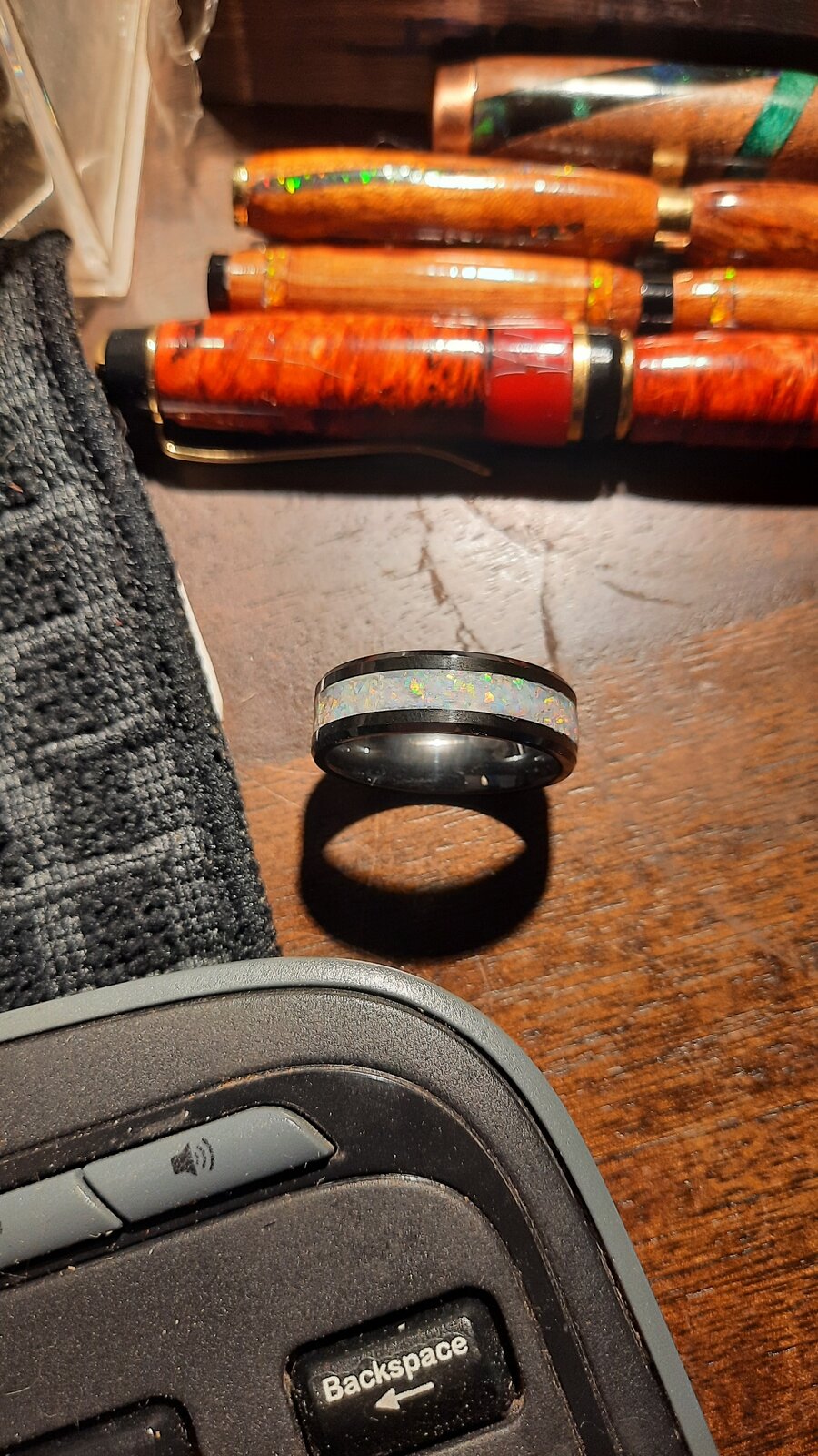

I love making rings. The Black Ceramic ring is with Fire and Ice Opal. Love it!~
