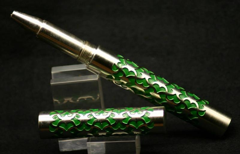

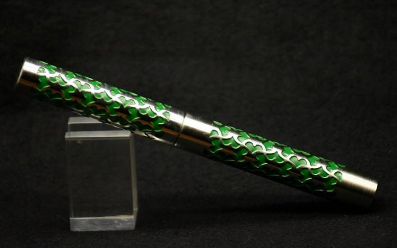

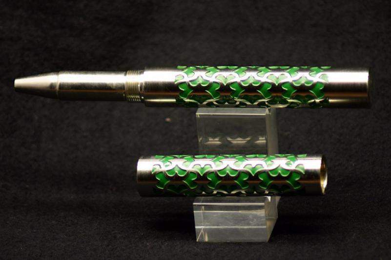

Etched & chromed with a seamless pattern encompassing the body and lid.
Background filled with Signal green acrylic enamel
Thanks for looking

Brad, you really, really, really need to send one of your artworks off to the PMG. You'll be only the second Brit to get accepted !!
However, if I may be a little critical, then I think your nib kinda let's it down just a bit. A similar etching on the nib would help grip and add to the overall design. But that's just me...:wink:
agreed Steve. I had these designs cut a long time ago, just only this weekend had the time to make them. at the time, I wasn't ready to start designing nib etchings, though no doubt will for future pens. one step at a time and all that ;) Still learning my techniques with this!
I wasn't going to say anything beyond the "like" because there wasn't anything I could add to the sentiments expressed. Then it hit me! In the pictures the green almost glows. How neat it would be if it could be done with a glow in the dark paint. :wink:
Thanks for that. Just given me an idea ; )
replica chrome is bright nickel Jim. a good polish would have it shining better though as I'm not happy with the nib design overall I've not bothered.
chances are il make a new nib for this pen over the next few days when I have some time spare
