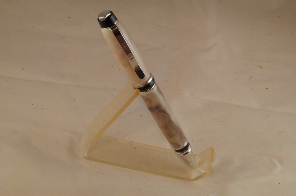

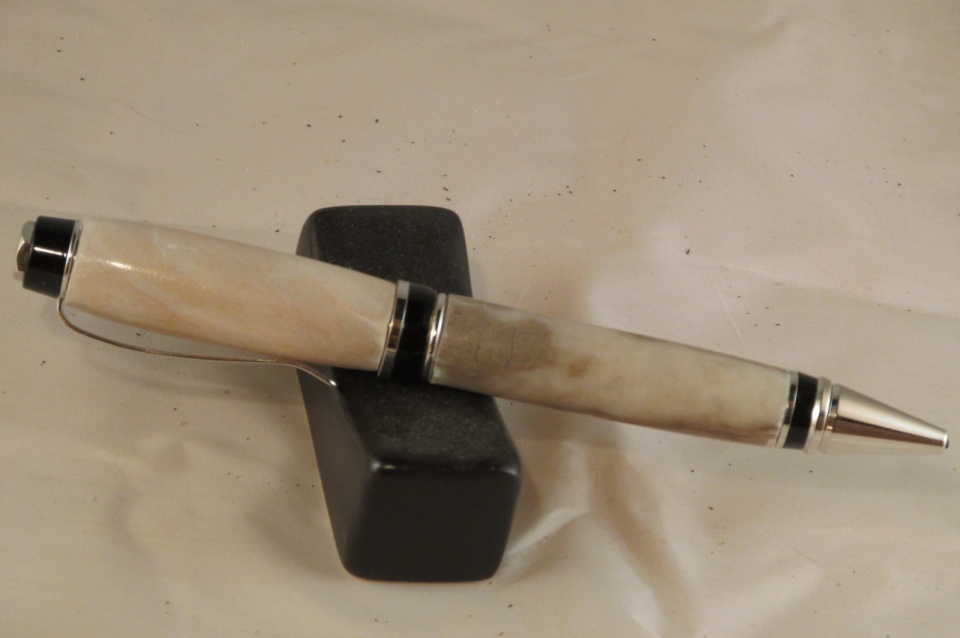

will I ever make another pen out of Alabaster Stone. This one is my 4th try and a keeper. The other three cracked or blew out, and what a mess to turn. Wet sanded from 600 to 2500 for that great glass like finish. Pen is a Big Ben twist in Chrome. As always all comments are welcome and thanks for looking.

white/cream with chocolate/brown marbled in .... very very nice! :)
