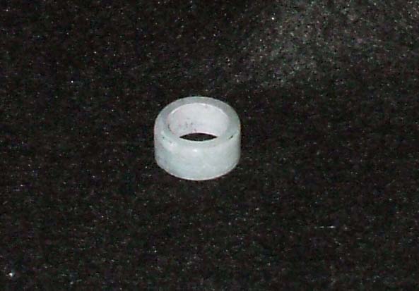

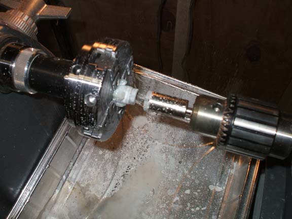

Tried this many years ago. You really need some good diamond drill bits and plenty of lubrication/cooling while drilling. Also wore out many tools in an attempt to turn. Even tried grinding. Best I got was with coring drill bits. I got some relatively inexpensive ones on ebay from China but they didn't last long. Did get one centerband complete, but process was too cumbersome for longer pieces for me. Still have some jade left, but never got back to it.
Also had to use diamond saw to part it.
