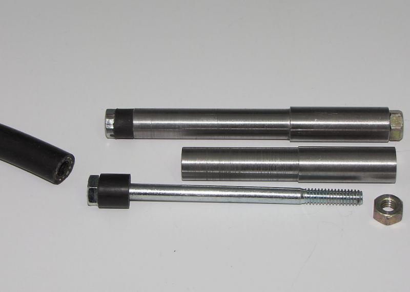

I am wanting to make some pin-chucks that I found some pictures of. They use some type of flexible tubing (either Neoprene or Tygon) that is squeezed together from the ends to expand and squeeze the tubing, securing the pen tube. Picture below.
I am looking for some tubing that just fits inside of the pen tubes we use. I will take anything I can find as this is a proof of concept for me to find out if I can make it work. I have tried larger tubing and turning it smaller and it just wont turn well so I need it correctly sized.

try looking for O'rings. they are available in almost limitless variety of sizes. seems to me 2 of those space out just a little would hold better and truer than 1 piece of rubber anyway.
just a thought.
Check your local RC hobby shop, nitro and or gas lines the fuel lines are one of the types of tubing that are very similar to the above they also have some that are more like silicon tubing, softer. Neoprene vacuum and fuel lines should be available at most auto repair shop Down to 1/16" ID.
Hope this helps

Thanks for the tip Charlie! I may give that a try!
