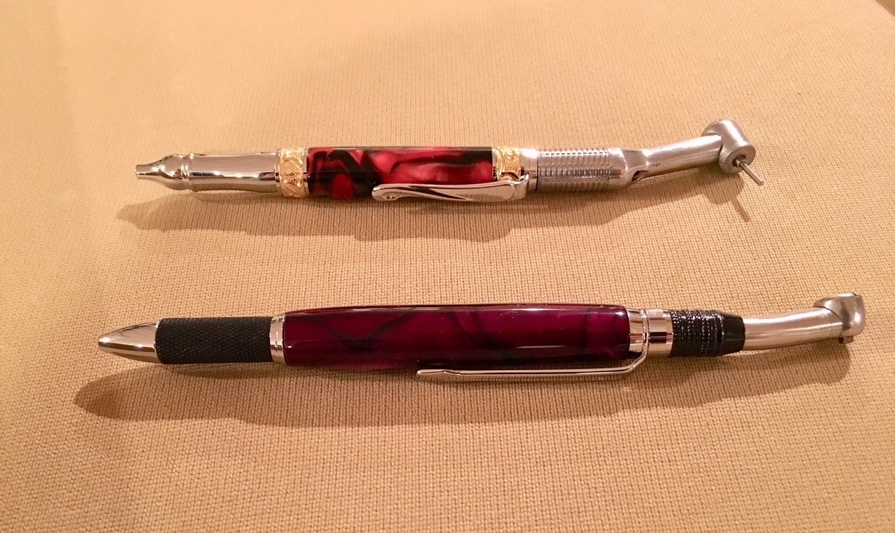

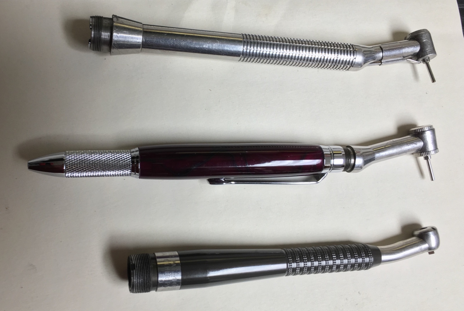

Hi Dr. Robert. I'm a retired self employed "ortho tech". Being at the lathe for a lifetime inspired pen turning. Love the smell of acrylic. I'm in Blue Bell during the Summer. My favorite pens made for my retired dentists' daughter that took over the practice. I loved this project. Welcome to IAP.

I LOVE the drill pen!!! Scary and beautiful all at the same time! Nice work!

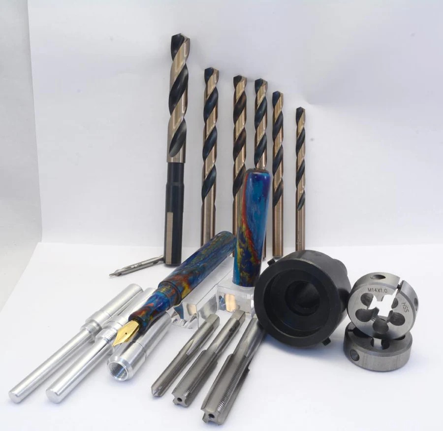

Hello,
I was initially hesitant to make sections and bought a few from Turners and Beufort. The game changers for me were a tenon cutter from Turners warehouse and stepped drill bits for Jowo and Bock #6 nibs. Using the tenon cutter and stepped drill bit has turned my reluctance to "sections are easy". You would need the special tap for each nib size too, but they are easy to find and relatively cheap.
Seriously, you will be amazed at easy sections are to make using a tenon cutter and stepped drill bit.
Agreed on the tenon cutter - which is actually designed by and made by Jim Hinze for Turners - so you can get them from either source. I personally prefer to drill in stages, not with the step drill, but both require good measurments to get things right. Next step savior (turning) is Rick's double ended section mandrel - which is made for use with his step drills. It also works with drilling your own holes, you just need to match Rick's dimensions.
Ricks's sliding Die and Tap holder is also quite amazing - allowing real accuracy with threading. I'm a big fan! You can buy it direct from Rick or it's now being sold through Turners Warehouse. If you don't have ER32 collets, you will need them with this holder.
