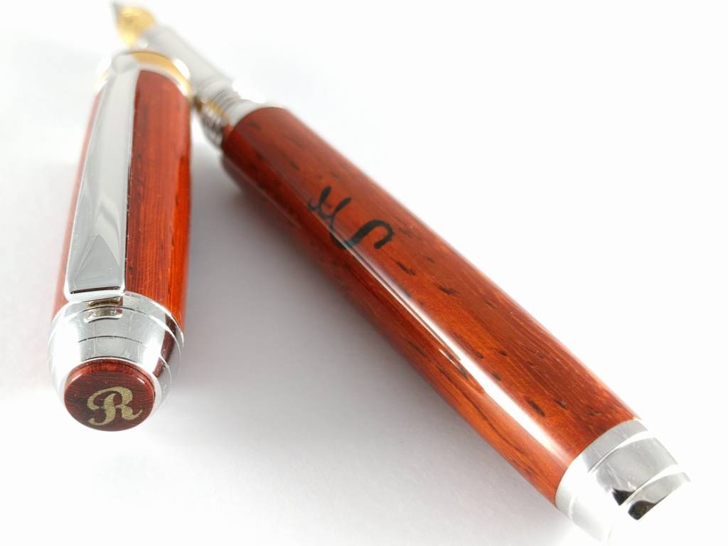

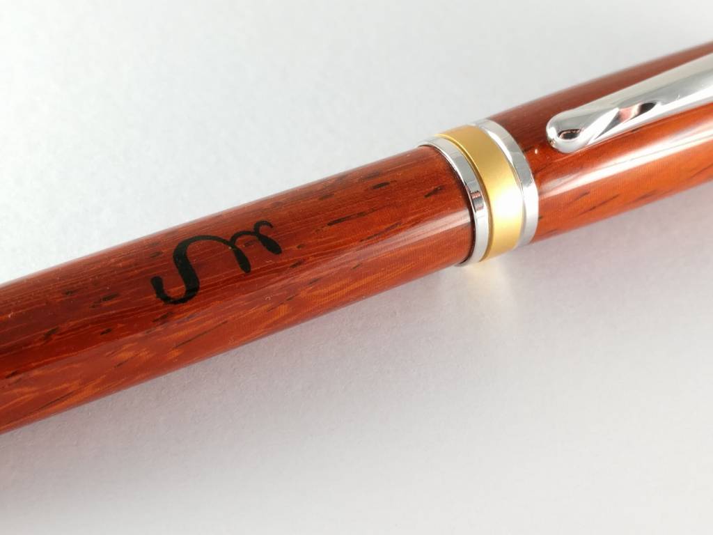

I've got the 1500mw, the symbol was engraved at 60 which needed bringing level with quite a lot of CA, so 40 would have been plenty adequate and the initial was 2 passes at 120 to get it plenty deep to take a decent depth of brass powder for inlay
Sent from my Nexus 6P using Tapatalk
So you are saying that you gave it 2 passes at 120 and then one at 60..?:eek:
Weren't it suppose to do it in one pass..?
George
No, the inlaid initial on the cap finial was 2 passes at 120 to get the depth, the symbol on the pen body was just one pass at 60

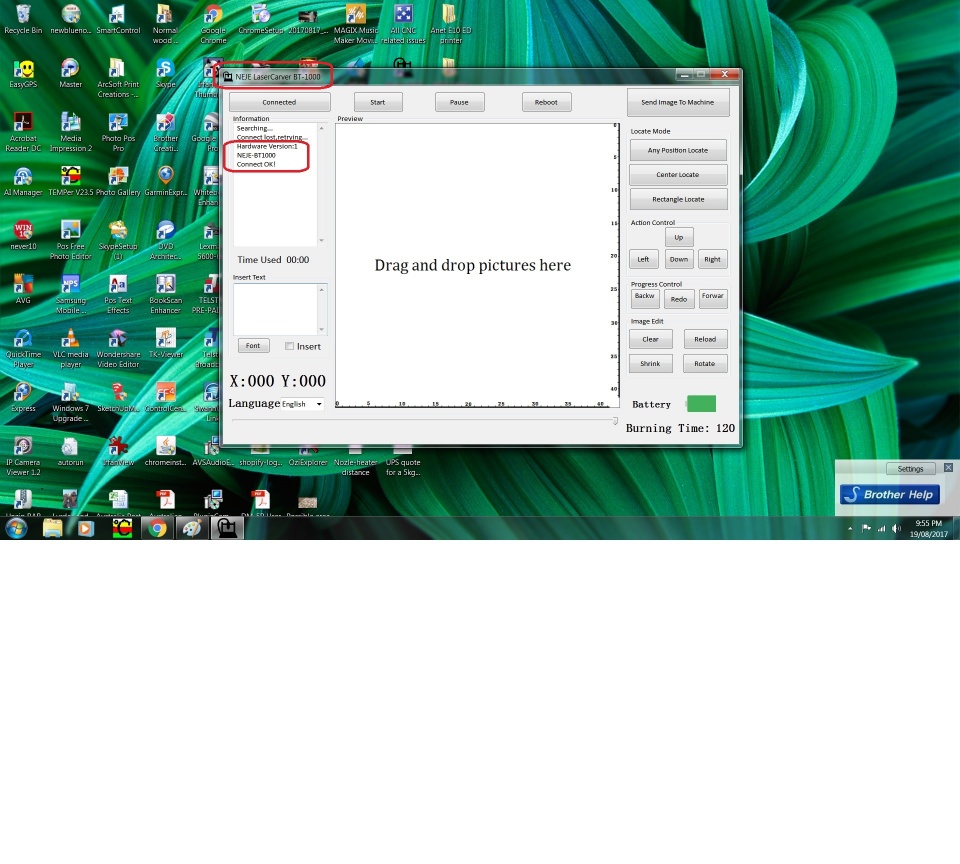

I did however just found something that I didn't noticed before and that was when I open the Neje program, I saw this
Could everyone that has this 1500W model verify if their Neje program says the same thing or it saw NEJE 1500W as it should say..?
The very reason I asked where I could verify the correct model of what I've got was due to the fact that I couldn't tell if I had the 1000W or even the 500W, the laser weakness was the trigger that I may not have received what I order/paid for.
Do you know if there are any visible characteristics that distinguish the various Neje models...?
I may be wrong but I reckon, someone is trying to rip me off...!:mad:

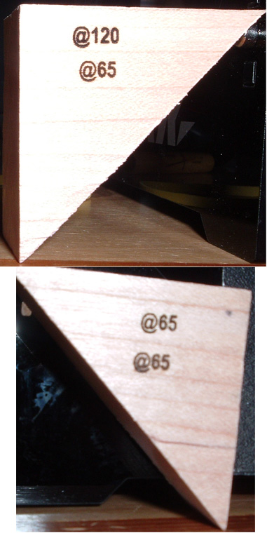

Well, I'd say you got a bad diode.
This is a piece of light colored cherry as I don't have any poplar.
The first one is 2 different power settings.
The second image is the same 65 setting but I turned the focus ring 1/2 turn in both directions.
BTW, my program says NEJE LaserCarver BT1000.
However, that is probably because I downloaded a program for it because I could not get the software CD program to load.
Hope this is of some help.
Mine says Neje BT1000
I assume the BT stands for Bluetooth which is the only one that has the 1500mw specification.

Yes it's ideal for pens. You wouldn't be able to get anything much larger in there anyway. You probably need the gantry type with a decent output that you can position over larger objects, then all the work is done from above.
Yeah, whatever I need as a laser cutter, it ain't this for sure, I will need to search a little more.
As for the issue with my laser weakness, I've got a response from the eBay seller today, they say that according to the manufacturer, the laser was not adjusted right, he asks me to follow the instruction correctly and then report for any changes...!:eek::biggrin:
Well, I did follow the instructions and I did rotate the laser adjustment all the way to each end and then return to the best focus point so, I don't know what else they want me to do.
Cheers
George
Cheers
George
I think they are jerking you around--obviously, the diode is bad. Other folks have had the same issue right out of the box. My diode lasted about six months, then I had to replace it. They need to replace the unit. If not, I think a PayPal dispute is warranted. When my diode went bad, the unit still appeared to function--sound and light looked good, it simply would not burn. A new diode from eBay resolved the issue. Good luck!
Regards,
Michael
PS: Even with the laser not properly focused, the unit should still burn--it just won't be as clear and precise. If it's not burning, the diode is bad.
I had to replace the laser in my 1500 also. George, the back comes off the unit easily. Why not just drill a bigger hole for your finger?
