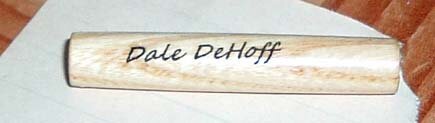

first real attempt
I had this unused blank laying around so I tried it in the laser.
No rotary fixture and I am still amazed at the outcome.
67 burn time BTW. Blank had several layers of CA on it.
I like this little machine!:smile-big:

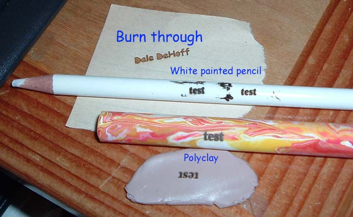

More tests
The brown paper went right through and etched into the platform.
The white pencil was done with the black marker on the left and without the marker on the right.
Without the marker it still burned in, even on the white paint. That surprised me.
The polyclay is uncured on the bottom and cured on the blank.
BTW, the uncured made a terrible stink!:eek:
