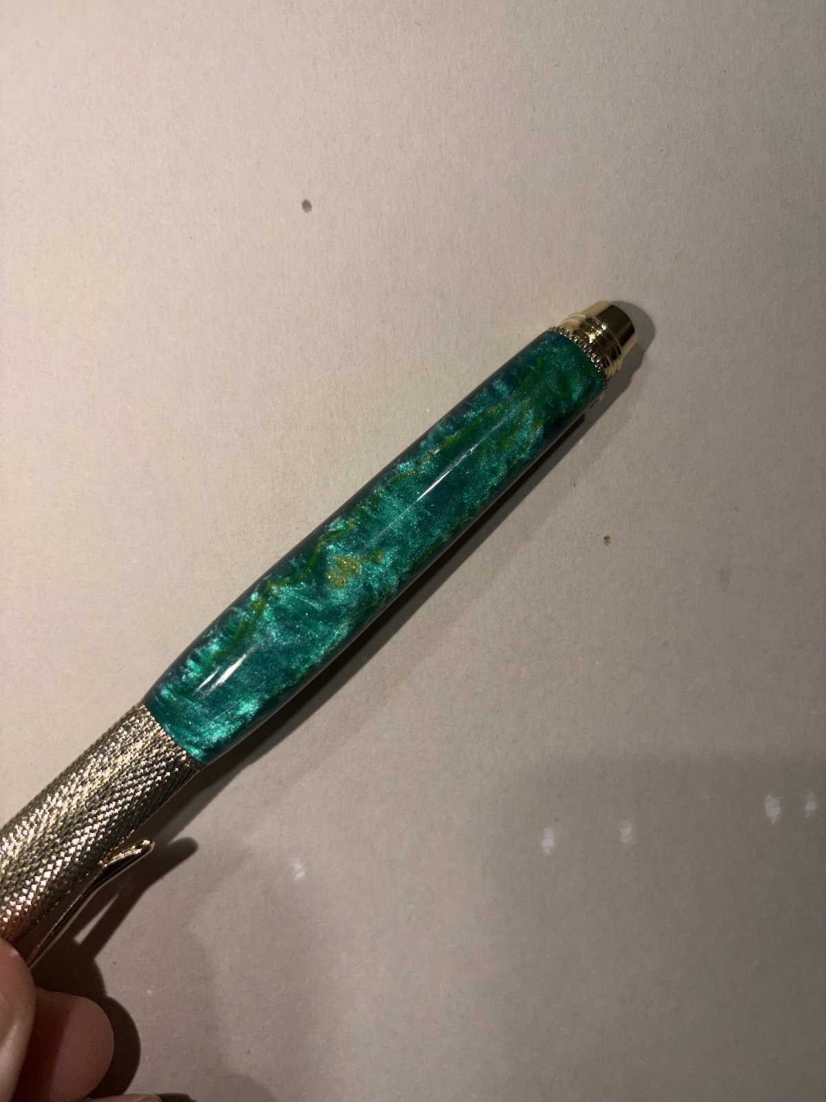

I turned my first acrylic the other day and had a hard time making smooth finishing passes with the tool. Using EasyWood tool on an Inlace Acrylester. It came out really nice but I had to sand starting at 180 to make it smooth.
Would a Negative Rake do me better? My 10 year old son wants to turn acrylic, so this is also a question for make things easier for him as well. Thanks
This is the finished piece. Other than a crack from a blowout while drilling it seems like it came out well. Any advice will greatly be appreciated.
