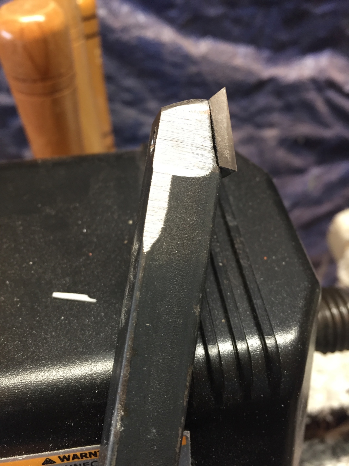

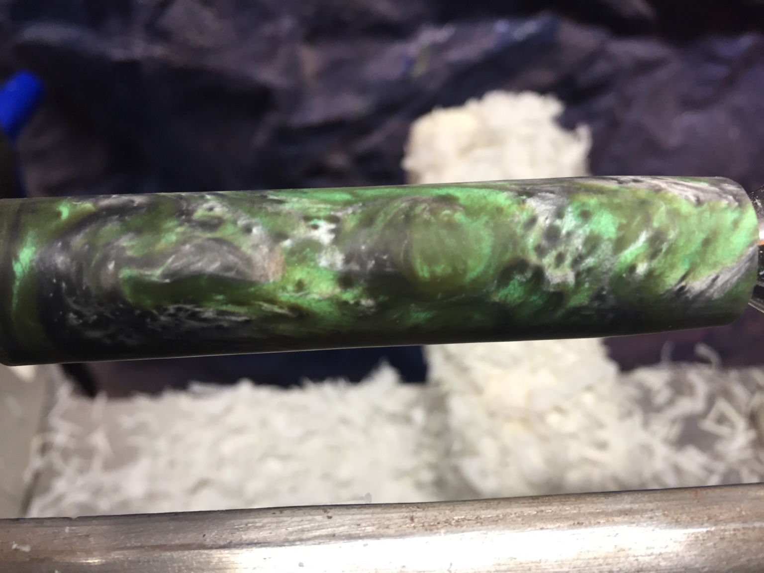

For much less $$ and the ability to sharpen, I made and use this.
As turned no sanding.
I mounted a standard cutter with a 20 degree negative rake ground into the holder made of 1/2" square bar.

i really like this idea as lately i've been turning acrylics on my metal lathe as much as possible getting them as thin and as flat as possible.
I turn most of mine on my metal lathe to about 0.100" larger than the bushings. I then hand turn the curved taper to the final dimensions at the ends of the blanks. My next mini project is to build a holder for the normal carbide wood turning insert to use on my metal lathe QCP.
Danny
ive been doing thin/straight sided pens like executives and zens.. i turn .005-.010 above bushings. then wet sand/micromesh and buff and they are perfect... turned some inlace acrylester from square down to round on my metal lathe and had NONE of the typical chipping either
