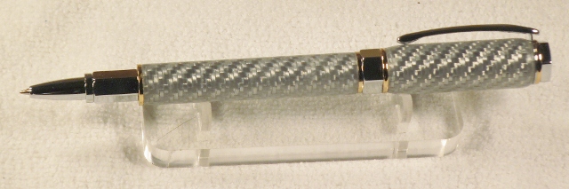

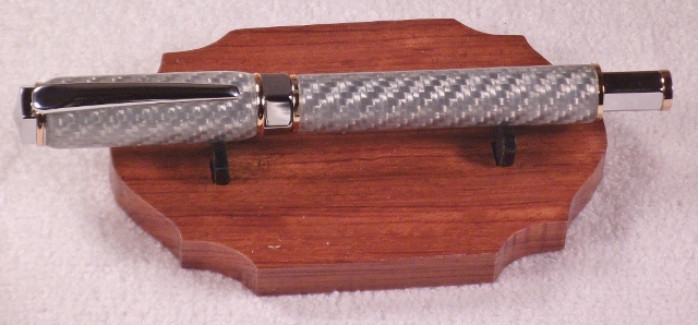

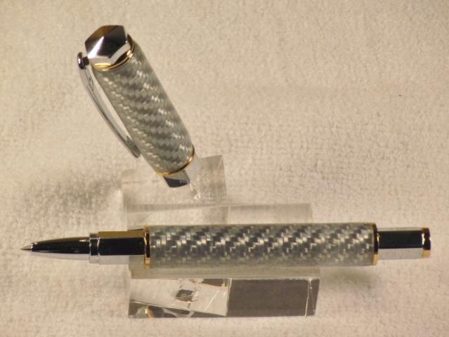

My new favorite pen is the PSI Vertex Supreme Magnetic Rollerball with the glass fiber blanks from Craft Supples USA. The blanks come with tubes already installed. No drilling, no casting, no cutting and no glueing. Just turn and polish. Jim S

I like the Vertex click. The hex head and tip look like a bolt so that is "manly". The pencil has a nice thick lead that does not break the way the slimline pencils do. If you are looking for a postable pen the Rhinehart is a good choice.
