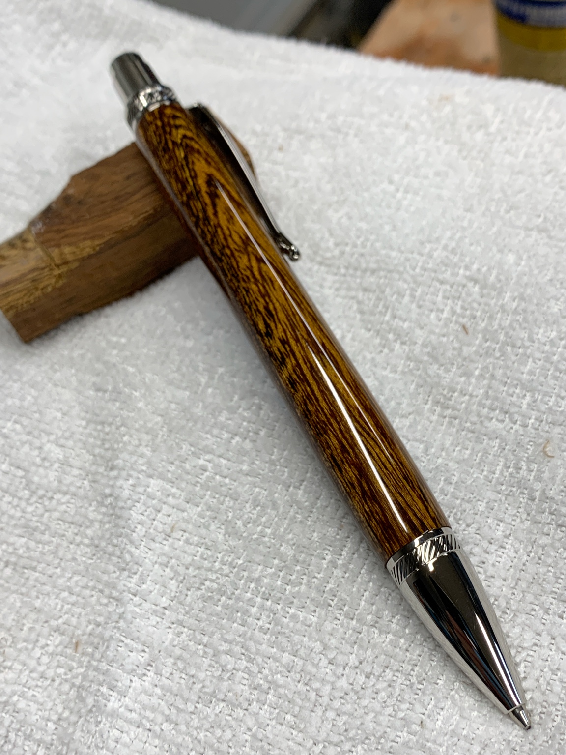

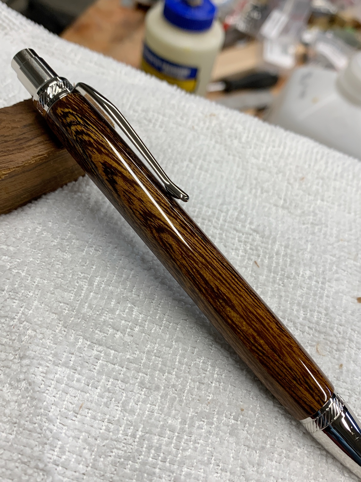

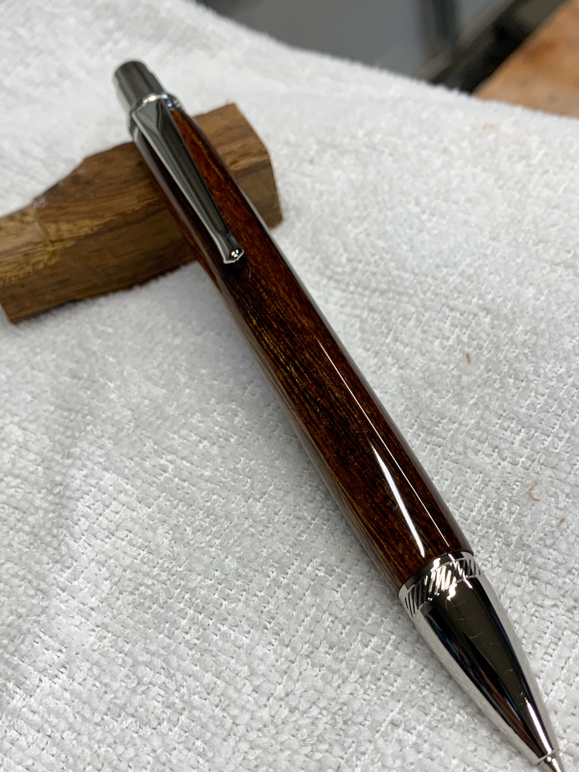

A friend at the hospital asked me for an Ironwood Click pen. I had one nickel click kit left!
I turned this blank differently because whatever I was doing seemed to end in disaster.
I used my calipers and got the ends close, but after putting the pen together, I feel I could've got it closer. Normally, I round the ends but I left them flat. Next pen I think I'll get them closer.

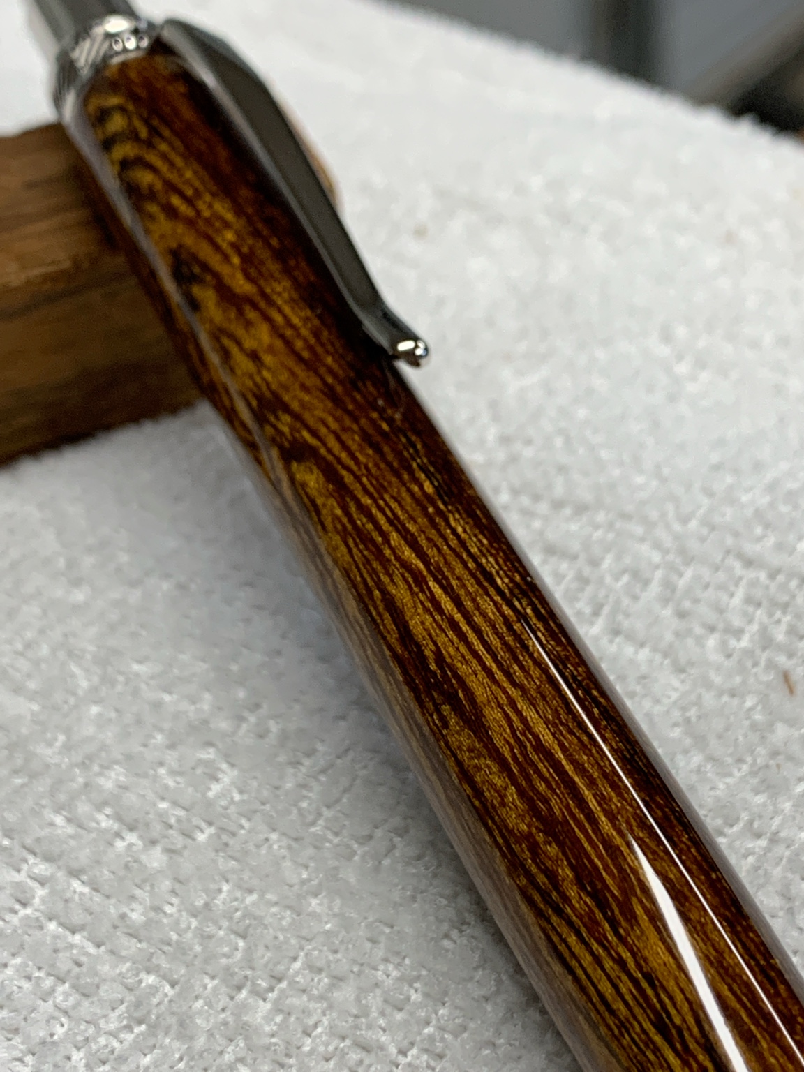

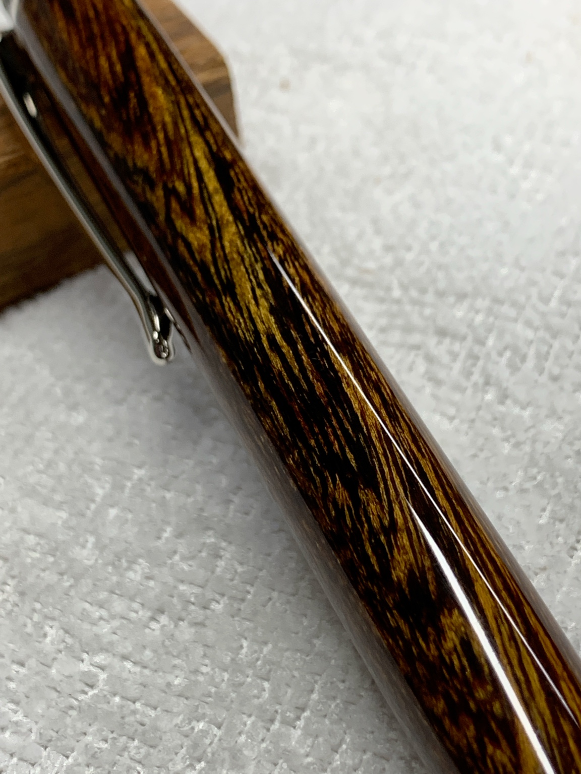

Okay, now the real difference was the sanding. After reading several posts, particularly @magpen, I decided to try the longitudinal sanding. This was challenging, but did give good results as I started to get the hang of it. I have found I'm a little heavy handed!!
However, I loved the outcome! I also found that I was spending less time sanding.
The finishing was a good coat of boiled linseed oil, thin CA, and another thin layer of CA. Several coats of medium CA later... sanded 400, 800,1500 and then One step plastic polish. I buffed it with a cotton buffing wheel, holding the wheel up to the lathe. (I didn't feel like switching it over)
So, this was my experience today. Thanks for looking!
