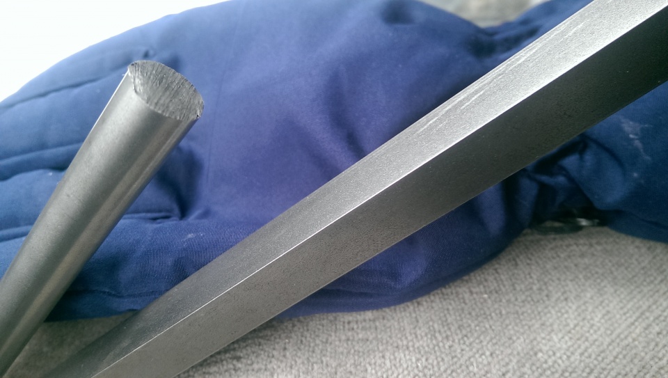

bought some steel
I went to the discount steel retail store and bought!

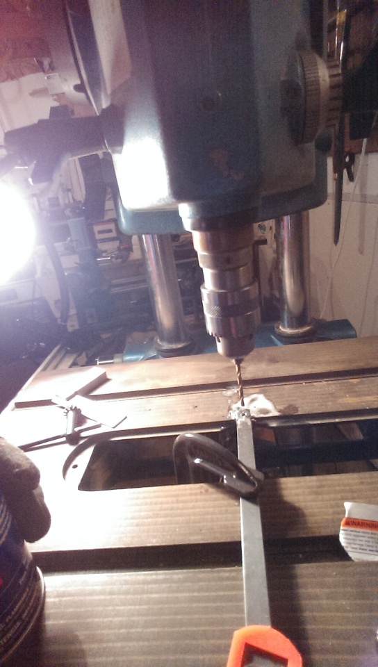

won't be able to actually try this until tomorrow probably. But when thinking about it what is the best way to clamp the round bar down so that it doesn't move on the drill press table? I will be using a Shopsmith for the drill press.
for 30 dollars there is a 60 piece tap and die set at menards that might work for me doing the threading.
IMO, the best thing to use when clamping a steel bar to a steel drill press table is a c-clamp. The main thing is to use something that won't get in your way (avoid long bar clamps), and something that will hold (avoid spring clamps). I use a drill press vise, but don't clamp it to the table - the weight is enough to keep it from moving around.

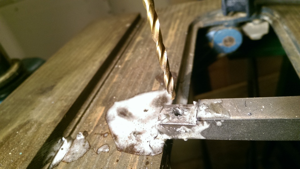

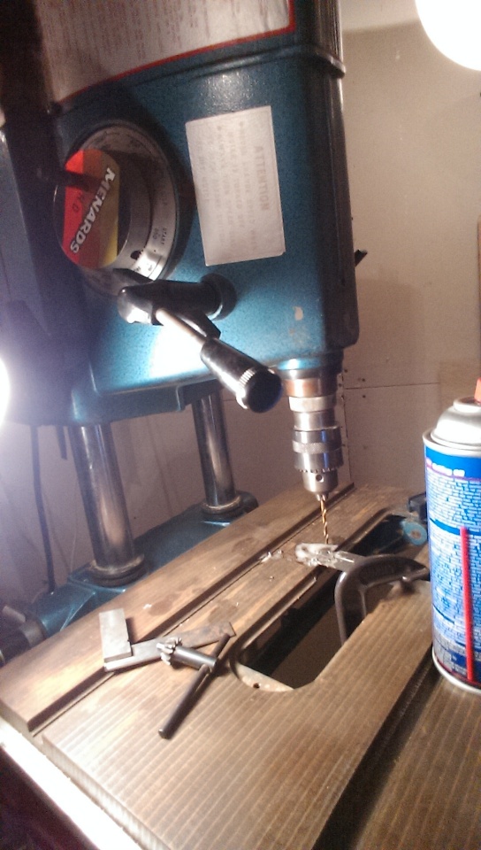

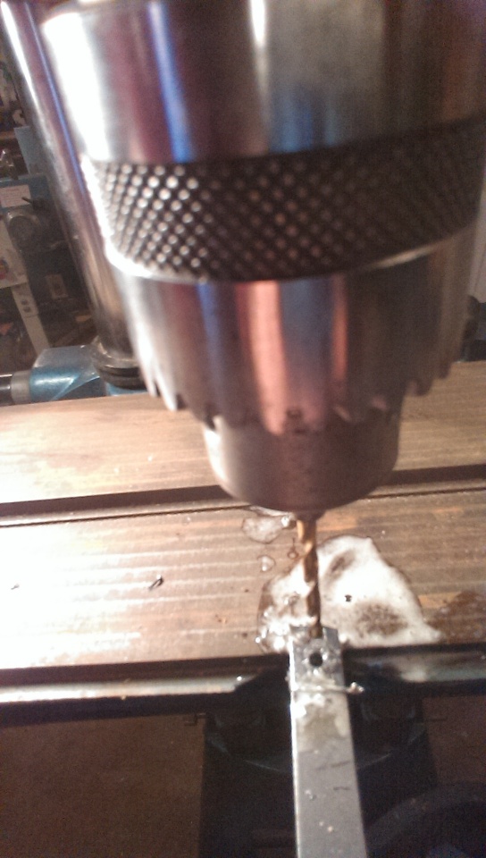

A little after midnight I decided to head to the shop to attempt to tap threads into my steel bar.
Total success. But I ended up just threading the entire thing by spinning back and forth the sanding wheel on the backside of the headstock of my Shopsmith, so that no thing moved and it kept it perfectly straight so I didn't have to use the small T handle tap wrench that I bought. I kept it lubed up really well with cutting oil like you guys advised. This weekend I will grind the rest of the steel bar to get it angled correctly and then I will turn ash handles.
