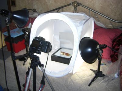

How do you set your lights up?? Are you using a photo tent??? Do yopu have the lights coming in on the sides, the front or from the top??? Thanks.

I know I've posted this before but I can't find the thread.
I have two lights coming in from the sides. these two provide overall lighting and shadow control. I also have one coming in from the front just above the camera. this third light produces the reflection that shows off the shine.
