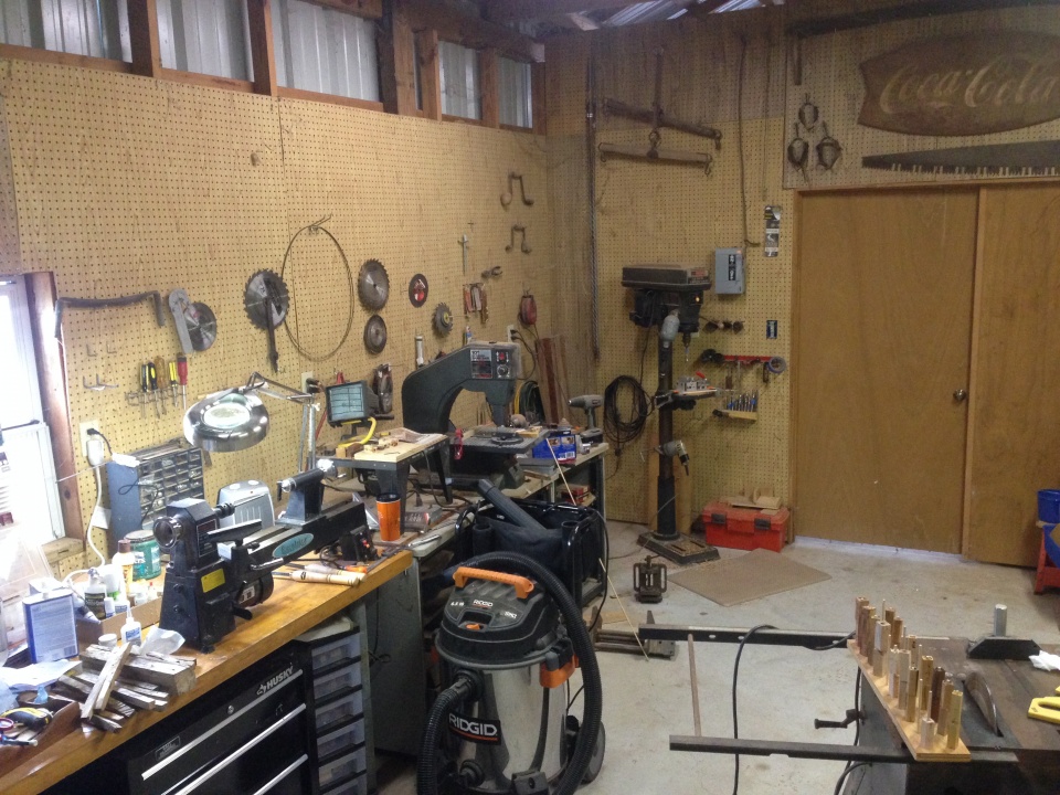

My shop is 15 x 25 - here's the outside wall
My lathe sits on a 3x6 workbench which is just a heavy-duty top on 3' high x 3" dia pipes. It's just the right height to allow me to stand fully upright while I'm turning. I picked up a Husky tool chest on sale at Home Depot to slide under the workbench for tools & accessories. It wouldn't fit with the standard 4" casters, so I replaced them with 2" casters. I have a total of 4 of those roll-around storage units that you can see just to the right of the Husky tool chest - one on each side of it & 2 more elsewhere. I got mine from OfficeDepot but I see that WalMart now has them too. I use those to store the blanks that I use most often.
My router & 10" bandsaw that you can see in this photo are mounted on repurposed computer carts. Back in the early 1980's Texas Instruments shipped their TI990 mincomputers pre-installed in these roll-around carts. We repackaged them into fixed 72" tall computer racks and took turns taking the excess computer carts home. I have 2 more of them - one for my miter saw and one for my sanders. With a small shop, it really helps to have most things on rollers.

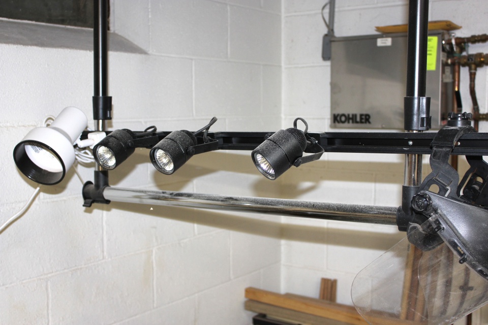

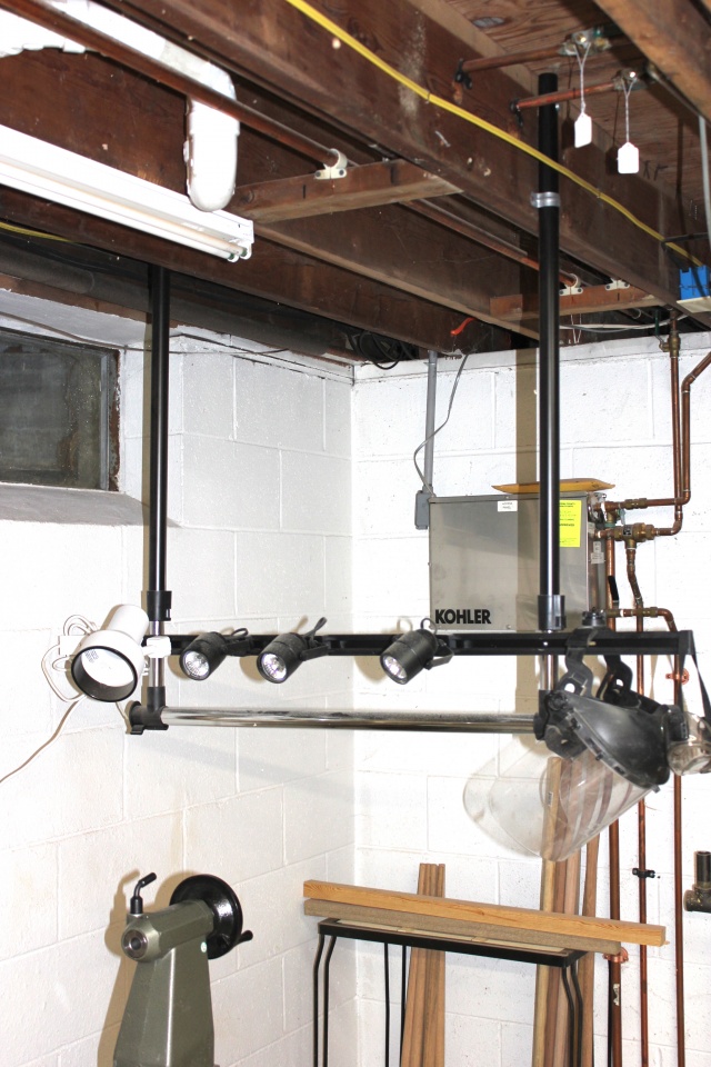

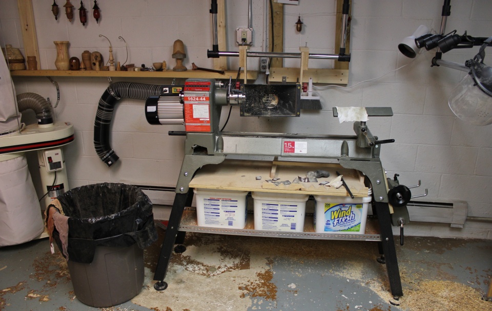

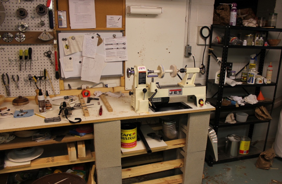

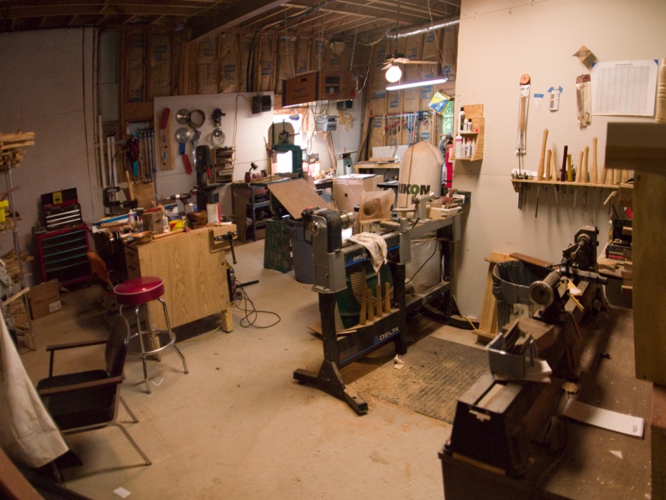

I have my lathes set up so I can work between them, as the smaller one is set up with a buffing system most of the time.

Mark, I like you set up for your Lathe. I was looking into doing something similar to yours. I do have a two questions: What did you use for the shelf under the lathe and are the containers filled with materials for weight? If the containers are for weighing down the lathe, that is a great idea. Thanks in advance.

HI John:
Yes! The very bottom shelf I drilled the legs and sized it myself. Simple angle iron and a plywood bottom. Any container that fits - mine filled each with about 50 lbs of sand. 150 lbs total.
The shelf above it simply sits on my containers - not attached to anything...I can pick it up and brush off the wood chips when making a mess. Can place my tools on it also.
Have FUN!

Thanks for the quick reply. I know what I will be doing this weekend.

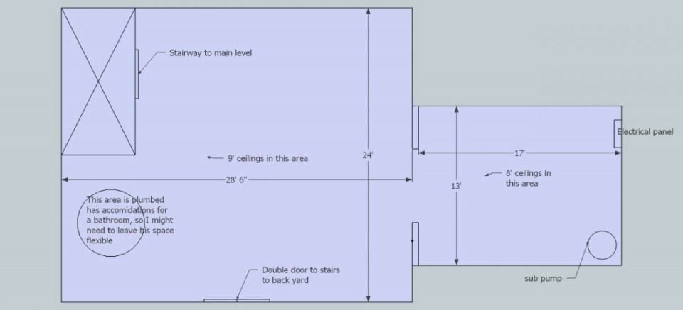

I thought about taping it out, that is something that I plan in doing. Until I'm actually moved in I took some measurements and am trying to plan it out in sketch-up. Here is what I have so far:
