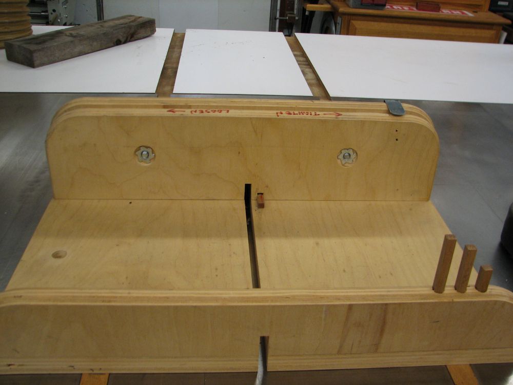

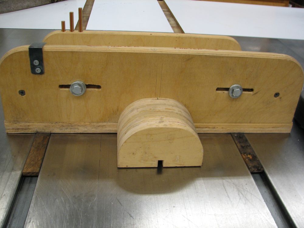

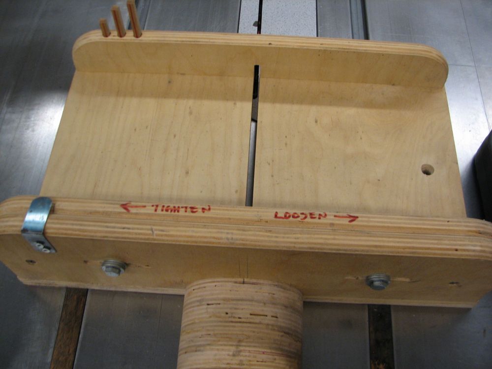

I made my own jig many years ago, don't use it much any more but it works well. You need to use a blade with flat teeth on top, the one pictured works great.
There are plans for building the jig online, you just have to look.
As far as routers go you can't go wrong with Porter-Cable, they're workhorses and won't break the bank.

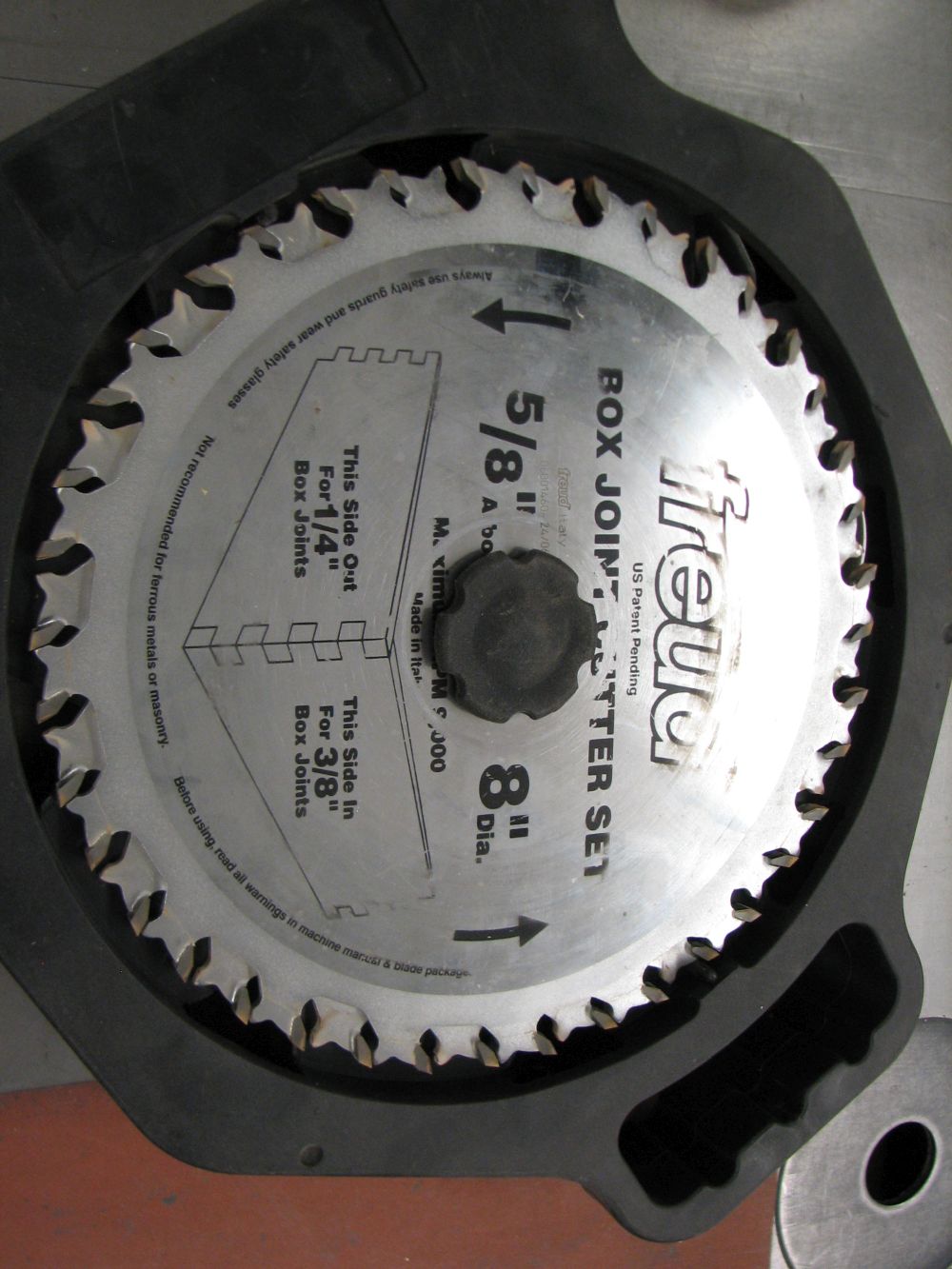

I'm kind of lucky in that I have had a woodworking shop long before buying a lathe, so I've got more woodworking tools then lathe stuff, so choices are good for what you are doing. Rick's jig and Freud box joint blade for a table saw does work really well. But even the box joint blade sometimes does not provide a dead flat bottom to the slot, as the construction of the blade still requires some slight offsetting to clear the debris from the cut. Normal box joints don't require the exactness that a pen slot needs, so the blades don't always have the tightest tolerances.
On a larger piece, like a normal wooden box, its hard to see the issue, but on a pen, you are down to the thinnest material right at the point where the tip of the blade teeth were in play, so chances of gaps between the wood and the corian are higher. To get perfectly flat bottoms, I prefer a router bit with a flat cutting top, usually used for doing slots in wood. I use a table mounted Porter Cable in a microadjustable router base, so its easy to dial in the cut, but between the table insert and the router and bit, you are well over $500 to make the cut. Not always an option.
To get the best results and keep costs down, I'd stay with the box joint blade and jig, but I would use a colored epoxy to glue it in. Either buy a pre-colored epoxy to match the corian - sold as a patch material, or use some dye to get the color the epoxy as close as you can get. Will fill any potential gaps and make the cut look pretty good.
