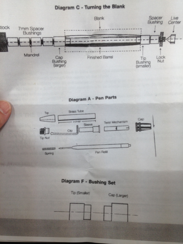

D DLGunn Member Joined Jul 31, 2009 Messages 285 Location Paragould, AR Oct 20, 2014 #1 Can someone shoot me a pm of the Le Roi Royale instructions? I think I know how it goes together, but I want to verify it. Thanks, dlg

Cmiles1985 Member Joined Nov 12, 2013 Messages 1,611 Location Aransas Pass, TX Oct 20, 2014 #2 The only part that's a little difficult to place is the transmission. You'll need to press it in. It will stop, but I think it stops a little too far in. I always press, check the fit and repeat until I like the amount the refill protrudes.

southernclay Member Joined Sep 6, 2013 Messages 2,297 Location Dawsonville, GA Oct 20, 2014 #4 This is for the elegant royale just to verify this is the one you need. Advice above about transmission is great too. Attachments image-1938382502.jpg 372.8 KB · Views: 226 image-560932317.jpg 372.6 KB · Views: 248
