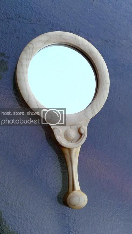

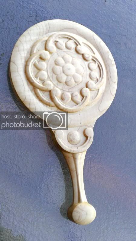

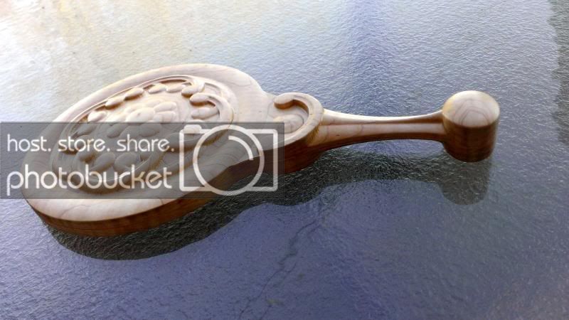

Dan, I know what you mean about just gluing the mirror on the face. I wanted to make my wife one so I set about designing one and cutting it out on one of my cnc routers. It started out the handle was going to be separate but I redesigned it to be one piece.
To me it was something that needed to be forever and show what she means to me. It was very time consuming but worth every hour I spent on it. Below are a few pics.
It was cut using curly maple and finished with tung oil.
There's only one problem. If the mirror breaks, it can't be replaced.

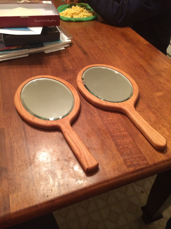

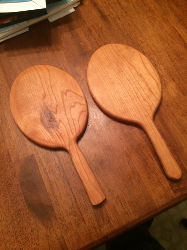

Dan Masshardt
Jan 30, 2013
4,806
Mechanicsburg, PA
Not amazing but not too bad for an experimental project I'll buff them yet.
