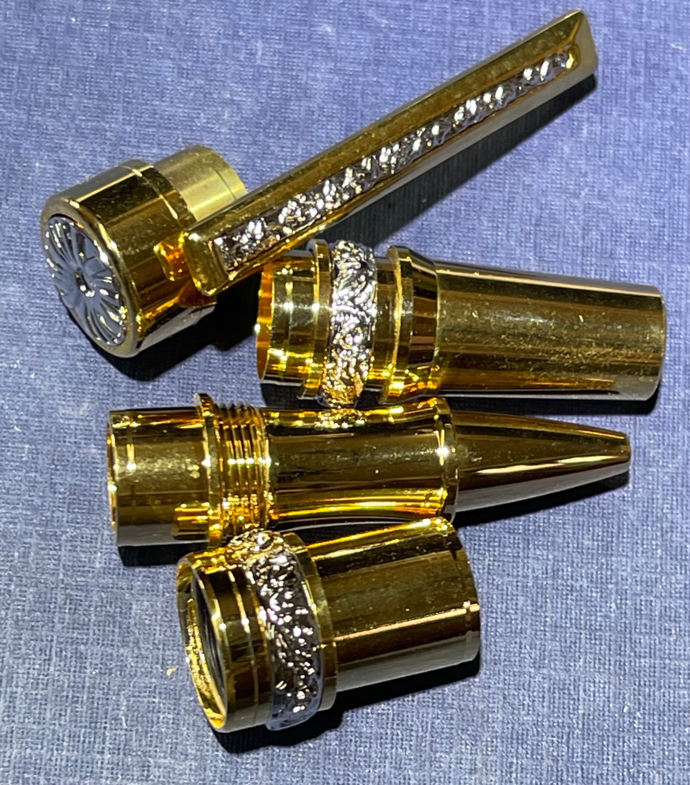

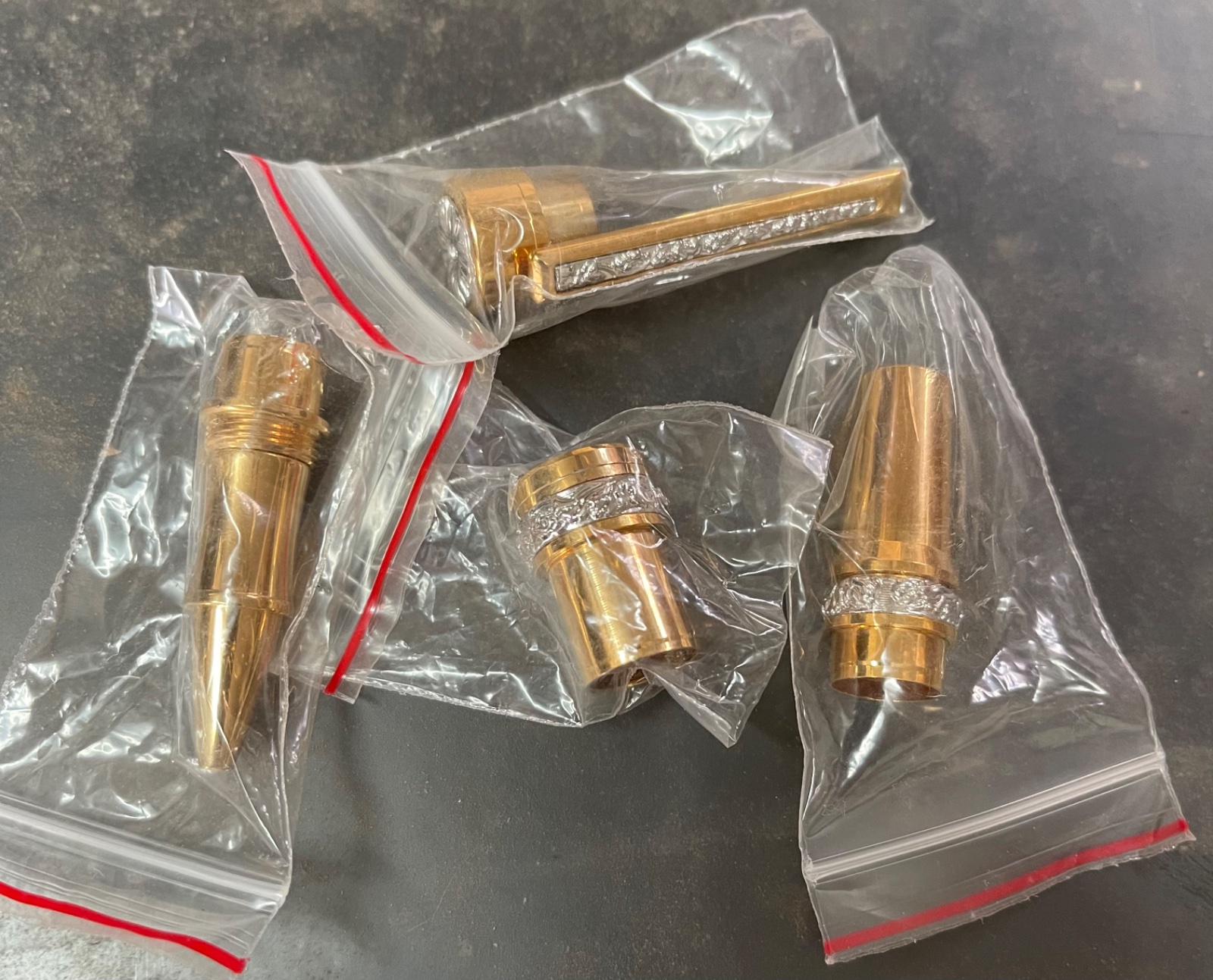

The kit could be up to 15 years old and is at least 5 years old. Not sure when I bought them and got them 2nd hand, someone sold them to me. The lower tube seems to take a 15/32 and the upper seemed to match up with 12.5. Will get the Mike out tomorrow and take actual OD's.
Hopefully the pic will jog someone's memory.

Cambridge and El Grande use the same bushings right? The upper bushings were just a tad too big on my El Grande bushings.
They do. So maybe not.
But that is some fairly distinctive hardware - maybe someone knows of a close variant.
So tubes measure .514 OD with .487 ID. Lower is .475 OD with .445 ID.
I've a spare set of bushings if you want to try - pm your address
And here is what the pdf has on the Cambridge
Upper Tube : 33/64 or 13.2mm drill 0.510 dia 1.69 length
Upper Bushings : 0.590 0.494 0.590
Lower Tube : 31/64 or 12.3mm drill 0.470 dia 1.97 length
Lower Bushings : 0.536 0.450 0.536
Outer diameters are close. What do the calipers say for the diameter for the parts of the pen?
