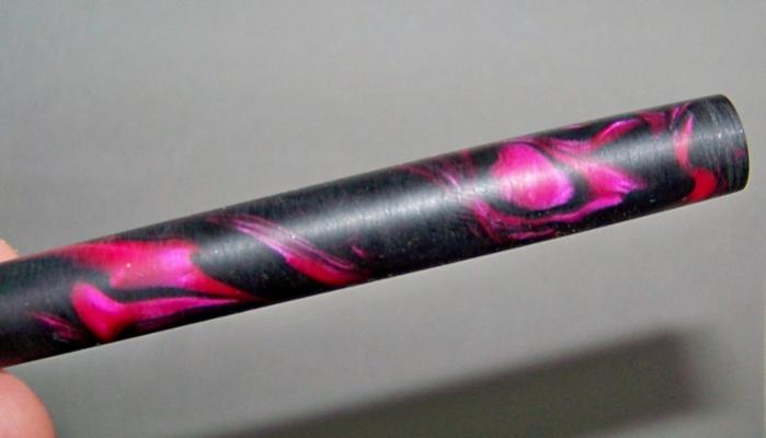

Hot side is nice, but I prefer cellini red. It's a dark hot pink that flashes bright hot pink in the light. Definitely can't confuse it with pepto. Here's a pic of that exact color combo for you Lupe. It's just rough turned and all scratched up but you get the idea.

Lupe, I almost started to submit a pic or two with some pinks, but after seeing Jonathan's blank, there is no way I can better that. As always, his creations are outstanding.
