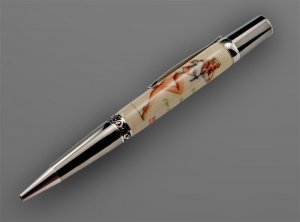

Here's an example of one of mine (using ivory background resin):
View in Gallery
Ed

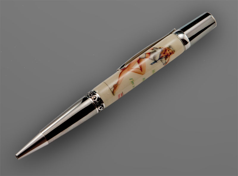

These are a few decal pens that I did. They are printed on inkjet, sprayed with krylon and couple layers of CA over top.
