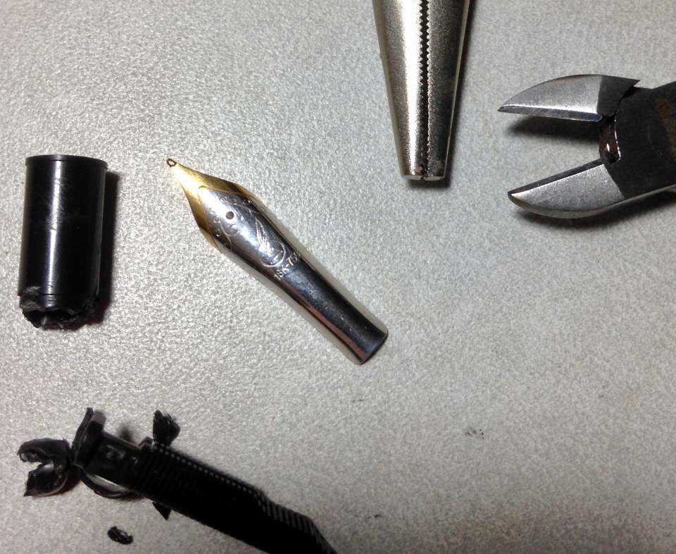

I have just received a 18K Jowo Triple purchased from Dawn. She is right, suggesting this nib will look fantastic on a Lotus style pen. I have a small problem: removing the nib from the triple where it is presently residing. I need to fit the nib to the Lotus. It is just stuck in there TIGHT! Does anyone have a suggestion for getting that feed/nib out of there without doing damage? I have reasonably strong hands and fingers, but cannot get it to budge when trying to unscrew the feed from the housing. Also unsuccessful trying to just pull the nib out directly. I am being a bit cautious, since my customer has already put down the Big Bucks, and I am sure he does not want a mangled solid gold nib on his new pen! Humble thanks to whoever will alleviate my dilemma.

If it's right, then you would not care too much if the feed from Dawn is damaged a little -- you can knock it out from the rear of the housing by tapping on the grooved stem inside the housing nipple.
Alternatively, drop the triple into hot water. It will not damage the nib in any way, but should soften the plastic of housing & feed.
Wear washing-up gloves to get a good grip (and so it doesn't burn your fingers) and just pull/twist them apart.

I would like to keep the Jowo stuff for future use, but it is low priority. I need to fit the Jowo NIB into the Lotus kit section, and can trash the Jowo feed and housing if need be. So, I will start with the non-destructive approach, and only get violent with it if it fails to cooperate. I will look at it sternly, and give it fair warning as I get started. :eek::rolleyes:

Heat is a good idea. Jowo housings are usually pretty tight. Wiggle and pull; wiggle and pull.
Twisting is not such a good idea since there is a flat on the feed and housing for indexing purposes.

Use finger and thumb on the underside and on top the nib. Don't hold on the side as you could bend the fins on the feed or possibly the nib. A very slight rocking side to side can help.

I tried all the suggestions. Some days the peaceful approach just will not get you there. A small pair of dikes, however, can be just the right thing at the right time! :eek:
Thanks for the help, my fellow pen guys. :smile:
