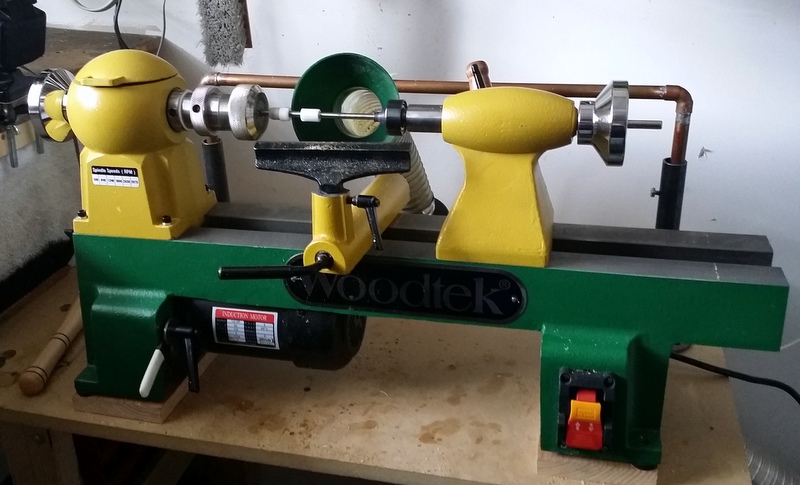

Jet, Rikon and Turncrafter are always mentioned. I never hear about the Woodtek midi lathe from Woodworker's Supply. I have used Jet products in the past, although not a wood lathe, and have been very satisfied. I had wanted to purchase the Rikon from Wooodcraft but they only had a demo. which they did not want to sell and were not sure when their next shipment would arrive. I found the Woodtek on Amazon. I liked the description and ordered it. I have been delighted. It is built like a Sherman tank and is very smooth operating. I know it is always a risk purchasing something sight unseen. It is much easier when you can touch and feel the product on the dealer's floor. I only mention the Woodtek because of my satisfaction.
