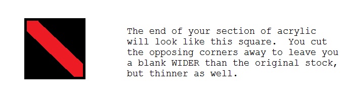

You MIGHT be able to use the ordinary size blank to get the material for that ring ....
What you will need to do is take a section about an inch and a quarter and cut 2 opposing corners off to give you your flats ... a diagonal section of the original square blank.
Take that section and sand the flats to give you a good surface for glue-up, and stick it to your faceplate (glue block) and turn it round ... once it's round you can work it from there.
