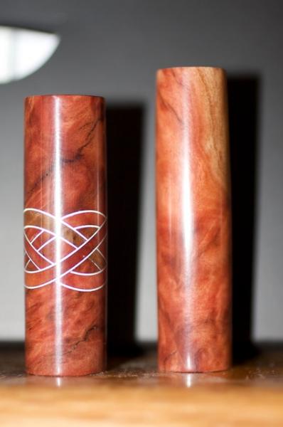

Aluminum Flashing
Here is a shot of a pen in process where I used aluminum roof flashing from the local borg. Same thickness as the bottom of a coke can but much much easier to deal with.

gomeral
Dec 29, 2008
220
Apex, NC
Greg,
Every time I think I'm getting better at this, you show me something to work harder to achieve. I don't know whether to thank you or thump you! :tongue:

Greg, that is absolutely beautiful. You'll have to share how you did that.

Every time you make a pen you improve in some small way. You see something to strive towards when you see that pen. Me too. It isn't perfect and I know what I need to do better next time... make the blank 100% square to start so that the "loops" are even rather than having thee ones on the left up higher than the ones on the right; do a better job of drilling through the center; and (from the back side) make sure the blank starts out significantly bigger than the final so you turn all the way down into the segments all the way around. Thank God for clips to hide the oopses.

#1 rule: have the segments exactly as thick as your saw kerf. Once you have that then everything else is "easy".
#2 rule: have a way to cut very precise and accurate strips of wood. I use a vacuum rip fence that you can find directions to here: http://www.davidreedsmith.com/Articles/VacuumRipFence/VacuumRipFence.htm. It allows me to make strips accurate to 1/100" and I can "guesstimate" to within 3/1000".
With those two, this is easy. Find your highlight material and measure it. Cut a saw kerf in a scrap wood. Figure out (kerf - (2 x highlight material) = filler material). Cut scrap wood to make filler material. Test filler + highlight and adjust filler until snug in saw kerf. Cut your blank big and square (see my previous note).
Now that the jig is set right rip a bunch of filler material strips.
Cut a saw cut 1/32" or 1/16" shorter than the blank is tall. Glue your highlight material and filler into the kerf. Let dry. Sand flush.
Rotate the blank 90 degrees and repeat. Repeat 2 more times. (altenatively, rotate 180 degrees the first time, 90 degrees the 2nd and 180 the 3rd for a more symetrical look).
Drill very carefully right down the middle. I drilled this on the lathe for accuracy.
Sand the corners off. Turn the blank. Show off to your friends!
It takes a "long" time, but is worth it.
