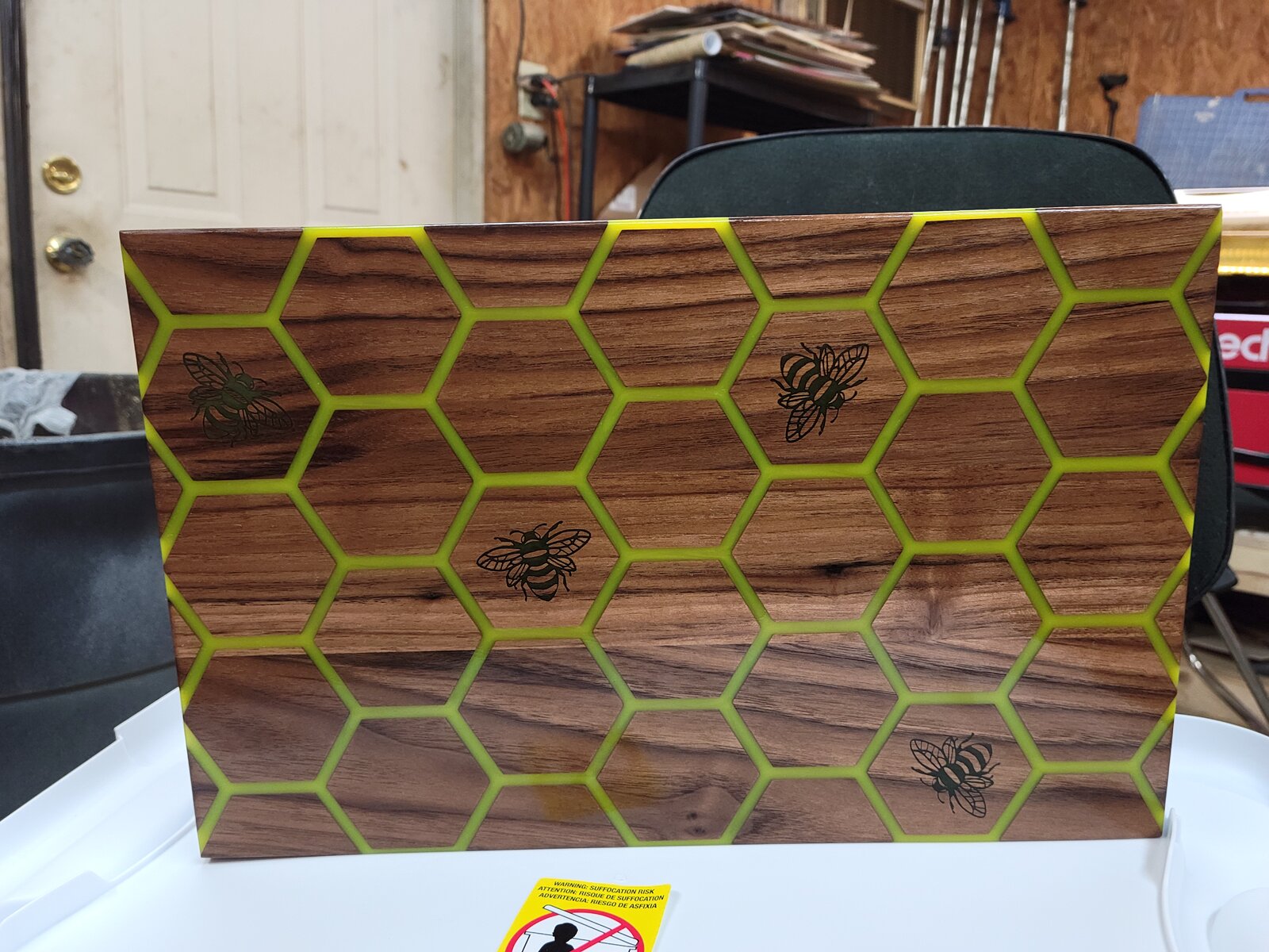

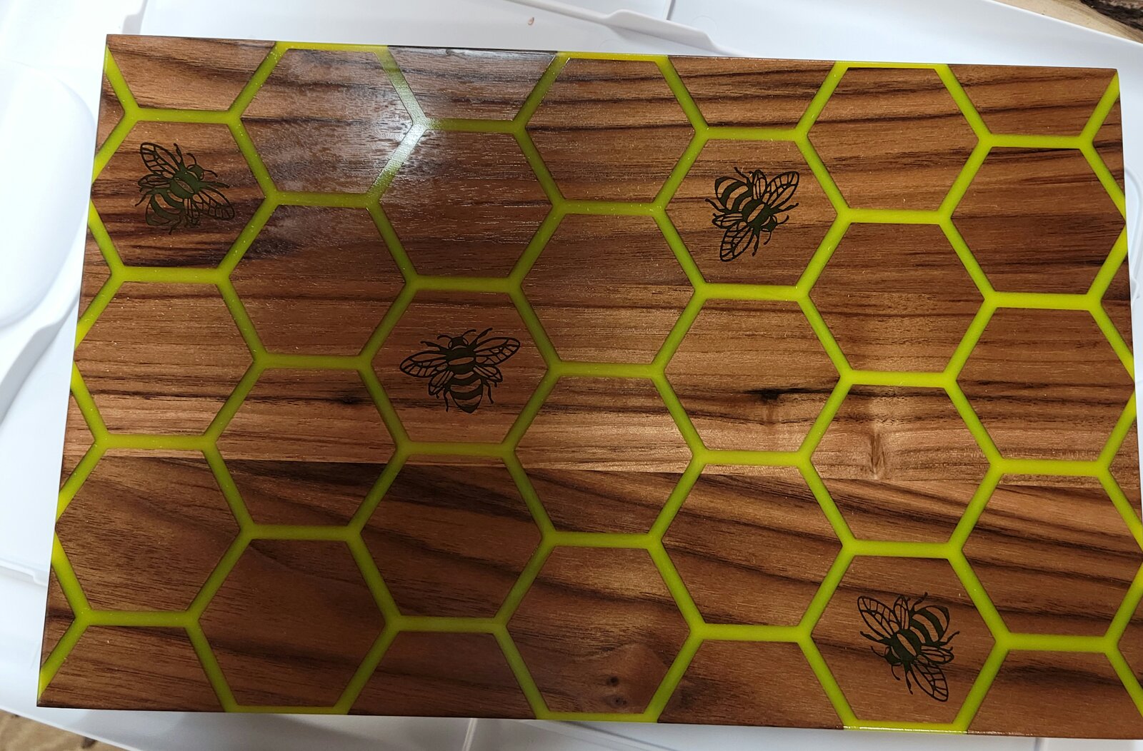

Need a yellow epoxy dye
hanau
Jan 5, 2007
1,384
thomasville, nc, USA.

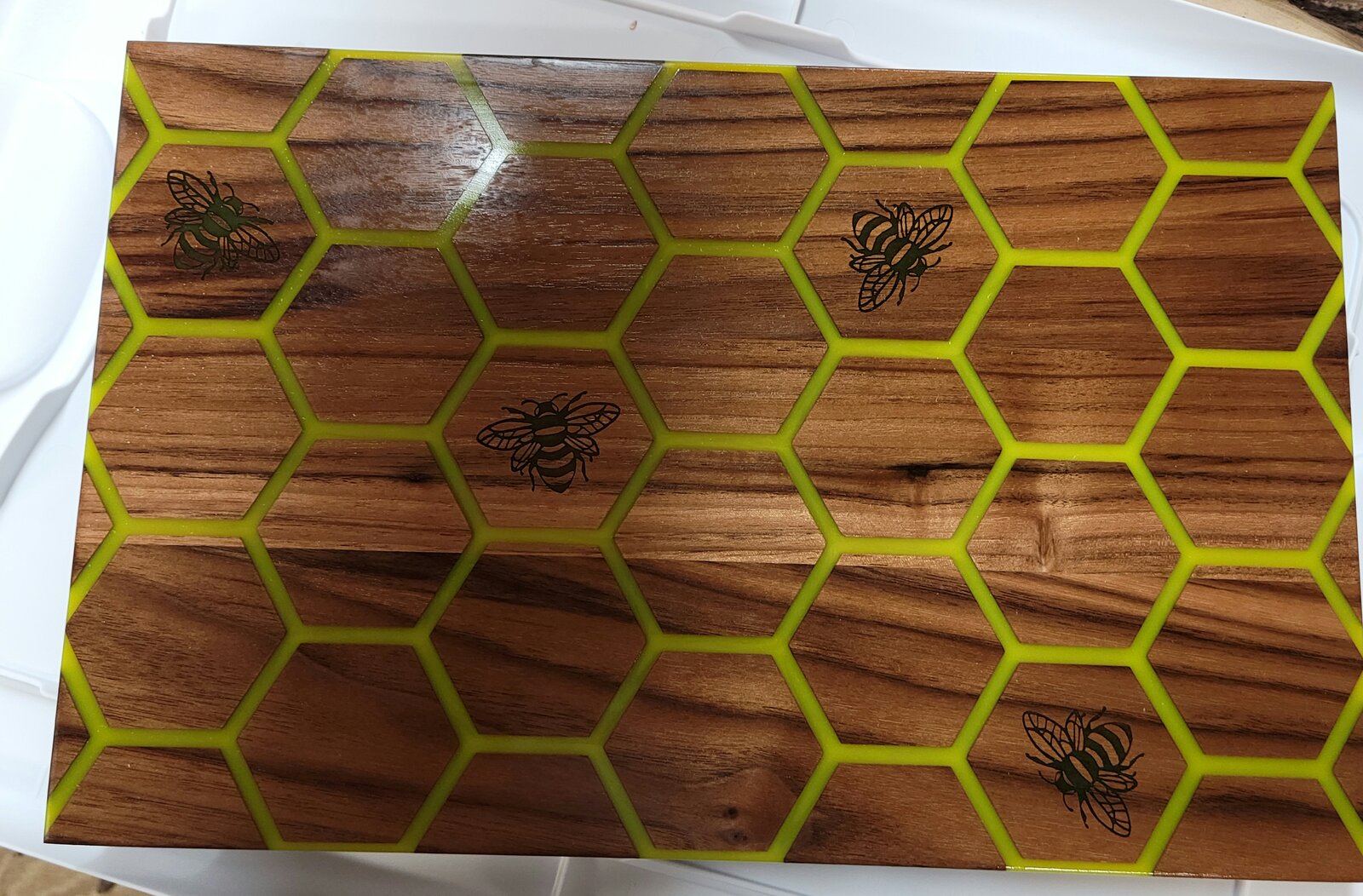

Made a cutting board and the epoxy infill needs to be yellow. But when poured into walnut it gets a greenish tint to it. The edge where the light hits it is yellow.
Is there a better dye to use? Think the dye I used was castin craft.

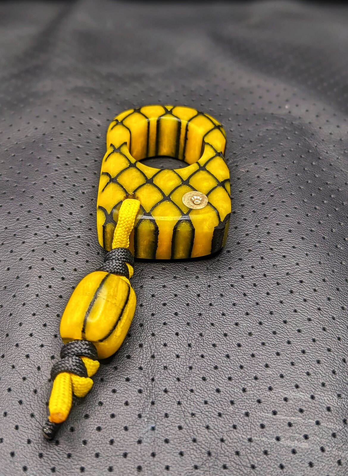

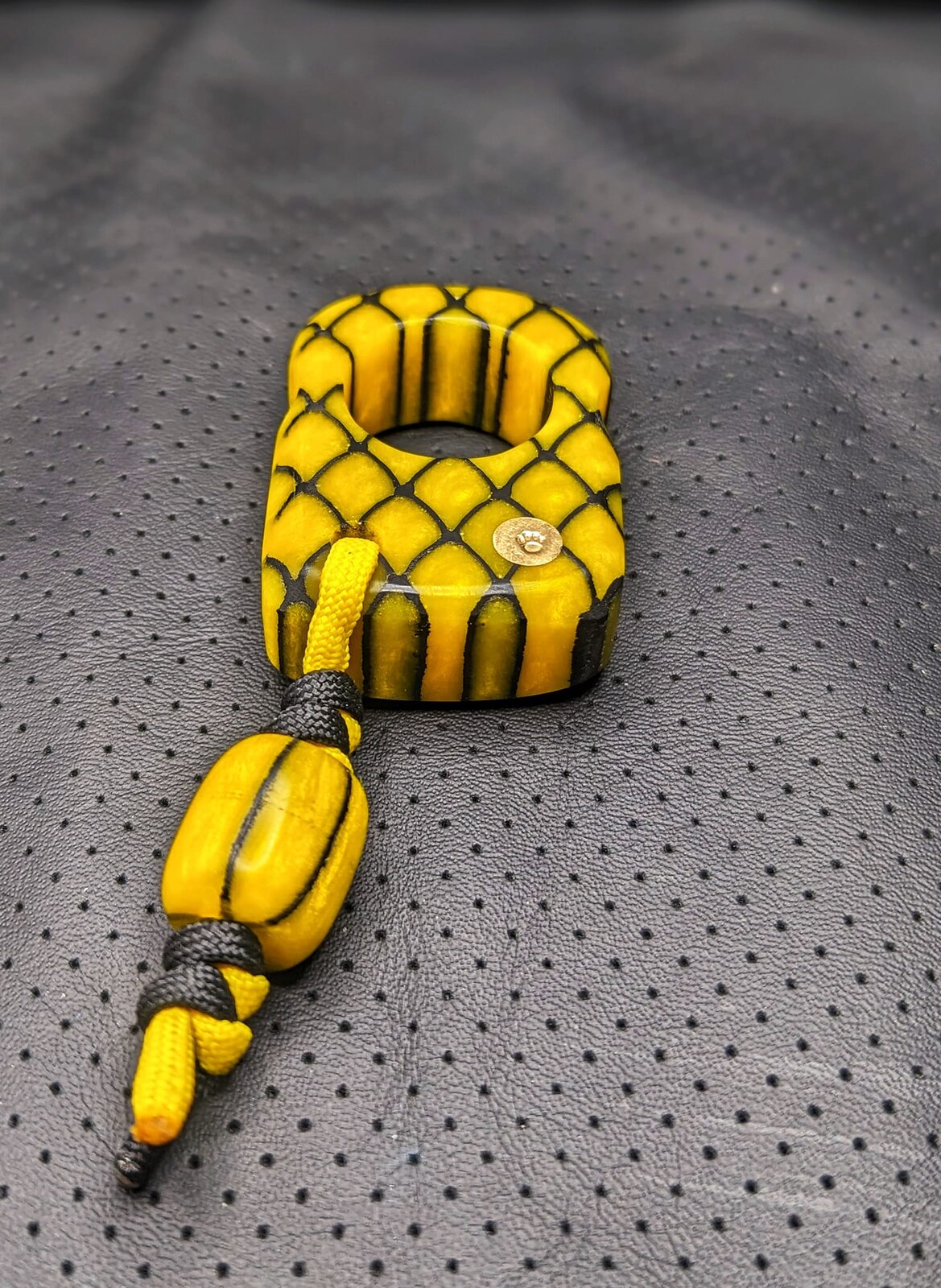

I would recommend either Koi Yellow from Eye Candy Pigments or Divine Turning Supply Sunny Yellow. Here is one of my pours in Koi Yellow.

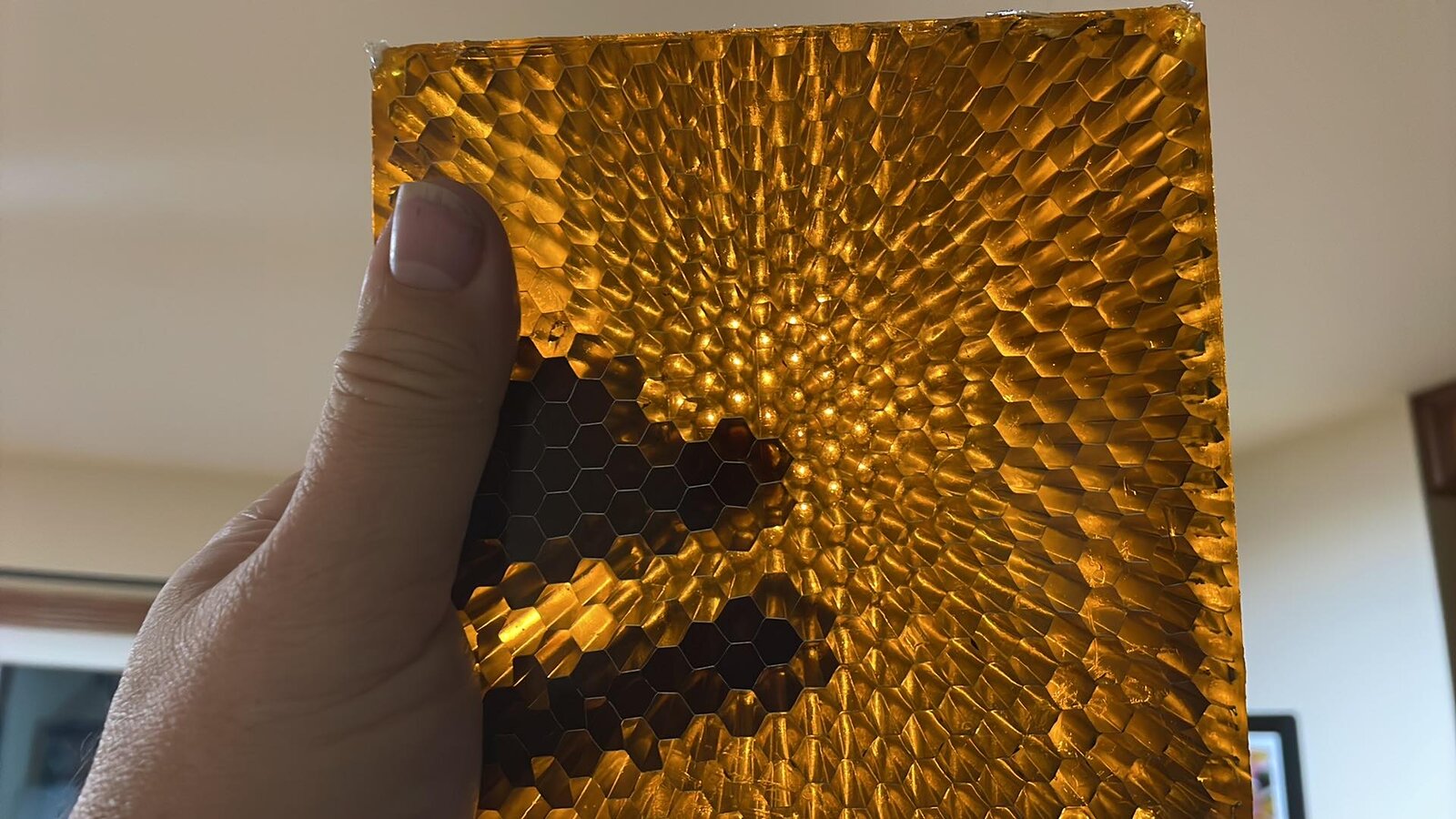

An Amber resin would look really sweet with that pattern also.
