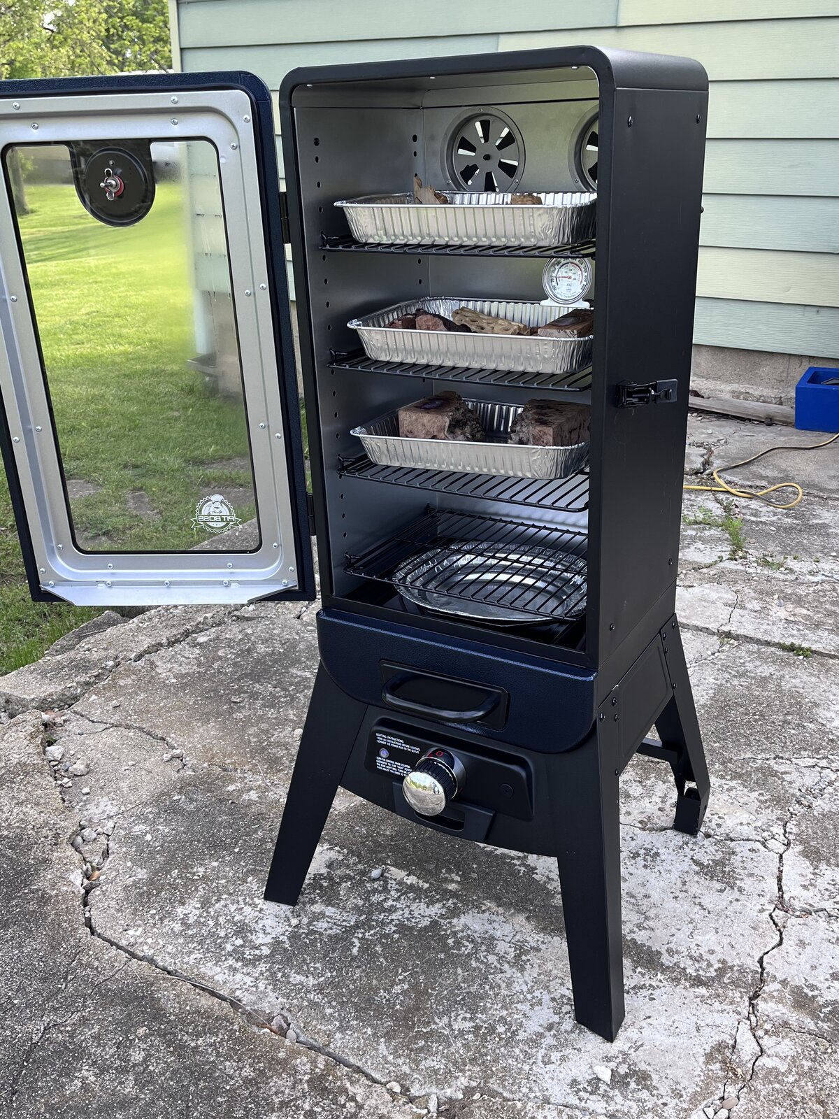

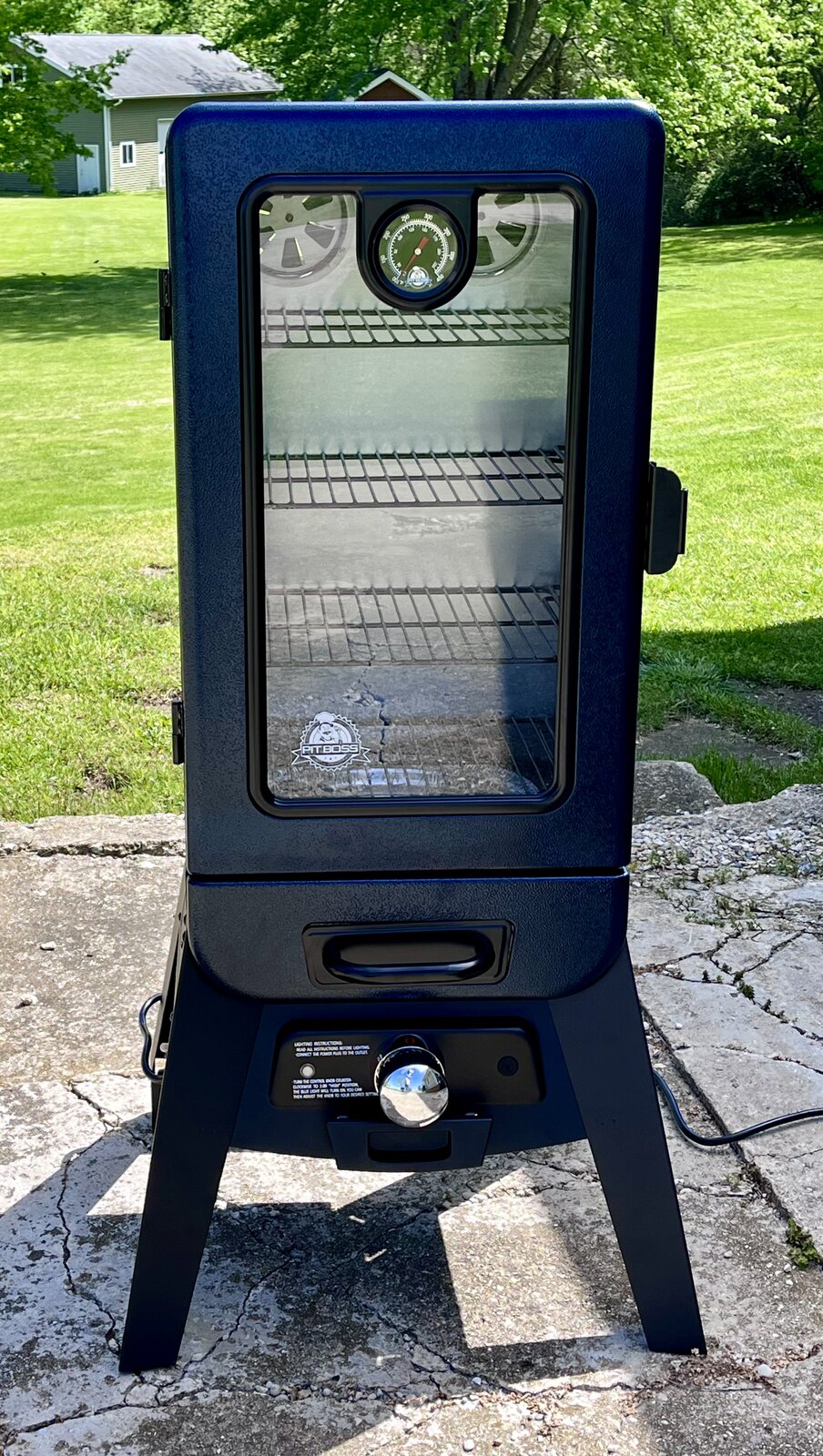

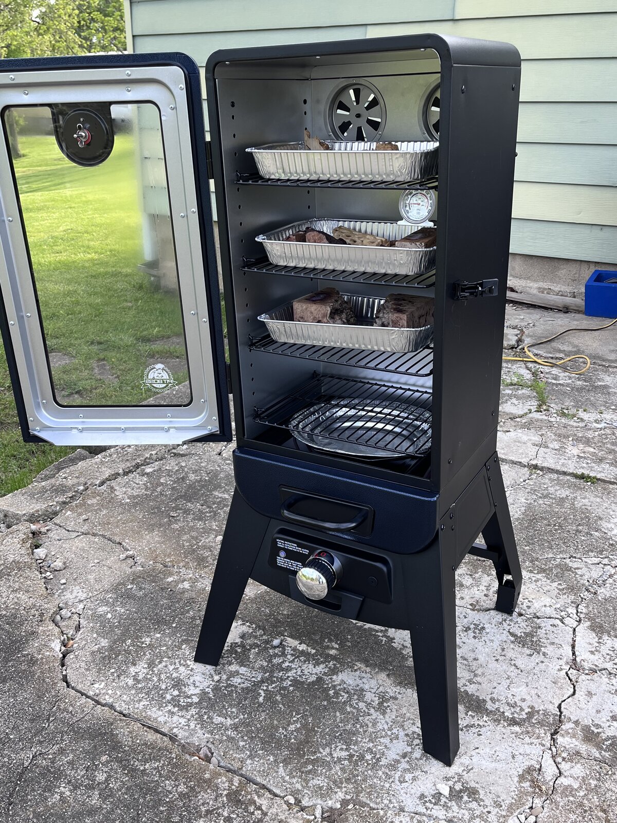

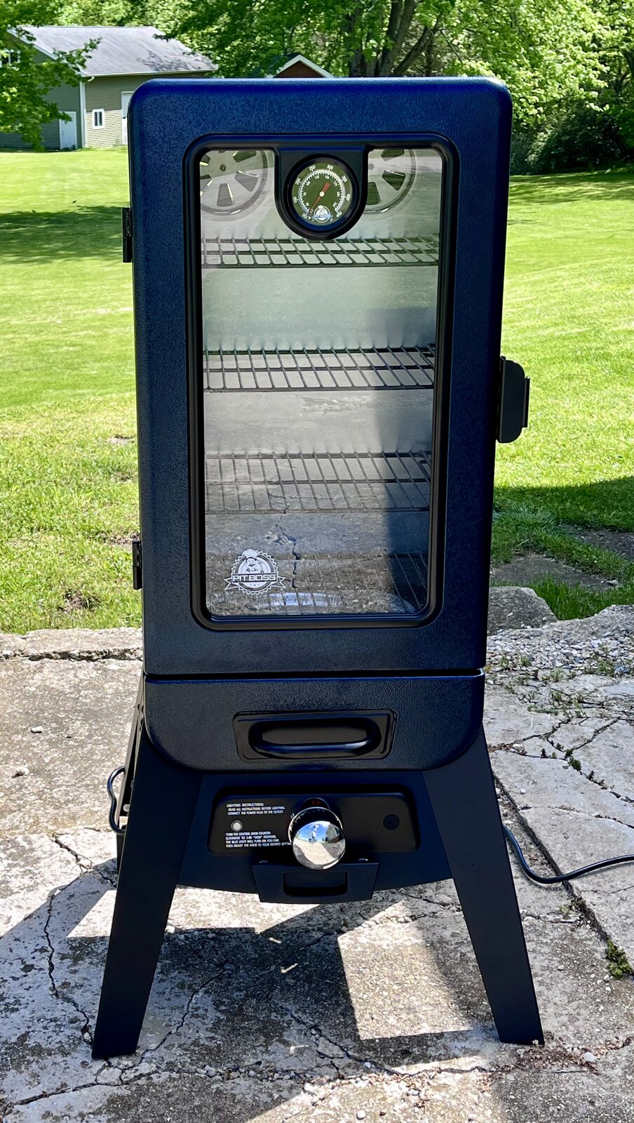

I use an electric smoker from Menards to dry and stabilize wood in metal pans so nothing drips down on the heating element. I leave it outside so there's no risk to the shop. I bought an oven thermometer to set inside to keep temp. because you can't trust the heat adjust dial to be correct.
