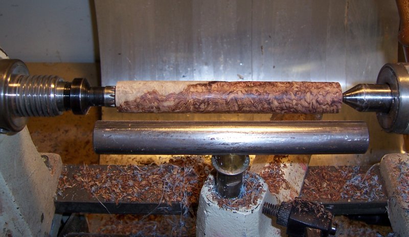

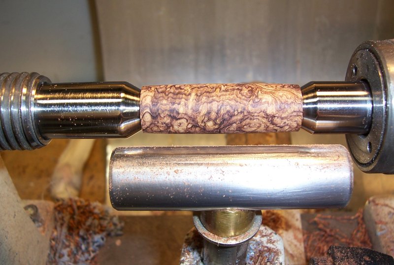

"....as I'm planning to turn center to center, and I probably won't be able to get close enough with this tool rest. And a related question: which is better for center to center turning, 4 or 6 inches?"
Neither....... I use a 2.75" rest (shown below)! :)
I decided to go with the T- Bar tool rest system and bought mine from a small "mom and pop" company who had the most reasonable prices at the time: http://bestwoodtools.stores.yahoo.net/tbarmodtools.html
The nice thing is the interchangability! I have two lathes, one large and a Jet mini so I bought a post for each lathe but the tool bars work on either post so only had to buy one set of tool rests. For pen turning I use the 6", 4" rests.
When I started turning center to center I soon realized that a shorter rest was needed so Rick, who goes by Rherrell on the IAP forum made me one to my exact specifications which was 2.75" long. This little baby is PERFECT for working blanks center to center! If you need a custom tiny rest, Rick is your guy!
Here are a few shots of my rests. I use the 6" for longer blanks then switch to the 2.75" rest for turning center to center, note how close to the work I can get without interference!
