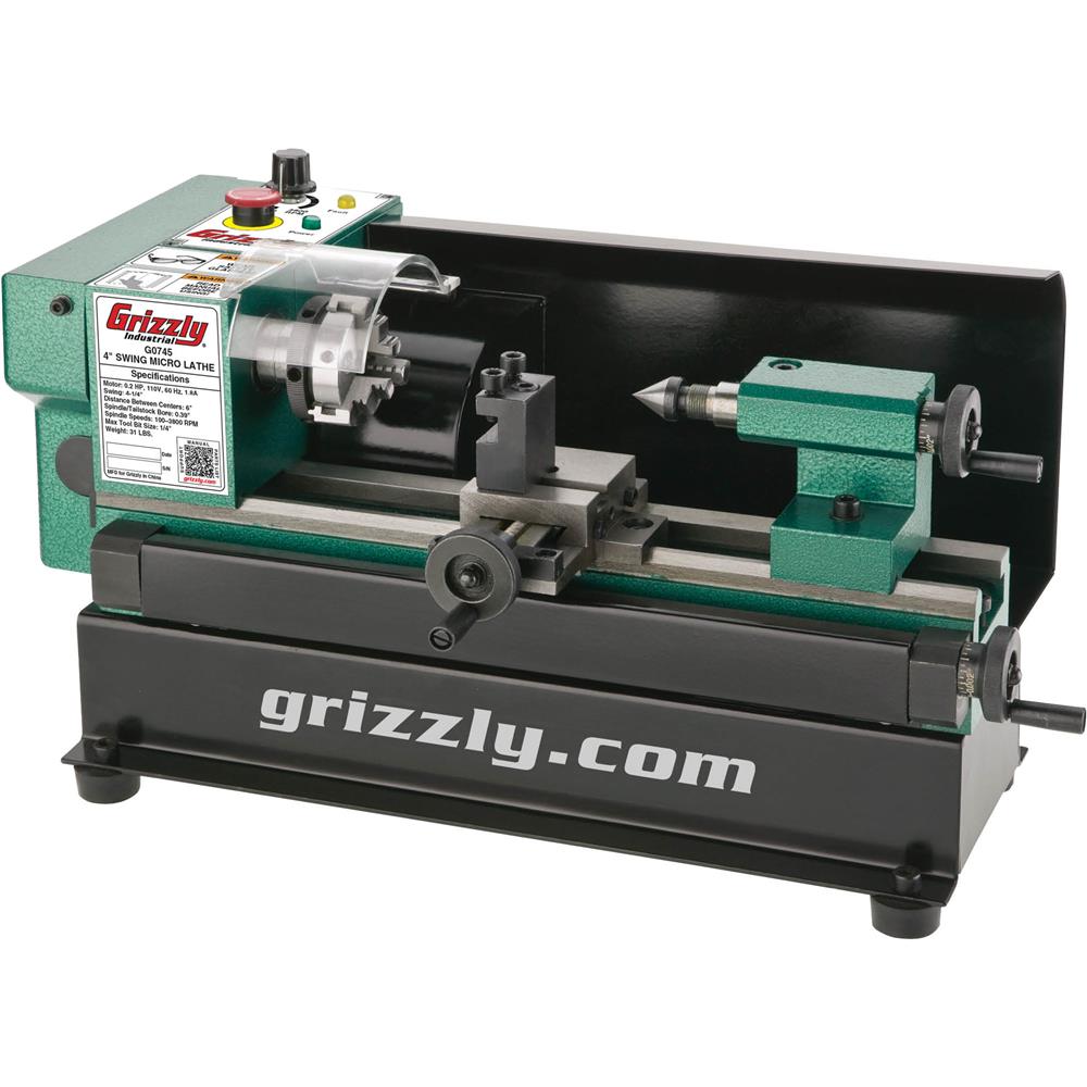

You should not buy the Grizzly 4x6 Micro Metal Lathe. . It's not even in the "toy category", IMHO.
The distance between centers of 6" is just not long enough, and the spindle bore of 0.39" is way too small.
Spend a few more dollars and get a Sieg 7x12 at least ... preferrably 7x14

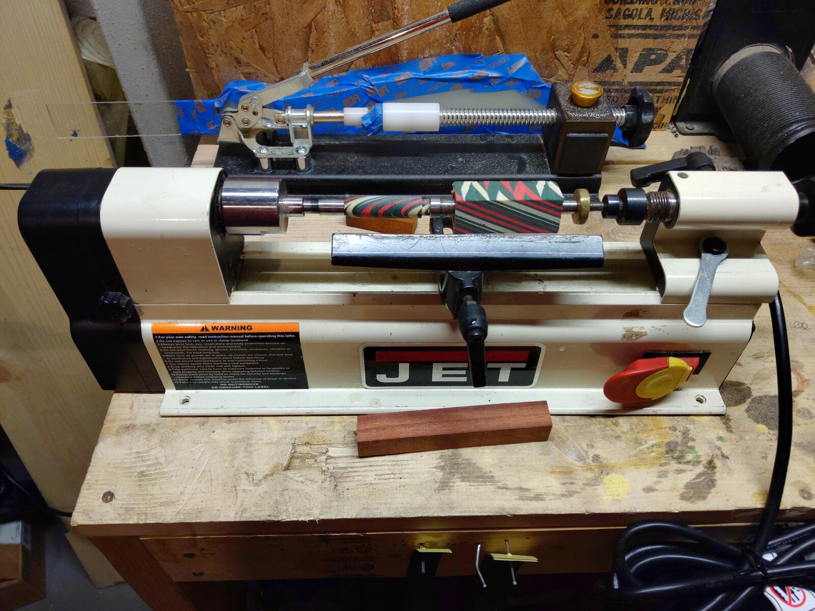

@Sauerkraut
Is the Jet Pen Lathe still available ? . I seem to recall some threads a few years ago discussing it and mentioning it was not being sold anymore
Can you point me to a picture of the lathe you have ... the Jet Pen Lathe ... please. . Thanks .

@Sauerkraut
You recall correctly, they're unfortunately out of production. They were model JPL-358. They use a 0MT mandrel which is damn near impossible to find, but the 3/4"X16TPI mandrel sold by PSI works perfectly.
I love mine for taking to shows due to it's small yet extremely rigid profile. With the exception of the wrenches for adjusting the tool rest and tailstock, they're built like tanks. Although with a 1/6hp motor, they require a lighter hand when doing some serious roughing. Will get a pic of mine shortly.
Sauerkraut
Oct 8, 2017
25
Wisconsin
Jet pen lathe with 5" blank in front for size reference. They take up a tiny footprint and are great in a pinch.

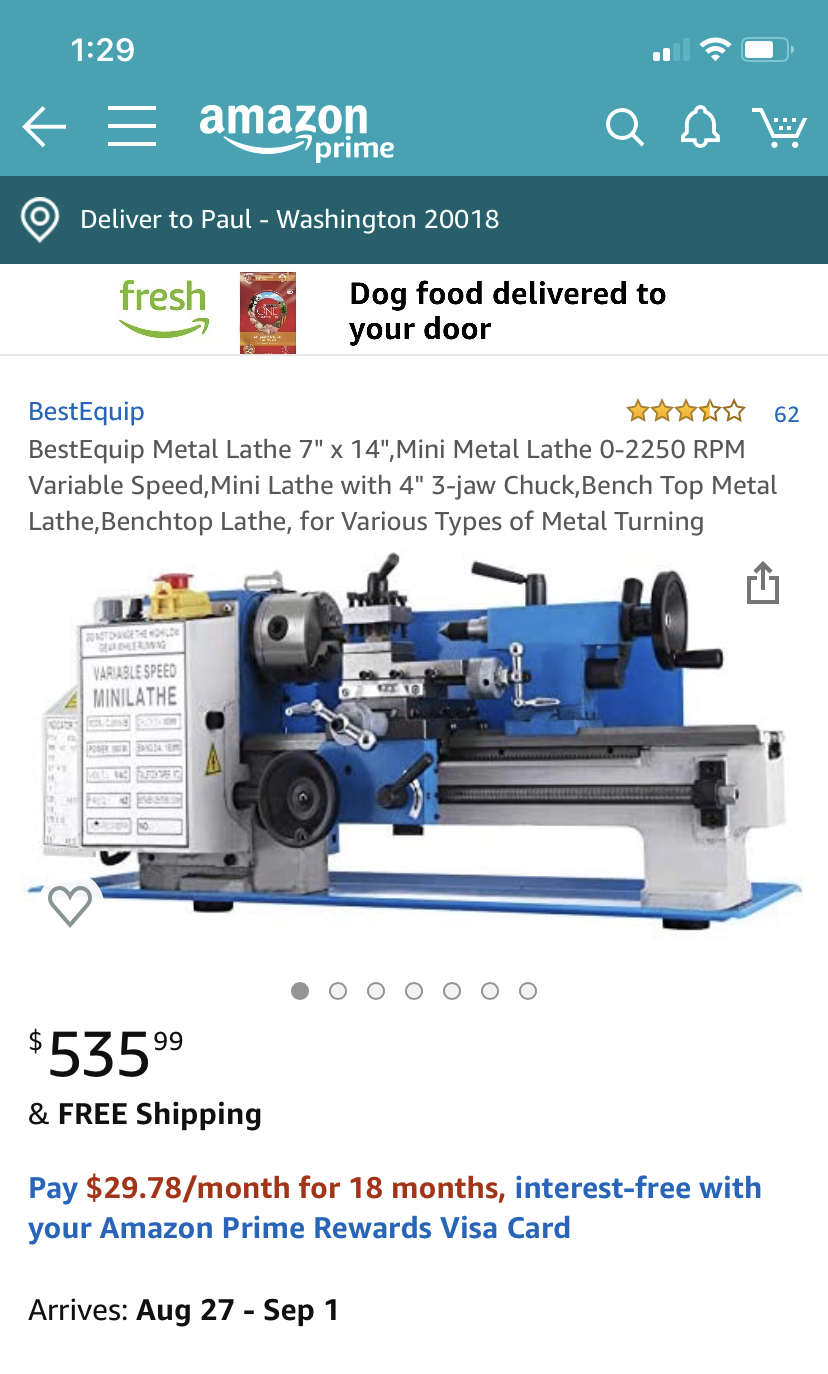

Well there was a little hick up with the sieg lath so that gave me a chance to look around a little. The delivery on the sieg was almost $200 so I saw this on line with free delivery. Has anyone used one or heard about them.
magpens
Feb 2, 2011
15,912
Canada
The chances are high that the internals are from Sieg.
The exterior is very similar to Sieg.
In one post recently, someone said that a tell-tale sign that a lathe is not a genuine Sieg is if the horizontal drive shaft protrudes from the mounting bracket on the right hand end (just under the lathe bed on the far right side).
This picture does show that to be the case on this lathe.
I have no experience with this particular lathe, but I have been using a Sieg "knock-off" for over 10 years.
I have opened it up, and it does have the "Sieg" name on the printed circuit board that controls the motor speed.
That in itself does not mean much, I guess, but it does tell me that it is probably basically a Sieg.
If I were in your shoes, I would buy this lathe. . I think it will work out fine for you. . Of course, it is impossible for me to give any guarantee.
One think I would like to know if you can possibly tell me is the "power rating" ... on the front panel, does it say 500W ?
I haven't tried looking up this lathe on Amazon, but I will try that now.
EDIT: . Nope. . I clicked on the pic and it does not take me to the Amazon listing. . If you can help me get there I might be able to learn a little more.
Oh ... made some progress doing a Google search .... is this the listing ? . Looks much the same as your pic ...
I see this one has a power rating of 550W, which is good and typical of current Sieg lathes.

AS I said above, I did find an Amazon listing with pic similar to yours.
So I am going to read what the listing text has to say.
I hope someone else can chirp in on whether they have experience with this lathe ... would be nice to hear some first-hand experience.
Just had an idea ..... why don't you phone Little Machine Shop and talk to a guy named Chris (if he is still working there).
Ask him about this "BestEquip" lathe from Amazon .... and how it compares to other Sieg look-alikes.
Chris is a very knowledgeable guy when it comes to metal working lathes of this style and price range.
magpens
Feb 2, 2011
15,912
Canada
I can see from the pics and the text that this lathe has two things that I did not get with mine and which I wished for:
1. 4" chuck with 3-jaws (I got only a 3" 3-jaw). . The 4" size is really good for pen blanks .... just the right size. . A 3" can be too small for some blanks
2. An "easi-lock" tail stock hold-down (I have to tighten up a nut with a wrench on mine).
If I were in the market for a new lathe I think I would buy this one.

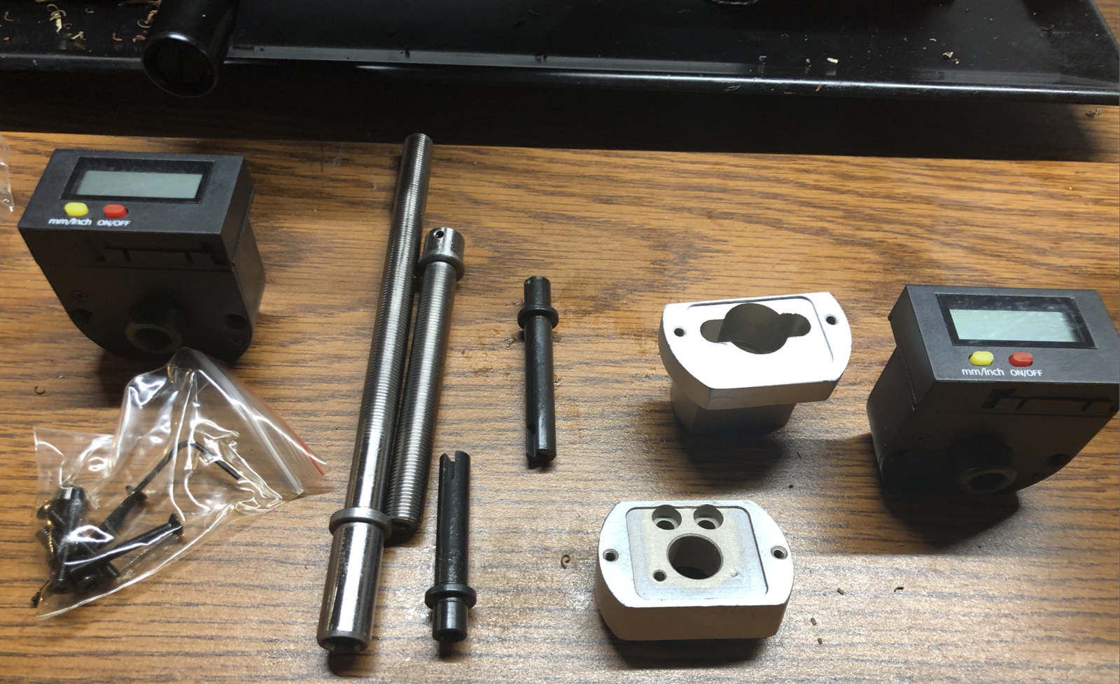

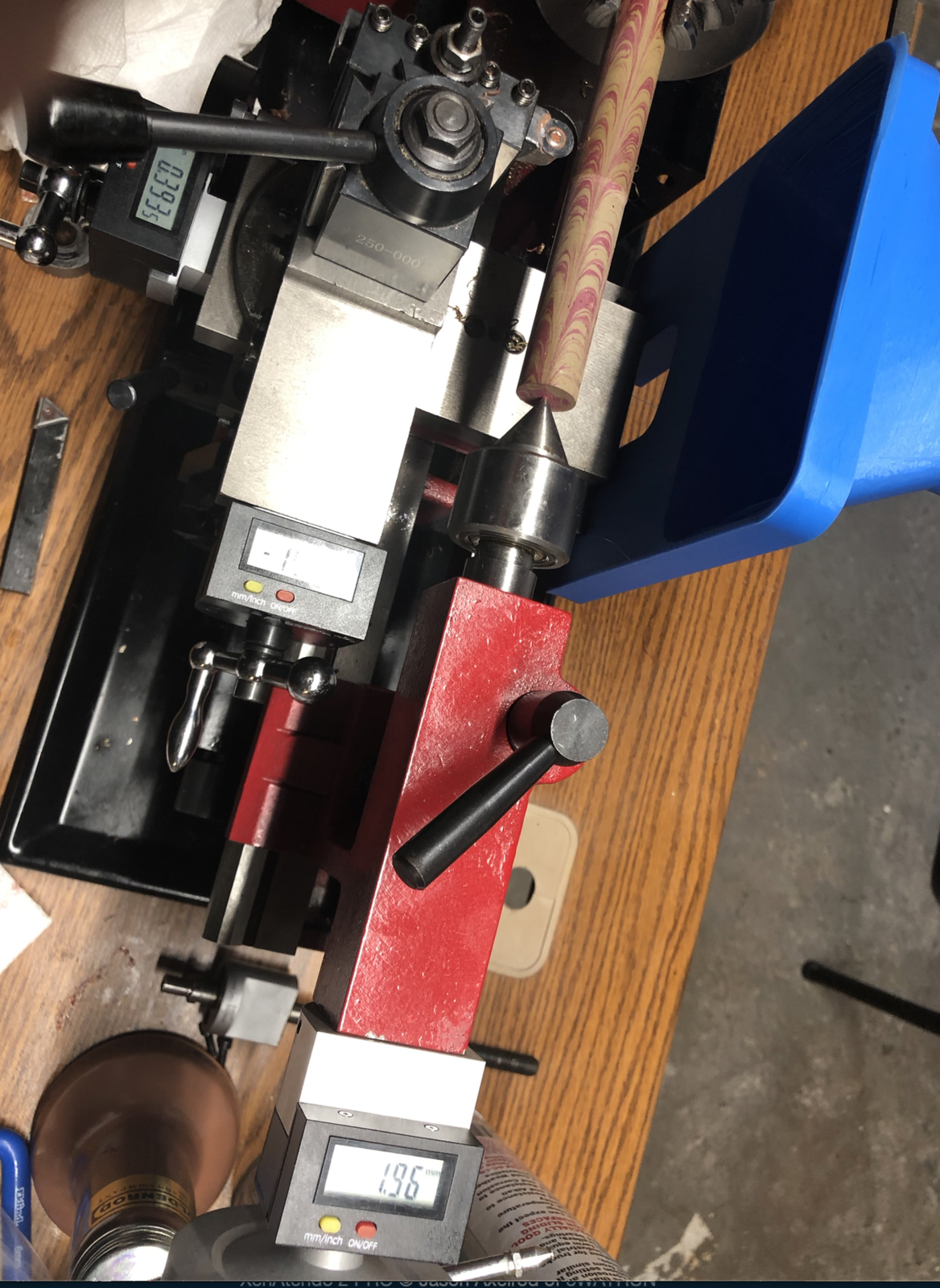

@NT_2112
Thanks for posting that picture, NT_2112 !!
I have never seen a Sieg lathe with digital readouts on the tail stock and cross feed.
Did you buy those as extra accessories ? . And, if so, where, please ? . I would be grateful for that info as I would like to buy such readouts.
Especially for the tail stock. . Thanks !
NT_2112
Nov 6, 2019
147
Rochester, NY
@NT_2112
I bought these:
https://littlemachineshop.com/products/product_view.php?ProductID=5675
and
https://littlemachineshop.com/products/product_view.php?ProductID=5879&category=
One could buy various parts from Aliexpress and piece this together yourself. For me, it was better to just buy the kit. Total install time was about an hour. But if you have taken apart your crossfeeds to the exploded part level I will bet you could do the install in 20 minutes or less.
It's a great upgrade IMO, well worth the money.
