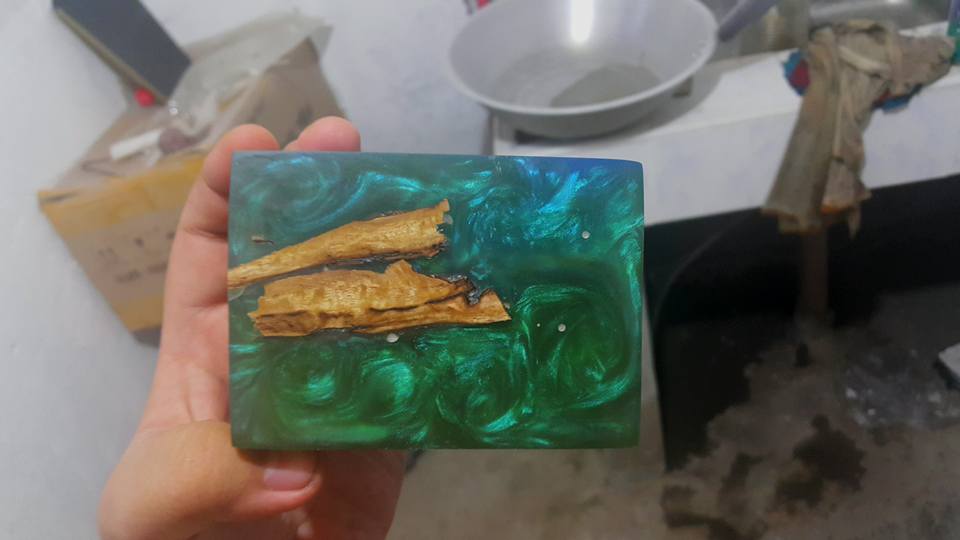

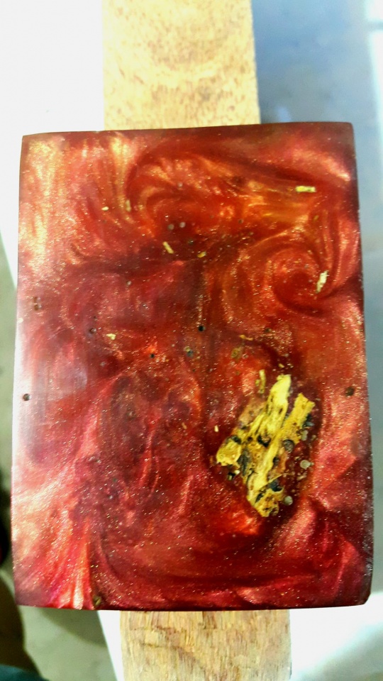

Hi guys I'm just a newbie on PR casting. I did my first 2 blanks without pressure and just let it air dry, and turned out that it has bubbles on it, but what troubles me more is how to figure out why does it crack or turns brittle where it is near the wood part inside the blanks. How can i solve this without using pressure pot? What is happening ?why it is having cracks on the wood part. What should I do with it too?

Sorry for not putting much info sir. Here are the answers to all your question.
-Im using Polyester Resin w/c is produced locally here in the Philippines.
-I'm pouring 3% MEKP on the overall weight of the Polyester resin.
-I'm using a DIY silicone Mold.
-The wood im using is called locally called Lanete w/c I've tried to google and said that it was internationally known as Ivory wood
- And yes I'm casting wasted wood blanks that haven't reacted very well on my stabilization process.

Thanks for all the answers guys (Y) appreciate it. Pre heating the wood works great on my blanks. I guess the only problem now on my resins are the bubbles w/c would only be diminished by using pressure pot upon reading so many threads here.
