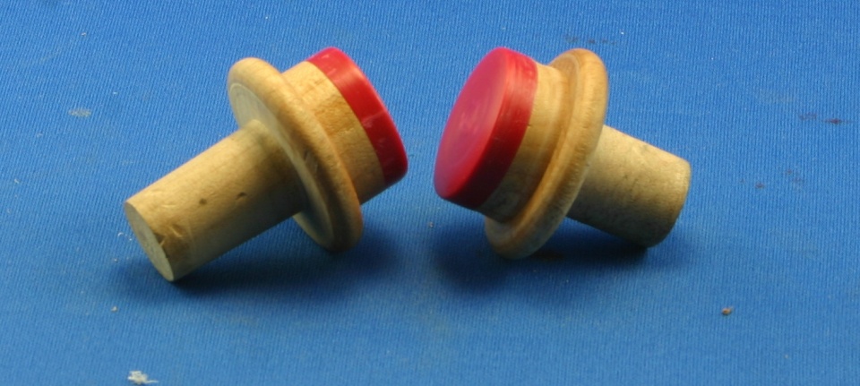

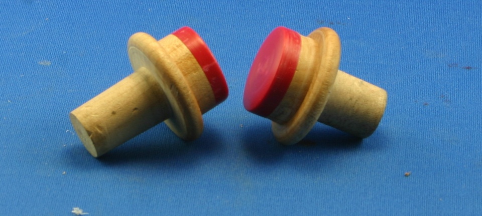

Something like this? These I take when I travel. They work great.
Do a good turn daily!
Don
Don
Mine are NOTHING like yours Don. I used a WHITE cutting board scrap, not a RED one. Everybody knows red is so last year. :biggrin:
Yea, mine would pass as cousins to yours. GMTA!!!
