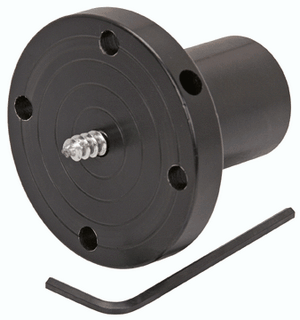

I need a faceplate for my new lathe, It uses the standard mt2/1"x8 spindle. I am going to be making bowls etc and I will not use the stock faceplate that comes with the lathe. (jet 1220vs btw)

Size wise? I was thinking maybe a 2" or a 4"
2 3/4" faceplate/screw chuck - $12.99
