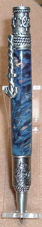

I would like to ask opinions on 2 things regarding this kit/blank.
First, I ordered a blue box elder blank but it is a darker blue than in the catalog.
Do you think it is too dark for this kit.
Second, I turned the blank to just proud of the fittings. Mine is at .528" and the bushing call out is .495". I looked at several examples and I like the look of the blank larger than .495" which would set it smaller then the fittings.
Does this size look OK?
I still need to do a better job of preping the blank. There are a few small voids that I want to fill and clean up the ends a bit.
Thanks for your help.
Dale

Actually, I think the colors in the blank are a very good match for the pewter hardware.
As for size, I think it looks right as you have it. Great looking pen !!! Thanks for posting ... I want to try a nautical or two and it is good to see the work of others.

I like the color with the kit. But it doesn't look like the finial is pressed in yet, but maybe i'm looking at it wrong. The fit on the nib end looks good.
Thanks again all for the comments.
Bob, I can see where the image would be a bit confusing. I didn't explain the picture very well. It was getting late and I forgot to go into more detail. My bad.:redface:
The only end that gets pressed in is the top so I was able to show the lower end up against the hardware.
It is actually not a great fit either because I can move the blank side to side slightly.
I may put a thin layer of CA inside the tube to see if it fits better. But I'll let it dry before I assemble!:smile-big:

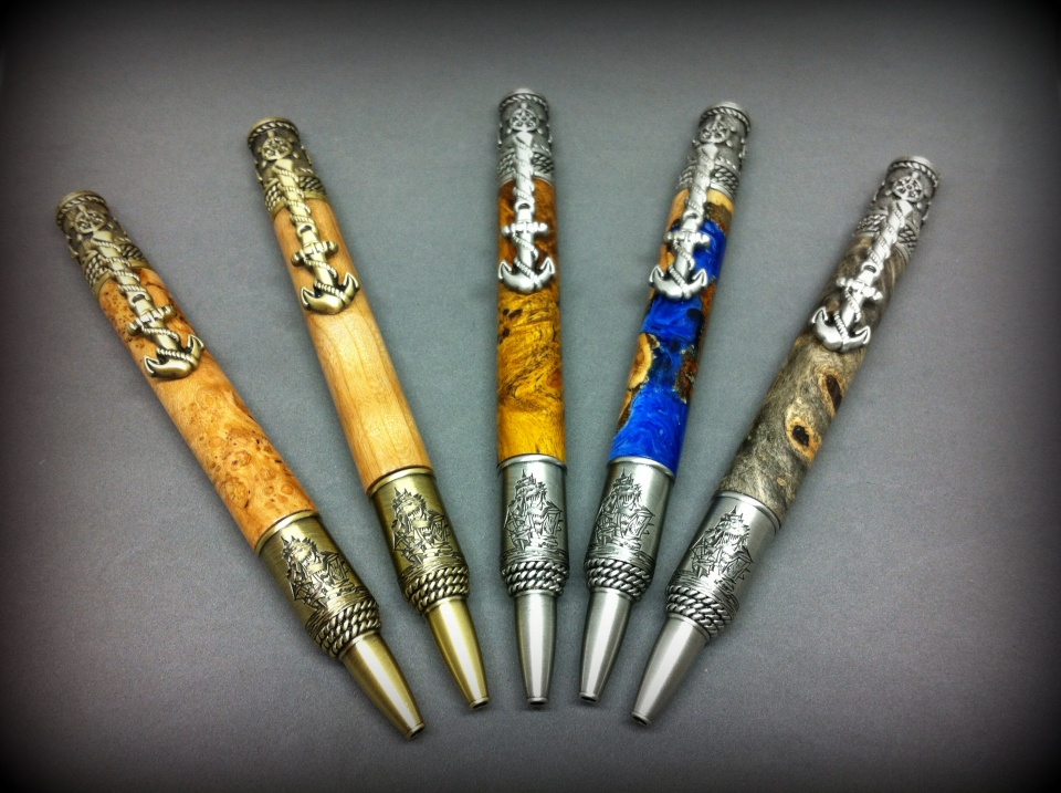

Great color combo...personally I've turned a few and I like to turn to a little less than .495 you can see the difference on these the cherry is turned proud the others not so much.

Nice pens Adrian, I particularly like the blue one.
I am puzzled though by your comment. The second from the left looks to be proud of the hardware but the rest seem to be even with the raised band on the lower hardware section. Maybe it's just the angle of the picture. I measured the hardware at .525-.527 and .495(the recommended bushing size) would be noticeably smaller.

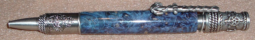

Well, I finished it and I like it but not as much as I had hoped to.:confused:
Maybe I'll order another kit and the turquoise blank this time.

I understand your statement, but remember the artist is his own worst critic.
I think the color combo is awesome! It makes me want to run out and get a dyed box elder blank!
