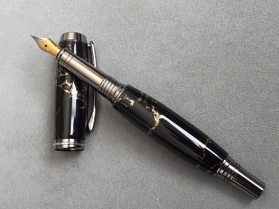

There is a material named TruStone that is stone dust 90% and resin dyed to look like many different types of stone. It looks, feels, and polishes like stone but can be worked with woodworking tools. Here is an example.
