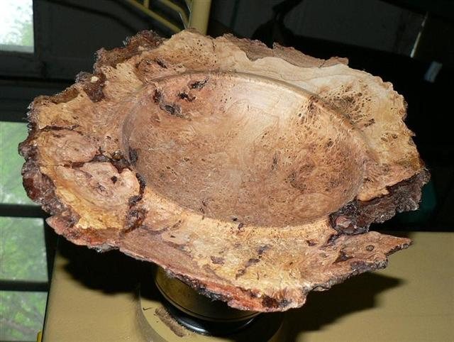

I finally had some shop time last night and this is what came out...my first bowl after a long break (more than a year).

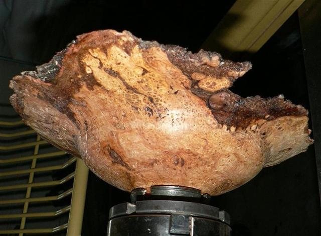

It is not done yet but I can't wait. I have to sand it, finish and part off. Hope I won't mess it up. Twice last night I almost lost this. It flew once (the tenon has bark inclusions and it broke off). I lost a lot of bark due to that mishap [B)]. It is being held together by an oz of crazy glue LOL.
This "small" cherry burl cap has been drying for a couple years now...very hard.
There! I am done with my mandatory new lathe project ;) LOL
Thanks for looking.

This is no picnic either. It is small (about 10") but the inclusions makes the wings resonate as it got thinner. I was bracing myself for a piece to fly anytime while turning.
I love natural edge but it is not for the faint of heart.

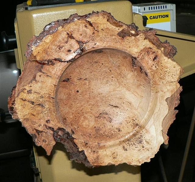

It is sanded, parted off and received the first coat of "Tung oil"
So far it is looking better and the color is much richer now.

Al, I should have taken a pic but forgot. It is just a burl cap about 10" x 2.75" thick. Final dimesions are 9.75" x 2" bowl. As you can tell, I was a miser but that nearly cost me this bowl. My tenon was basically the bark area and it separated at one point and the bowl flew away [:D]. You should have seen me...since it was almost done when it did. BTW, the natural edge of the cap became the bottom of this bowl and the cut area is the top.

My fault. There is enough tenon...problem is the tenon is mostly BARK. In my attempt to save as much wood I settled with it (big mistake). Ofcourse the first shock/catch caused most of it to crumble. After fixing it with CA, I went my merry way...the next catch totally peeled off the bark from the wood [B)][:I]...this is the one that launched the bowl. That was fixed with CA once again and everything went fine after that.
I am sharing these in hope that someone will learn from my errors and NOT to endorse my wrong procedure.
