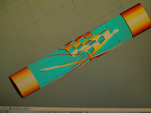

This is what I envision a Nascar pen would be. I mocked this up in under an hour. With a 1mm bit, this can be cut in 15 hrs. I can add more details too, like there is a space between the flag poles and the flag, and some flag seam lines to represent the folds better, but that requires a .3 mm bit to get into, so that would be a tool change and 24 hrs of machine time! I think it looks just fine without the extra details. It's a basic double checkered flag crossing over each other. It would have to be edited according to the pen it was to be used for, increasing or decreasing machine time according to how much depth is needed. I have this scheduled for a .094 deep cut level, .015 level passes, so that's like 7 passes with a bit. When you cut something like this and it's going to take more than 6 hrs, you need to make shallow passes because the bit can only handle deep cuts for so long before it breaks. Of course, that's an Aluminum cut schedule too. In plastic I could double the depth and speed, but the pen wouldn't be as cool as a metal one! Anyhow, here's a pic of my computer screen.
Technology is pretty cool huh?!?!

Yes it could, but you'd have to block all the flag holes, cast, spin, recast, or cast the holes with inlace one side at a time then cast blank. totally a possibility. I chucked up a piece of aluminum and am cutting one right now, barring any un-noticed bit break or machine crash I should have the raw blank by morning time. I went with a 3.75 inch long blank, 9.6 hole then step drilled a 9.7 hole in the back side so it will be perfect for a modified cigar pen, and be nice and light weight too! :biggrin:

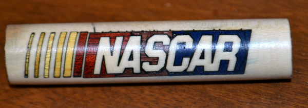

I had some left over pieces from another segmenting process so I thought I'd give this a try. Not perfect by any means, but good practice to try and get better at making inlay pens ;)

it's a good attempt, but it also gets you a law suit! :biggrin:
I can't afford the cost of their logo, I don't know how much it costs, but I know it's out of my price range. There's lots of options that can be done, you just have to be careful not to be close to their trademarks. Checkered flags are standard non copyright, it's a good option. A racing helmet or a generic race car would be great too.

I like where you took the logo to Jim. Even though it needs a bit of work in lining up the pieces, the idea of using different colors of wood to make the transition is excellent. The letters came out perfect. There's good idea's and inspiration in that pen, and I'm not just saying that to kiss your butt or something as I have no need to worry if you like me or not. It's talented work. sorry if you feel I was bashing you in any way.

Thanks Linda, it came off the machine this morning perfect. I am going to cast it today and maybe I'll have a pen the following day! :biggrin:
