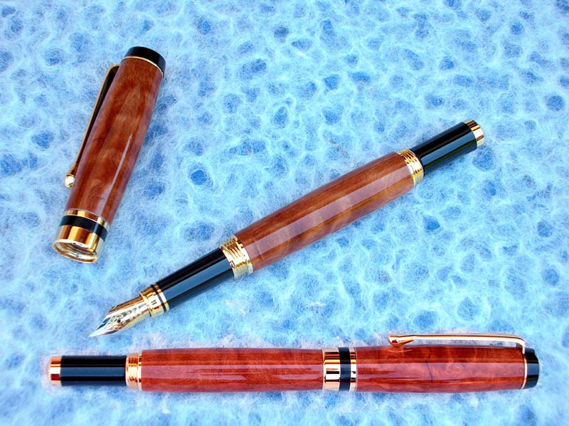

If you haven't looked in the Trades & Giveaways section here is a pen out of some wood that I have.
Finish is CA, the kit is a Flat Top Fountain from Rockler.
I can't tell you what it is... follow the link!!!
http://www.penturners.org/forum/topic.asp?TOPIC_ID=25737
Chris Nilluka
How in the world do you get that kind of shine from a CA finish? That shine is beautiful!
Originally posted by mtbrooks
<br />How in the world do you get that kind of shine from a CA finish? That shine is beautiful!
Ancient Chinese secret!!![;)]
no... seriously...
2 coats of CA. Sand with 400, use the complete series of Micro Mesh (up to 12000) then polish with 3M foam pad polishing glaze for dark colors. This can be found at most automotive refinish supply dealers. It's kind of spendy but it works better than corian polish, in my opinion.
