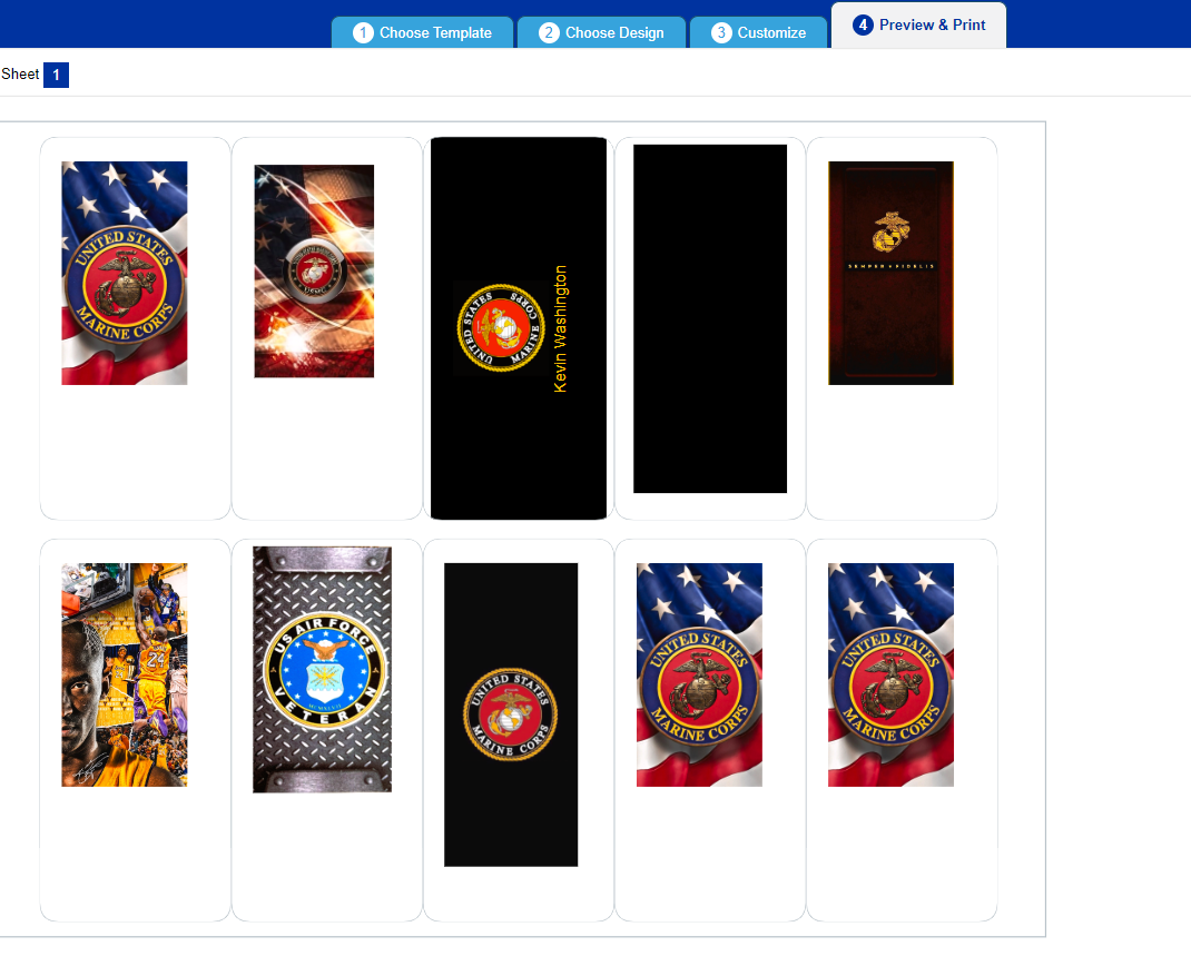

Actually, probably not, after looking into it. This rabbit hole appears to be too deep to reach the bottom so I'm taking a step back and rethinking what I want to do.

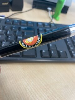

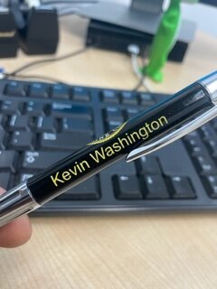

I received my pack of ten "sublimation pens" from Amazon yesterday. (It's cool living in Seattle where at 1 am I can order those pens and they are on my porch when I wake up in the morning!) After looking at them I have a better understanding of what is needed. Those tubes are smooth, white and coated by some mass production machine in Asia. I can't reproduce that. I bought a little open-box Canon SELPHY printer for $40 on eBay which was probably a waste of money for my purposes.
So, here's what I've done so far.

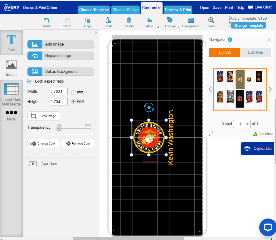

I already had some 2"x4" Avery brand address labels (#8163) so I started out with them. I also ordered different Avery label material types. Of the types I ordered these seemed to work the best. When printed they produced a nice, crisp, glossy label.
Using the Avery app for the #8163 2x4 address labels made the exact sizing and manipulation of these to within a hundredth of an inch a snap, so the wraps are perfectly sized at pi times the diameter of the tube which Alexa takes 2 seconds to tell me.
The sticker paper is just a full sheet so instead of putting the address labels in the printer I put the Sticker Paper sheet in and the app produces a pdf to print.
From there I simply cut them out and wrapped the tube. For the best results, the tube should be painted white.
The original rabbit hole goal was to be able to do a "clear cast" style pen. I haven't gotten to that stage yet but I'm thinking that I can either paint the bare tube glossy white and wrap it and then clear cast it or like in this first trial run I just painted the bare wood white and gave it a double coating of my GluBoost finish. I bought a pre-owned Underhill cast set-up from a member that arrived yesterday so getting that to work is the next step. This first test isn't ready for prime time but I can see a light at the end of the tunnel. I wanted vibrant, glossy graphics without breaking the bank and this technique seems to have potential and offer some interesting variations.
Don't know if this qualifies as a tutorial yet as the goal is to clear-cast but this is what I've done while gathering the tools, materials and skills to do that.
This also gives me another easy method of personalizing a pen or batch of pens with logos. Also, those "sublimation" pens from Amazoo are only $1.50 each so I'm good with harvesting the sleeve and tossing the guts. A 3/8" pen tube slides inside that smooth aluminum sleeve which is perfect and easy to wrap to be made into any of the popular pens using a 3/8" tube.
View attachment 348614View attachment 348615
Looking good. Now you see why I say the 3/8 tubed pens work well. I also think this method looks way better than any label cast I have seen.

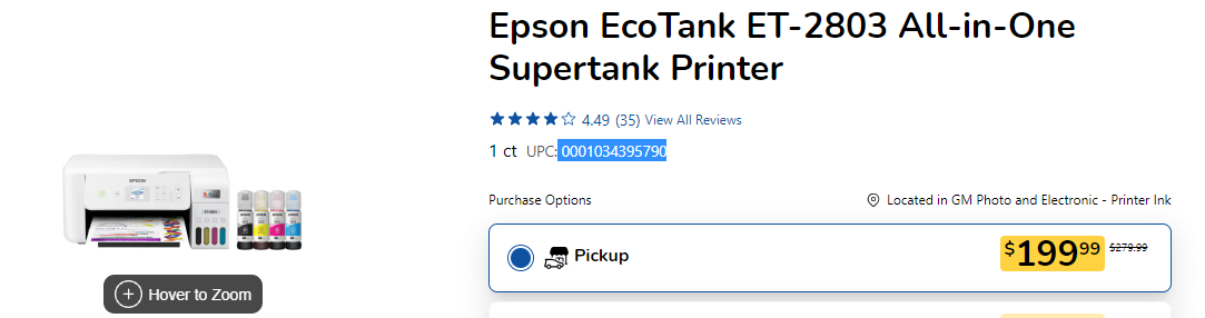

What printer do you use for sublimation? If I'm going to do it that little Canon is useless. Seems like you need a decent machine that you can swap out ink types. Using that Avery system wound be a snap if I could use the printer like a regular inkjet and just slide the paper in there.
So, gonna work on this method until I can make a decision on a printer. The taping and shrink wrapping seem pretty straightforward. Thanks for the advice.

I was lucky and the reason I even tried this, my wife does sublimation. She has an Epson EcoTank. One thing you need to know is you cannot switch back and forth between sublimation ink and regular ink. You pretty much need a new printer that has not had regular ink in it. At least that's my understanding.
Ah! The wife factor. That makes sense. That's kinda' what it looks like to me too. Can't see spending a bunch of $ but I can get an Epson EcoTank 2803 sublimation printer for $199 and Amazon will deliver the ink tomorrow for $19.
One little caveat is even though it is sublimation ink, you can still print on paper like a regular printer.
Good to know. Thanks. So I can use sublim. ink on the labels without heat, wrap the tubes and cast 'em?
