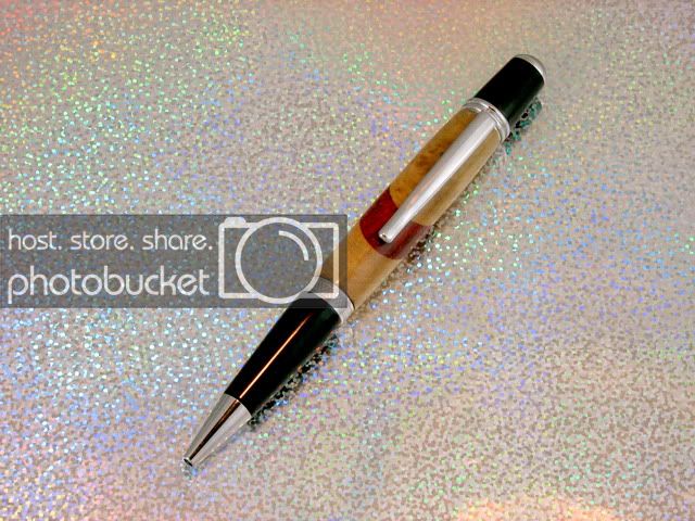

The test Pen I did with the ca/blo was a Sierra that I used a cut off piece of scrap laminated blank to build. That piece of blank was pretty rough (which was why it was in the scrap bag). I didn't start using the blo till the second coat.
The Sierra that i used for a comparison was done in a BOW and had 10 coats of thin ca applied, then water sanded through 1200 MM.
The photos aren't the best, but I think you'll be able to see the difference in the finishes (although it's not as apparent as seeing the two Pens up close and personal).
IMO, even if both the finishes looked the same, the ca/blo was faster to apply without all the sanding mess.
Sierra BOW w/10 coat ca finish
Sierra Laminate w/ca/blo finish

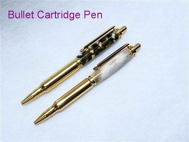

This Bullet Cartridge pen has the BLO/CA finish on the antler part.

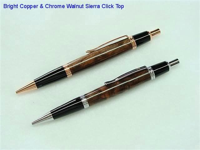

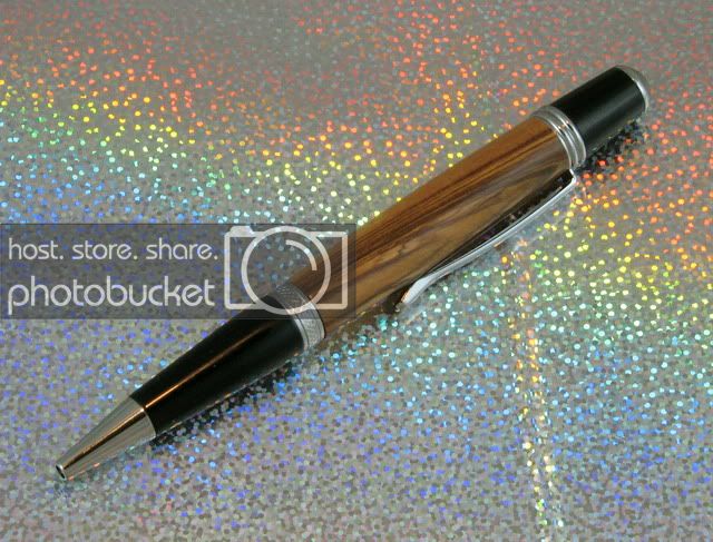

Here are a couple I did just yesterday with click top Sierra's in both copper and chrome on figured walnut.

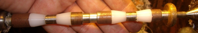

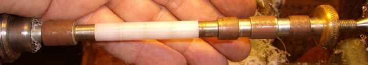

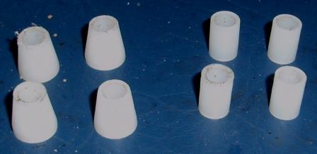

I have been using CA finishes for quite some time, being reluctant to mix oil and glue, as I was always worried it would delaminate in time. I guess time will tell, but there are certainly advantages of trying your technique.
As for the issue of sticking to bushes and wax etc, I use bushes I make from cutting boards for my finishing, eliminates the problem all together. It also avoids problems associated with various waxes/finishes reacting with metals.
Cheers

No problem with that drop of BLO with the CA . It's action is to cure the CA along with friction heat.
Great idea on the cutting board material. I don't have any problem whatsoever with CA sticking to bushings when applying a little wax on the ends but when I got my first order of these PSI Bullet Cartrige pen kits I forgot to order bushings for them.
So not to be beat and also to not wait for a separate order with more S/H , I made a set of bushings from corian . Bushings are very easy to make because all the pen kit assembly sheets give exact diameters of them both inside and out . All that is required is dial calipers .
They worked so well that when I ordered a bunch more of those kits I didn't even order the bushings then because the corian ones worked just fine.
With that said, I think the cutting board material woud be easier to turn than corian and I am curious what the cutting board material actually is. . ? ?
My wife might find a strip missing from her cutting board one day :biggrin:
Most of the "slickery" plastic cutting boards are going to be made of ultra-high density polyethelene (HDP or UHDP). You can get cheap cutting boards from discount stores, $1 stores, and in some cases you can get used one from resturants or butchers as they are using them up and must dispose of them. I'd suggest a quick bleach soak just to make sure kill the beasties stuck down in the cracks of a used board.
You can also buy HDP/UHDP various places like Peachtree Woodworking or McMaster-Carr.
Another term used to describe the same stuff is ultra-high molecular density polyethelene or UHMDP.
Another good material would be Delrin (that is the trademark name, I can't remember the generic chemical name right now) which is chemically related to Teflon but machines a bit easier. Again, you can buy small blocks from places like McMaster-Carr.

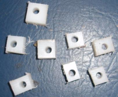

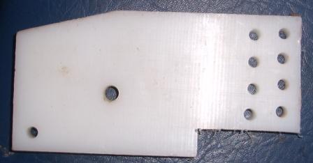

Neil, any chance you'd be willing to sell a few of those cutting board bushings? Or at least an Idiot's Guide to making them?
I'm in Australia, so not worth your while buying them from me, but they are easy to make.
Get a thick cutting board, drill holes to suit your mandrel (I use differently coloured boards for each different mandrel). Mount the the little squares on your your mandrel with bushes as spacers, then turn them to suit. Use very light cuts, especially at the start, as they tend to slip a bit. I use sleeves for my Slimlimes/Streamlines, cones for the other larger kits.
Hope this helps, sorry for the high-jack William :biggrin:
