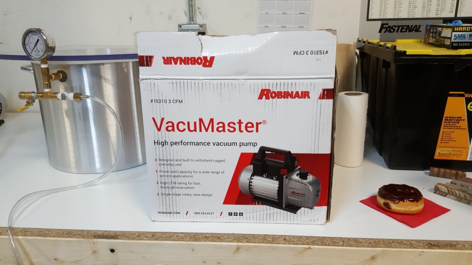

Started with a pump, this was the highest rated budget pump on the Turn Tex site (https://www.turntex.com/help-center/cactus-juice-stabilizing-resources/98-selecting-a-vacuum-pump):

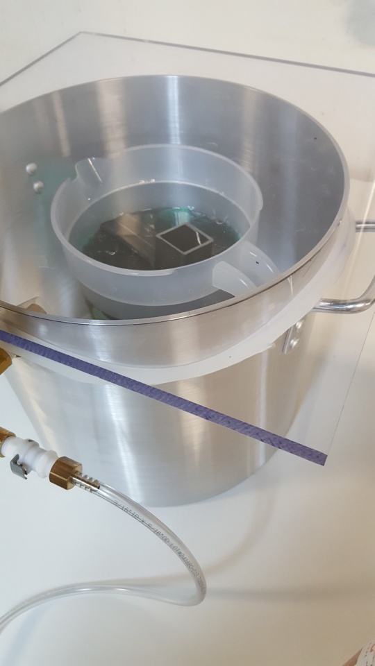

I needed a lid and tried polycarbonate - the 1/2" thick stuff started cracking the first time I used it. Curtis warned me that a thicker lid would be better, but I listened to a local expert and wasted $43. Not a total loss, cut it down, drilled holes in it, and used it to keep the wood weighed down - a 5 pound weight on top it works pretty well.

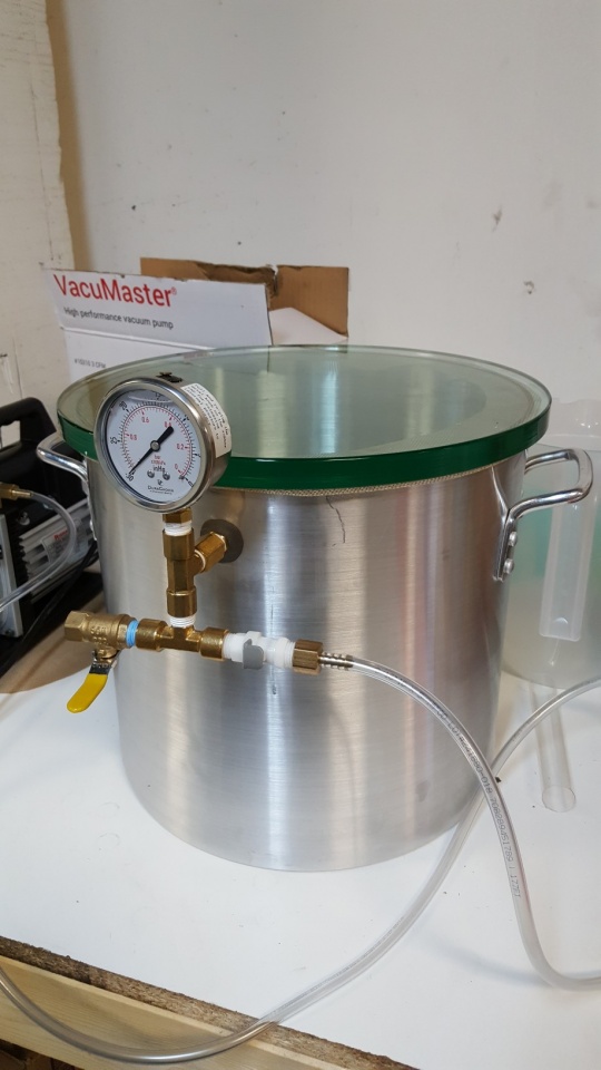

3/4" tempered glass works much better.

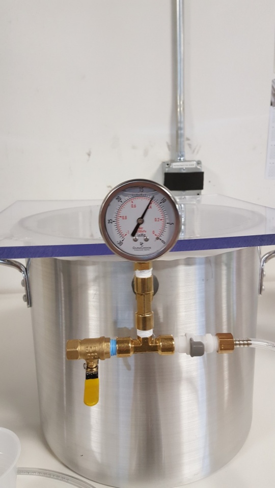

Got the tubing, gauge and valve kit from Turn Tex (Curtis). Drilled in the side of the pot to attach the hardware, rather than drilling the lid. JB Weld seals the hardware really well. Used a silicone baking sheet for the lid gasket.

I have and use that exact vacuum pump and it works great. I've had zero problems with it so far. The only thing I would suggest is that you watch the pump oil level, and it might get cloudy if your wood is not very dry. I change my clear oil after stabilizing wood 2 times. If it gets cloudy then I change it after the run every time.
