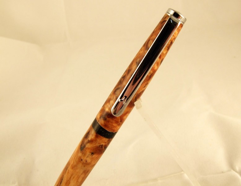

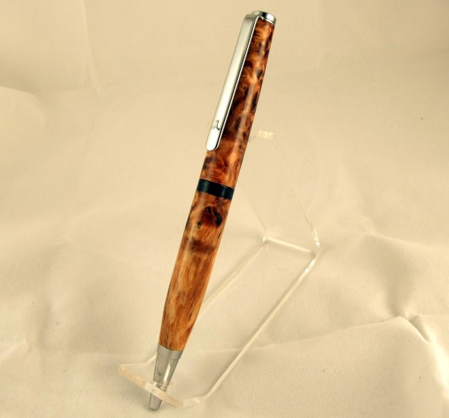

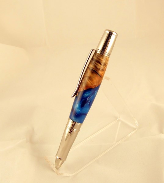

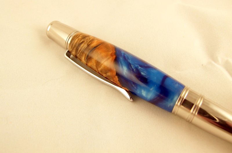

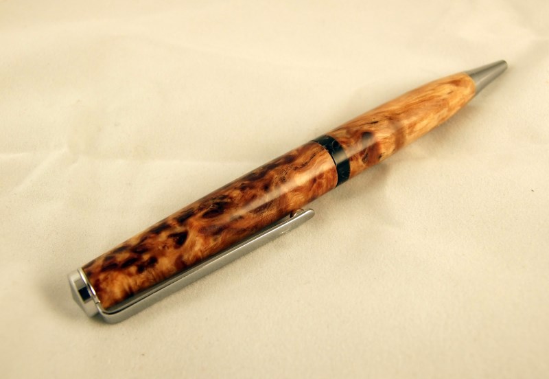

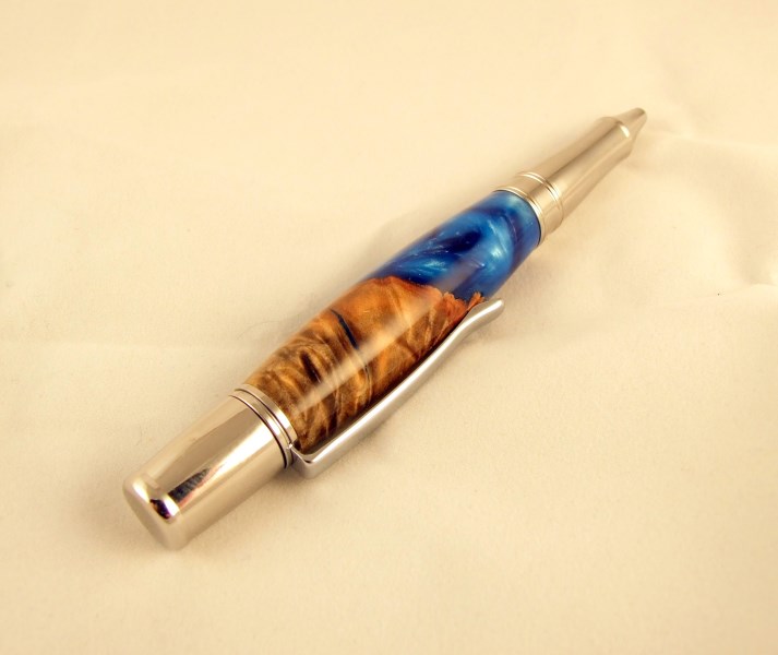

Here are my two bash entries:
1. Beginner's contest: "worthless wood" on Liberty from lazerlinez.com
2. Russ Fairfield slimline Memorial: Burl with Spanish moss Brooks blank for centerband fatline.
Both CA finish. I'm looking for honest feedback, I'm very proud of them and thick skinned but looking to continue to improve so straightforward feedback is very welcome.
Thanks!

I'll speak to the Russ Fairfield pen. I suspect that your photos did not show your pen at it's best.
The color of your background wasn't optimal for your pen material. Additionally it looked like there may have been color balance issues with the photos. I think a darker backgound (dk grey or black) would have nicely contrasted with the pen and really brought out the colors of the material.
To me, your second photo (shot from the clip end with the pen laying on its side) made the clip end of the pen look over sized and unbalanced. It doesn't look that way in the other pictures to me. Perspective is important when staging photos. If you want to show a particular detail at one end of the pen, consider showing only that part of the pen.
All I've talked about is the photos, when it was a pen contest and not a photo contest. Unfortunately all anybody sees is the photos. While the photos aren't the focus of the competition, they have to show your pen at it's best. The photo has to catch the viewers eye to get them to put it on their short list where they then evaluate other details to make their choice.
Of course, all this is just my opinion. That doesn't make it so.

Ed gave you some good points on the photos which is a big factor since we can't see the pens in person. Both pens look very nice and would bring top dollar. The beginner contest had unusually strong competition. I especially like the fatline.
Harry

Shoot... I agree with Ed.
The pictures may possibly be better, but I have no substantial comments on the pens - They both look very nice! I suspect they are very impressive in person.
Photography... Ah yes, just what we wanted to learn when we picked up a gouge.
Be proud of the pens!

Photo #3 If you look at the Centre band, you can see what appears to be marks on the Black Surface, and a little "daggey" thing on the edge of the cap. (Could be a glob of glue or polish)
I don't know if the marks are scratch type of just finger/handling marks.
For a competition of highly polished items, I suggest that to use white cotton gloves would be worthwhile.
If you don't wear gloves, regardless of how careful you are you will leave marks on the surface.
In photo #4 in the reflection zone of the Finial you can see either finger marks or reflection of the photographer, or the room. This also distracts from the visual image you are presenting.
Try to position the tent, so that no image can be reflected on the object.
