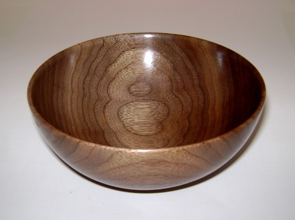

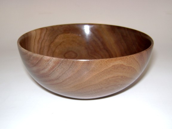

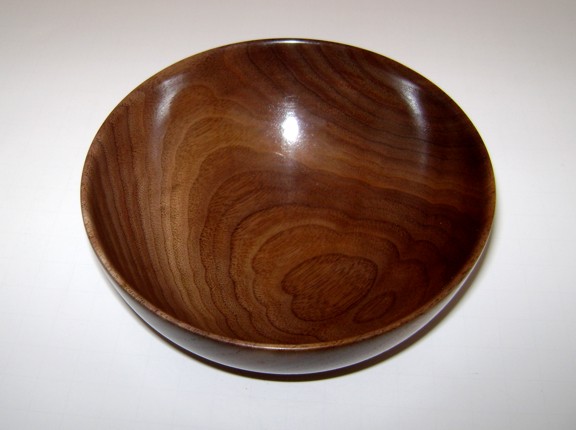

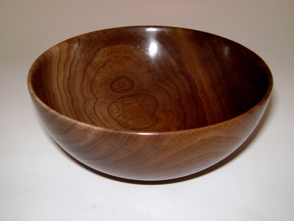

Walnut Bowl I worked on today. 5.5" x 2.25" Thickness is less than 1/8"
2 Coats of Clear blond shellac and some wax.
I didn't blow it out ... whew. :)

You are right, that is the thinnest walnut bowl I have ever seen. So thin, I can't see it :biggrin:

Wow, Grizz, that is an exceptional piece of wood you have there. I really like Walnut myself. Excellent work, thanks for posting it. It looks like you got quite a shine out of that finish too.

WOW, nice wood!!!
The grain in the third one seems to run from one side to the other--great choice of camera angle!!!
Well done, all the way around.

Yeah, good execution, simple shape but effective.
The wood is certainly beautiful and the grain/colours did come up very well the way it was finished.
One of the worth enemies of thin wall bowls/vessels, etc, is the outside diameter of the piece, the wider the circle the more vibration/wobble will affect the outer edges of the piece to the point that if rotating too fast, it will simple disintegrate/explode...!:eek:
The 5.5" diameter is a very safe size for these thin wall items but I would suggest caution at the lathe speed on anything under 5mm, over the 7 to 8" diameter. Off-course, the type of wood used will determine its success or failure, some woods will allow a 3mm wall thickness up to the sizes I suggested if lathe speeds aren't extreme...!

Excellent form and execution. No hint of tool marks, bruising or tearout!

That's one jim dandy looking bowl.... I was working on one earlier this week that would have, could have, should have, been similar... one teensy weensy, tiny little bitty catch turned it into an exploding mass of wood shrapnel, some of which I think went into the rafters and is lodged in some of the stuff stored up there.... You did really good.... love the looks of a well turned walnut bowl. :good::good::good::good:

Jon, you have my undying admiration! That is one magnificent bowl. Someday I hope to just turn a bowl, of any kind and any thickness. That is gorgeous. Thanks for showing.
