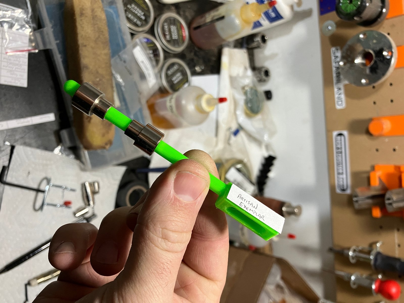

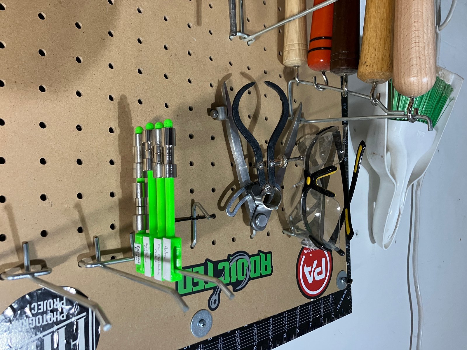

I've been using a simple Flambeau compartment box to store my bushings, but it was getting over-full, and with a recent push to utilize wall/pegboard storage more so I have fewer things cluttering up my small workbench and limited shelf space in the garage, I wanted to rethink that approach.
I saw things like this Bushing Buddy from PSI, but it just felt extremely inefficient on space, and rather expensive for what it is, to boot. The idea of hanging them stuck with me though.

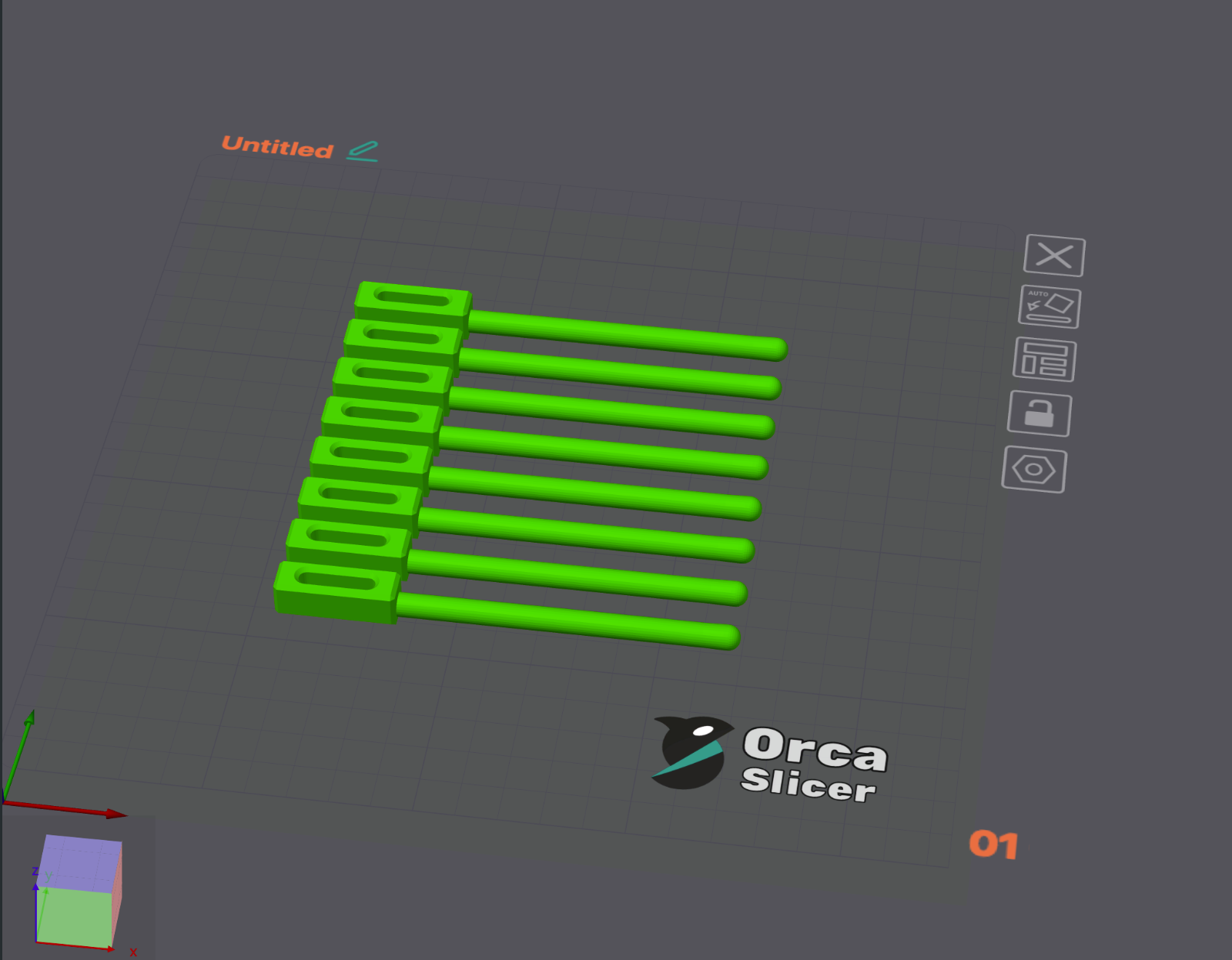

So after a little bit of prototyping the model, and maybe 3-4 iterations of getting the tolerances just right, I just printed about 30 of these, and will be moving all of my bushings to the pegboard where they're up and out of the way, but easily accessible. I print these from standard 95A TPU with 3 perimeters and 0% infill. The idea is that the very end is slightly bulbous, easy to push a bushing over it or pull it back off, but tight enough that I can't get it to shake loose even when I try. It's long enough to hold even 4-bushing sets, and it hangs easily on standard pegboard hooks, with space to glue on a label if you want.
And since I pay $20 USD for a 1kg spool of this TPU, each one of these little bushing holders costs me a whopping $0.06 :)
Forgive the second picture of them hanging on my pegboard that the forum decided to flip upside down for some reason.
