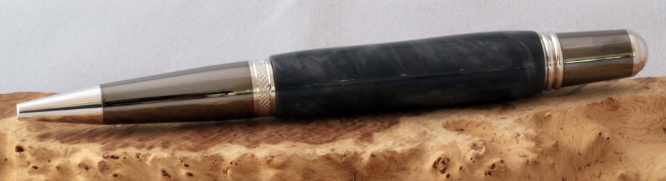

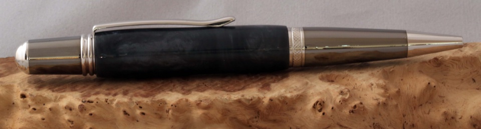

I taught my son today, and he turned and finished his first pen. I am so proud of him. Let's encourage him friends. Please put your feedback, so he can see it, and improve and be encouraged. Its also the first resin blank that he has turned, also one of the first blanks that we made together using PR!! Its a sierra rollerball finished with CA (which he did). It is our 3rd attempt at making our own blank. The first was just ok, second was better but we like this a lot with opaque pigments and pearlex. We are just making these blanks for ourselves and no intention to sell.
We are desperately trying to find out when should we mix in the pearl ex in order to get good swirl effects?
Any gurus out there?

That is a great first effort! Stash that pen and don't sell or give it away. In a year or two make another pen and take a look to see how far you and your son have come.

As for when to pour your resin I work on a "try it and see" method! I have been pouring my own blanks for about 12 months and have had mostly good results but also the occasional one that is hidden in the back of the cupboard. I have only tried once to delay pouring until the resin got "tacky' to get a better swirl effect but ended up with 2 cups full of set resin so now pour pretty much as soon as I have everything mixed. I then give it a light swirl with a thin wire once it is poured to mix the colours but not blend them too much.
Hope this helps and again awesome job with the first pen young fella!:biggrin:

I know good work when I see it. That pen looks great. Nice fit. Good color. That is a pen to be proud of by anyone.
Keep up the good work and show us more soon.

Very good first effort. I like the blank and the finish. I would encourage him to work on a closer fit to the components, it looks a good bit proud of the fittings on each end. If he is nervous about turning that close to the bushings then more time with the 150 grit. Still the pen looks really good and can't wait to see his next one.
He did a good job! I think the color of the blank really goes well with the plating.
