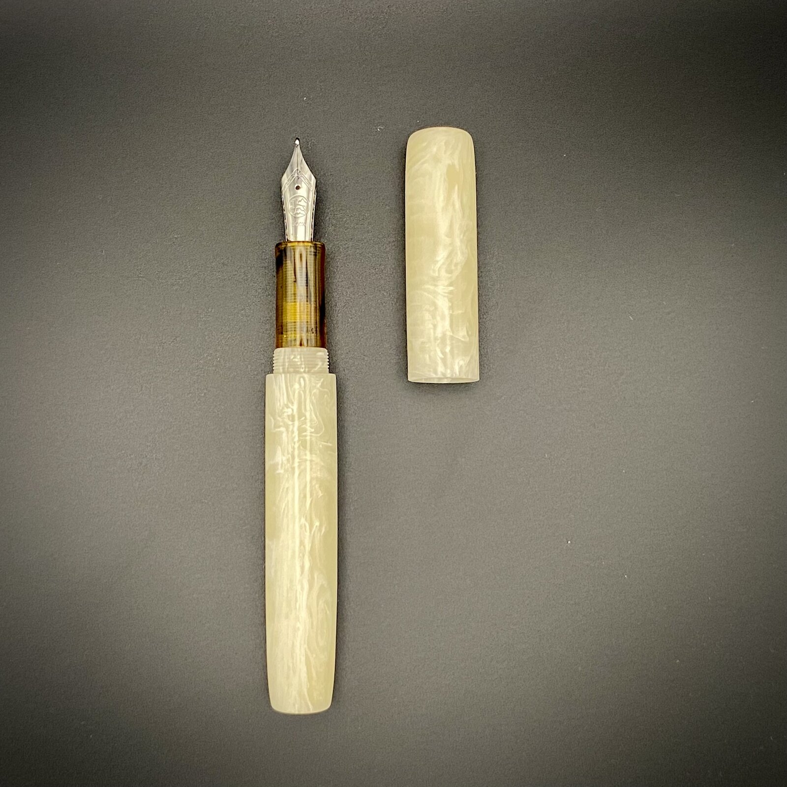

Hi everybody!
Since I have a little free time, I would like to dedicate my next 8-9 days to improving my pen-making skills. This is my 2nd kitless pen and it is way better than the first one. I have used an acrylic rod from German tobacco pipe manufacturer (pfeifenecke.de) and I love it. Currently I am not able to add clips and other details like brass ring etc. but I will give it a shot later on.
In this pen, you see a Bock 250 nib. The Pen blank is finished with 3M Zona sandpaper and Yorkshire Grit Abrasive Paste (Fine).
Very well done.
Excellent artistry. I love the material.

Hi everybody!
Very subtle elegance. Beautiful work.

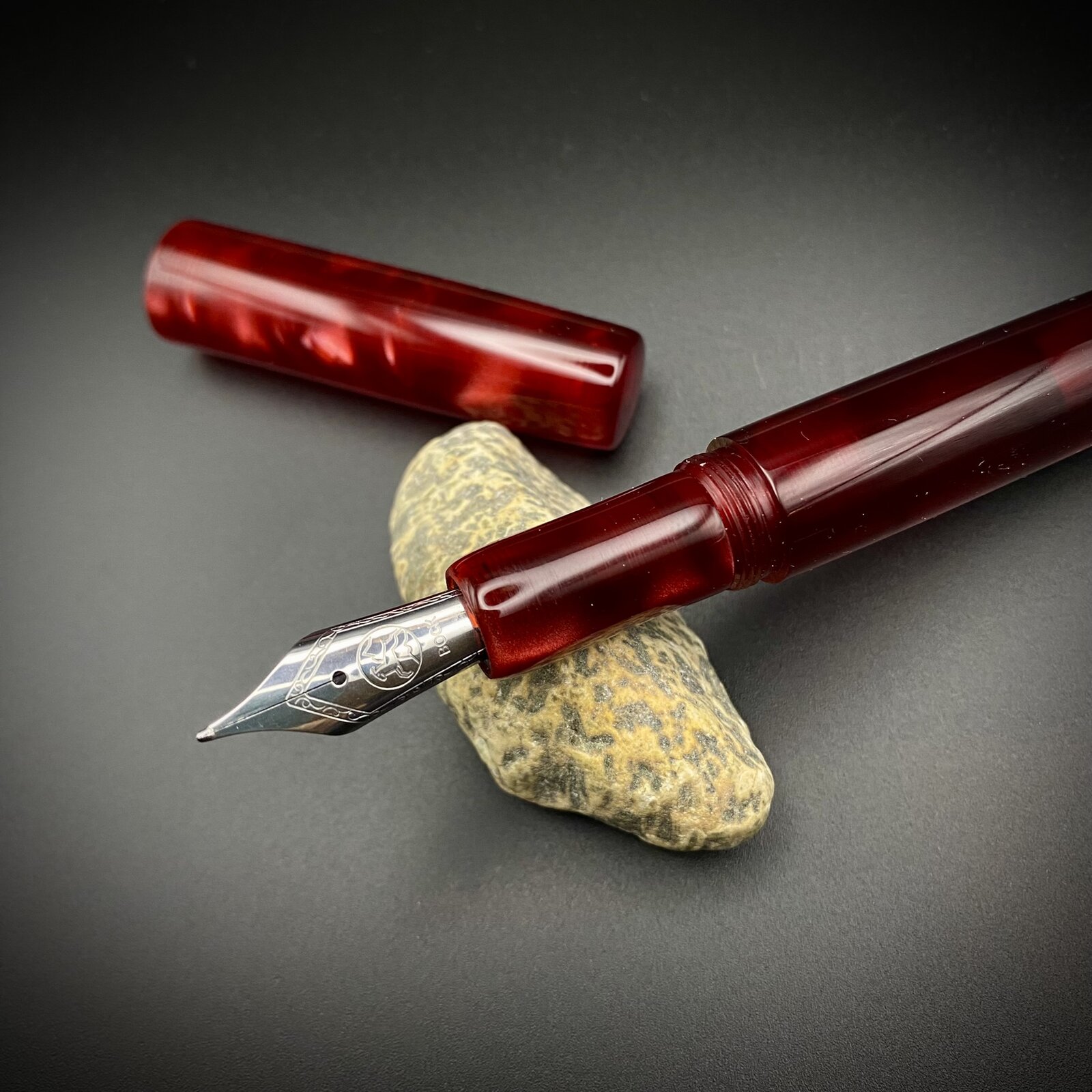

Thank you folks for the nice words! I do love that blank either.
I think, I will try an ebonite blank next week. I have never turned one, curious about it. Not sure but I may leave the surface rough and apply black urushi afterwards. But first, I have to turn the blank into a pen 🙃
That's very nice! If you managed making the section, adding rings and finials would be easy, trust me! You may want trying different ideas on a cheap piece of POM (delrin) or similar, until you'll be happy with your skills, design, size etc. (another benefit will be that you'll have the proper mandrels for fixing the pen parts for different stages of fine shaping or finishing, mandrels are useful anyway). Speaking about single vs multiple starts threads, this is just your choice and (later, probably) your client demand, when you'll afford letting him to ask for specific design. That's the same with the clip. I, personally, don't believe anymore in classic clips, as I don't think there are too many people hanging their pens in their inside pockets, so I mainly make clipless pens, but I always add a roll stopper with some significance for the pen. So, on short, first do whatever you are happy with, when your clients will dictate you how and what to do, will be another experience.

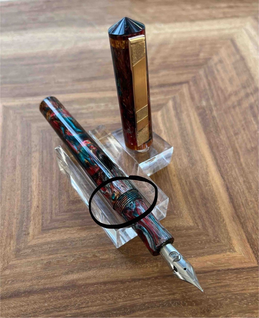

Your design is well executed. My only caveat, would be the large step near the section. In my experience, that is a turn off for many pen enthusiasts.

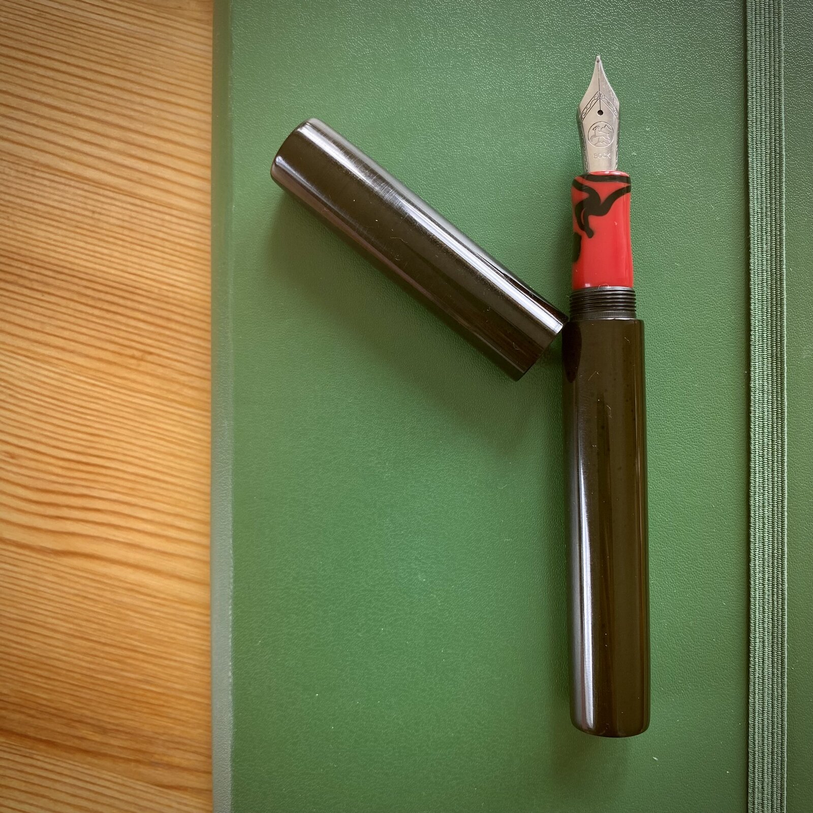

This time I gave a shot for an ebonite blank. It smells very bad (it reminds me of days when I was working at a shipyard rubber department) and I find it hard to polish the material. Maybe the reason is the manufacturer because there were two types of ebonite and I selected inexpensive one. I can say that no one would like to write with any pen with any kind of that odor. When turning and sanding in garage, I opened the garage door for good ventilation. By the way, the section is made with acrylic to add a style.
Another thing I realized with ebony, the nature of the material is that it picks up an electric charge very quickly with a few frictions and therefore always remains dusty. Never thought about that as an engineer :)

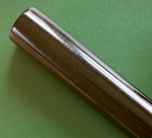

Here you can see some scratches on the cap.

And this is my stinky pen :) Probably I will request for the return the rest of the ebonites :)
Ebonite smells that way, it's totally normal. Ebonite is made of vulcanized rubber, this means a high sulfur content…thus the smell. Ebonite is a very traditional fountain pen material.

Could you please elaborate on the phrase "the large step near the section"? I just couldn't figure it out.

The step that is just behind the cap threads. In my experience most people don't like the feel of the sharp step. While this can allow a flush cap and body, which may be the priority, you can find a compromise that fits your style.
This is my Lewis model. The cap is a 15mm dia, to the body's 14mm, with 13mm tripple threads. For me, this has worked to a good combination.

Beautiful pens! I got your point. To be honest, I was vaguely uncomfortable about it from the beginning, because when I tried to write it myself, this area would get caught in my hand, and yes, it's not a nice feeling. My first two pens' body diameter is about 15.6mm just before the threads and I am using 13mm thread. So there is an 1.3mm thickness difference transition at that point. This difference is 0.5mm at your pens.

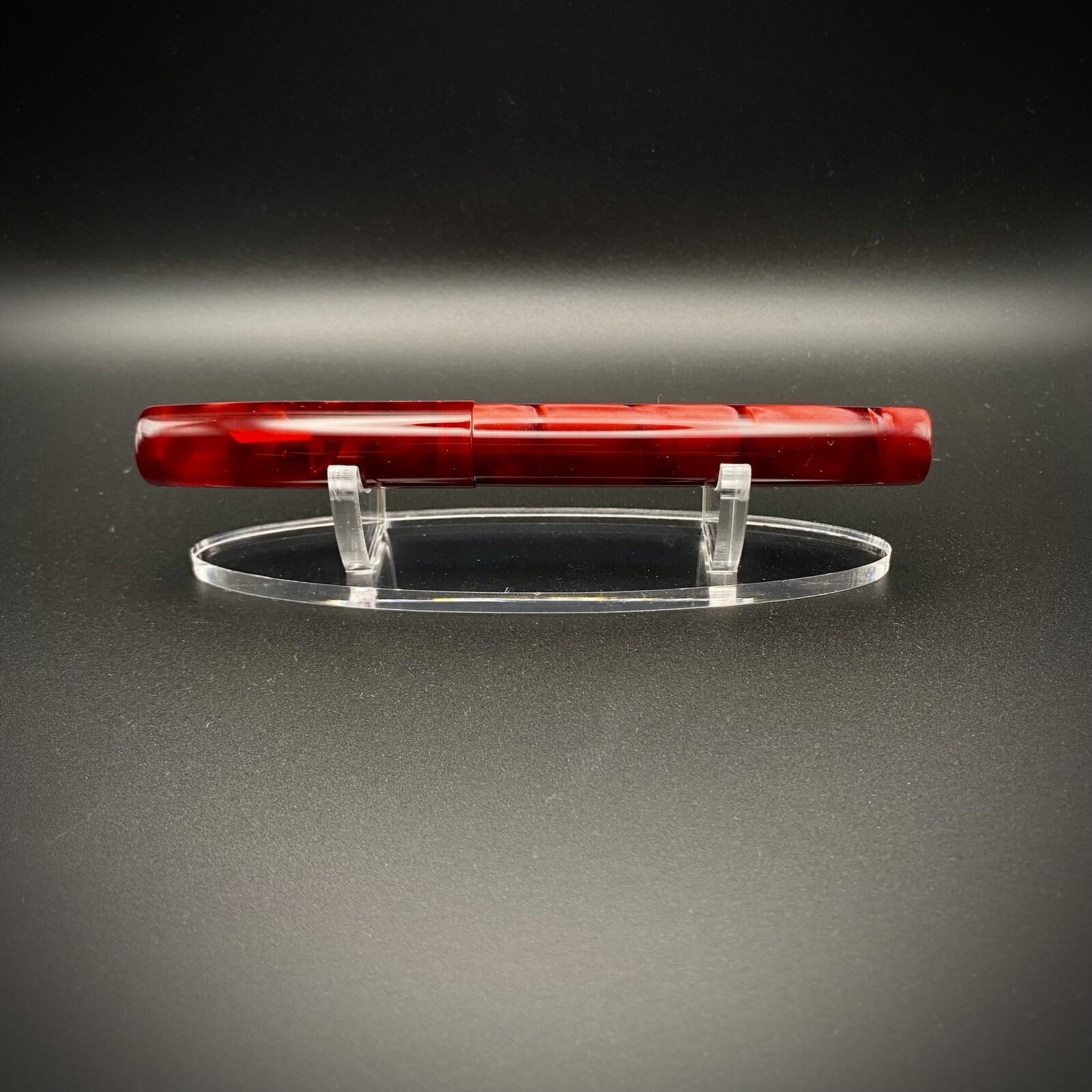

Before this pen, I sharpened my carbide tips and, I believe they paid well. According to the recent two pens, the surface is way smoother. I can say that I made it much more slowly and carefully. I tried to keep the step between the body and the section narrower, so the pen became generally thinner. The body diameter is about 14.5mm and the cap is about 15.3mm.
